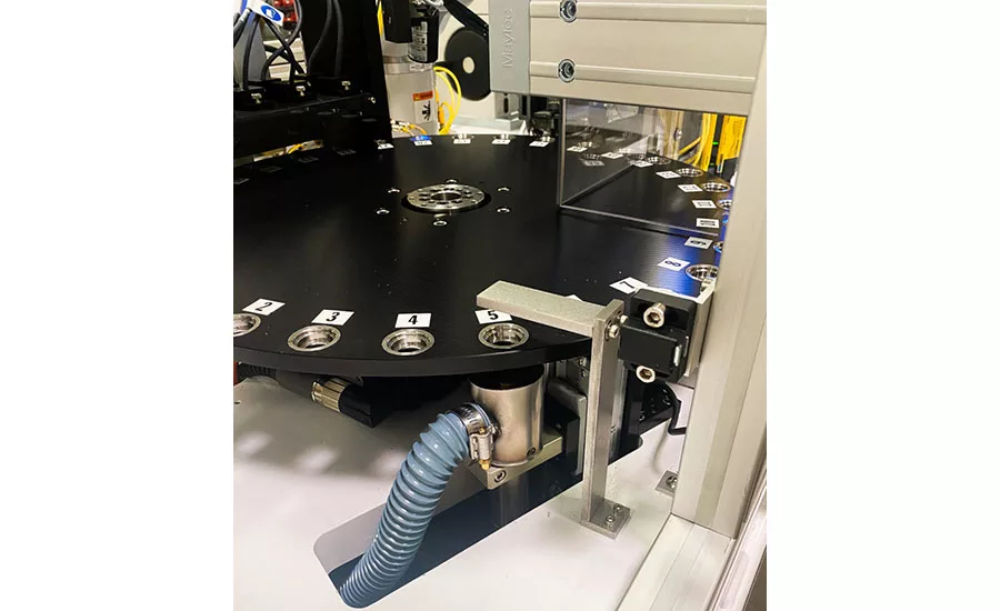

robotic assembly
A robot picks a needle from a drum feeder and inserts it into a ratchet. Photo courtesy Summit Engineered Automation Inc.

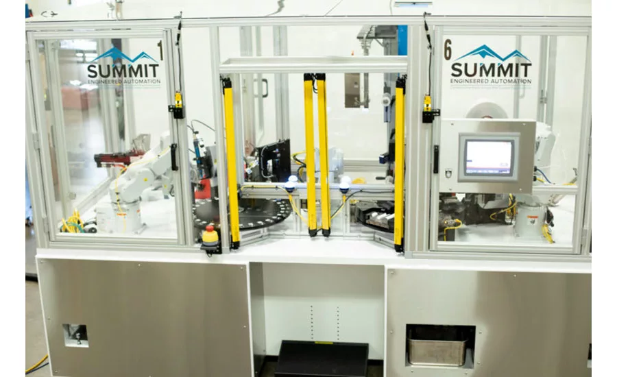

medical device assembly
Summit built a system in which three six-axis robots are integrated with a pair of servo-driven rotary indexing tables to assemble a medical device. Photo courtesy Summit Engineered Automation Inc.

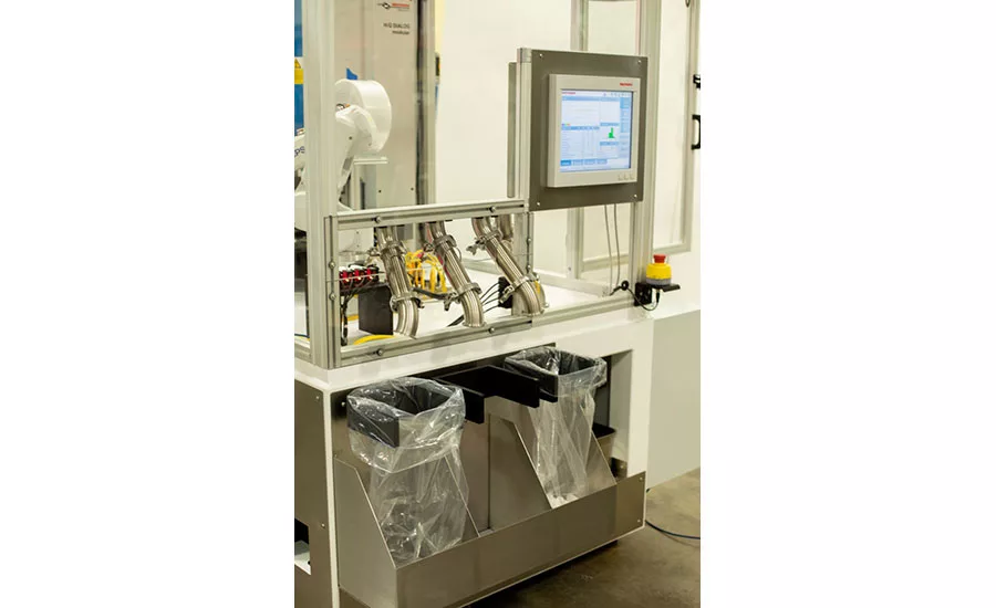

robotic assembly
At the end of the line, a robot separates good products from bad ones based on upstream test results. Photo courtesy Summit Engineered Automation Inc.

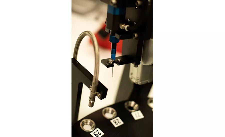

force and pressure testing
The finished assembly then undergoes force and pressure testing. Photo courtesy Summit Engineered Automation Inc.

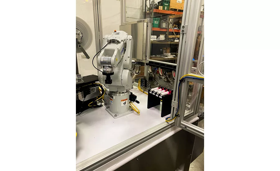

robotic assembly
Summit built a system in which three Epson six-axis robots are integrated with a pair of servo-driven rotary indexing tables to assemble, weld, inspect and unload the product. Photo courtesy Summit Engineered Automation Inc.

Ultimately, Summit built a system in which three Epson six-axis robots are integrated with a pair of servo-driven rotary indexing tables to assemble, weld, inspect and unload the product.
An operator independently loads both dial tables from the front of the machine. The assembly process begins on the left-hand table. At the first station, the parts are given a plasma treatment to promote adhesion. Next, an Epson C4 robot picks a needle from a drum feeder and inserts it into a ratchet. The table then indexes the parts to stations where a UV-cure adhesive is dispensed and cured. A Keyence CVX vision system inspects the quality of the adhesive bonds.
Next, a center robot removes the part from the left table and assembles it into the parts on the right-hand table. The parts are then indexed forward for assembly by a servo-driven ultrasonic welder from Herrmann Ultrasonics. The finished assembly then undergoes force and pressure testing through an Ethernet/IP equipped leak tester from Z-axis. The third robot unloads the assemblies, separating good products from bad ones based on upstream test results.
Using six-axis robots for material handling enabled Summit engineers to place a multitude of process steps into a compact and efficient footprint. The flexibility granted through robotic part handling and servo-driven rotary tables also allows the machine to run verified good and not-good assemblies in reverse to verify the test results.
