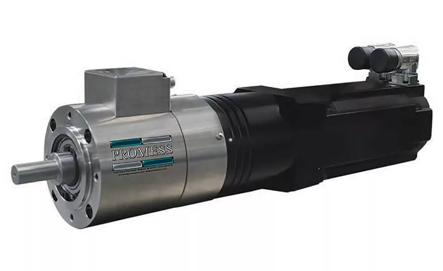

Any assembly that turns, rotates or pivots—gearboxes, bearings, levers, reclining mechanisms—is typically tested to ensure that it works as intended. For example, the hinges supporting an oven door must be assembled so that the door is easy to open but doesn’t flop down when released.
Engineers will want to confirm that it performs as expected. That’s where a device like the TorquePRO motorized torque assembly and test system from Promess Inc. comes into play.
The device has the ability to both control and monitor torque and angle in real time through a closed-loop feedback system. Ten standard units are available for maximum torques ranging from 5 to 10,000 newton-meters. Built-in mechanical overload protection makes it virtually impossible to damage the torque transducer through unexpected torque spikes.
The device can test rotating assemblies in several ways. For example, for a gearbox, the device can spin the input shaft while the output shaft is not connected to anything. As it turns the shaft, it measures the torque. This tells engineers how much drag is present inside the gearbox. A perfectly assembled gearbox should have a minimal internal drag. If parts are binding, the TorquePRO will detect that. If the torque is less than expected, it could indicate that parts are too loose.
Next, the test can be repeated with a known drag on the output shaft. If, for example, engineers create 1 newton-meter of resistance on the output shaft, and the device measures 1.2 newton-meters of torque on the input shaft, that could indicate a 20 percent loss within the gearbox, depending on the gear ratio.
Lastly, the device can measure how much lash exists in both the positive and negative directions. If the box has too much lash, it tends to be noisy. If there’s not enough lash, it tends to be inefficient.

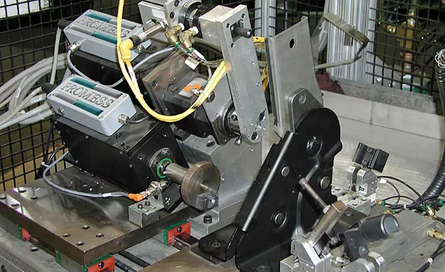

An auto parts assembler uses the TorquePRO to verify that seat recliner mechanisms meet functional and safety requirements. The TorquePRO measures torque, rotation, angle, return spring force, latch and unlatch effort, tooth engagement and tooth backlash.
Specifically, the system:
  • Measures the force to move a component through a given range of travel.
  • Detects abnormal force at any point along the range of travel. For example, excessive force identified at the same measured point on each mechanism may be the result of a poorly assembled or out-of-specification part (e.g. misaligned stamping, over-staked or under-staked rivet(s), oversized or undersized pivot pin(s), incorrect spring force, etc.).
  • Verifies proof load in both directions according to Federal Motor Vehicle Safety Standards.
  • Measures the travel range from full reclined to fully raised.
  • Measures movement when a calculated bidirectional force is applied to a component in the locked position.
  • Verifies the presence of the return spring and latch spring.
  • Records and archives statistical data on all functional tests for process control and traceability.

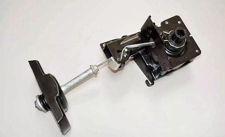

Another automotive manufacturer uses the TorquePRO to perform functional testing on a spare tire carrier for trucks and vans. The carrier is used to lift, lower and hold the spare tire on the vehicle. In this application, the torque on the lift mechanism is measured to determine if the assembly is within specifications.
The TorquePRO was used because it can do both the motion control and the force and torque monitoring for the entire testing process. The process starts with the TorquePRO winding up the cable until the torque reaches 20 newton-meters. At this point, the tire support on the end of the cable comes in contact with a fixed stop on the machine. The TorquePRO then rotates an additional three revolutions, measuring the torque. The system then retrieves and gauges the peak torque. If the peak torque exceeds process limits, the system fails the part.
The system also monitors an external load cell mounted within the fixture of the machine. The load cell is used to measure a characteristic called tire squash and indicates that there is tension applied to the carrier cable. From the data acquired from the load cell, the peak force is measured and gauged. The torque and the force values are stored after every test into a data file for process analysis and traceability.
