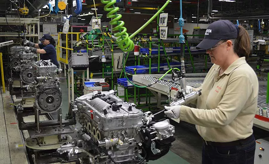

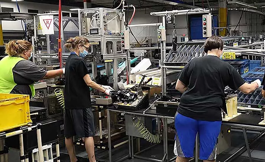

Line balancing is an important part of lean manufacturing initiatives, because imbalance creates waste.
“Imbalance will create a lot of work in process (WIP) and idle operators,” warns Drew Locher, managing director of Change Management Associates. “Line balancing is part of heijunka, which is the art of leveling production. This enables production to efficiently meet customer demands while avoiding batching. It results in minimum inventories, capital costs, manpower and production lead time through the whole value stream.
“Whenever demand varies, you have to rebalance,” says Locher. “That’s especially true in any type of build-to-order environment. Some lines need to be rebalanced every shift. For instance, this is quite common in the door and window manufacturing industry.”
“When team members eliminate waste in their processes through kaizens, the result we get is several processes with spots of idle time in each of them,” notes Sammy Obara, president of the Honsha Group. “Team members tend to either fill that time with non-value added work or slow the pace of their cycle time.
“Through line balancing, it is possible to actualize the gains into the bottom line,” explains Obara, who spent three years studying lean manufacturing principles in Toyota City, Japan, and another 10 years applying it at Toyota assembly plants in Brazil, Venezuela and the United States. “You actualize gains by redeploying people toward other value-added activities, to solve problems, to do kaizens, or to replace individuals who retired or left the company.
“If you don’t balance the line and leave all team members working with their increasingly amounts of idle time, you will have a line running at the same cost, but with less working content,” claims Obara. “One common practice in lean is the elimination of waste in all processes, constantly, which creates idle time across processes. Leadership must actualize those individual gains.”

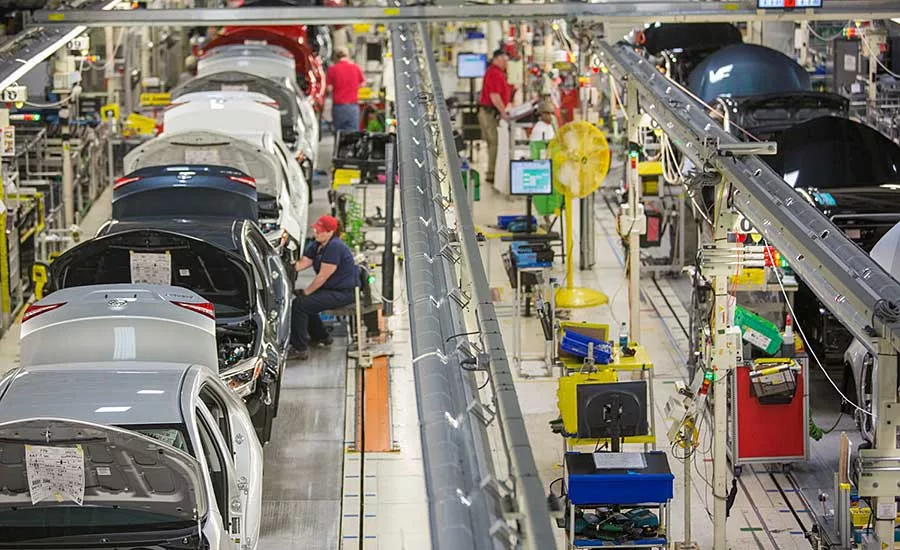

One of the biggest line balancing mistakes that engineers make is not accounting for enough flexibility.
“Manufacturing lines need to be designed in such a way as to allow for this practice to occur,” says Smalley. “There needs to be some flexibility in the equipment, layout, material presentation and operator work space to allow for different levels of staffing to occur.”
“It’s important to build in flexibility,” adds Locher. “You should be able to accommodate for line stoppages and disturbances. And, you also have to design to the slowest process step, accounting for variation in people, parts and processes.
“When you have a lot of product variation, you need to buffer for it in your line design,” explains Locher. “That’s why low-mix, high-volume assembly lines tend to be easier to balance than high-mix, low-volume lines.

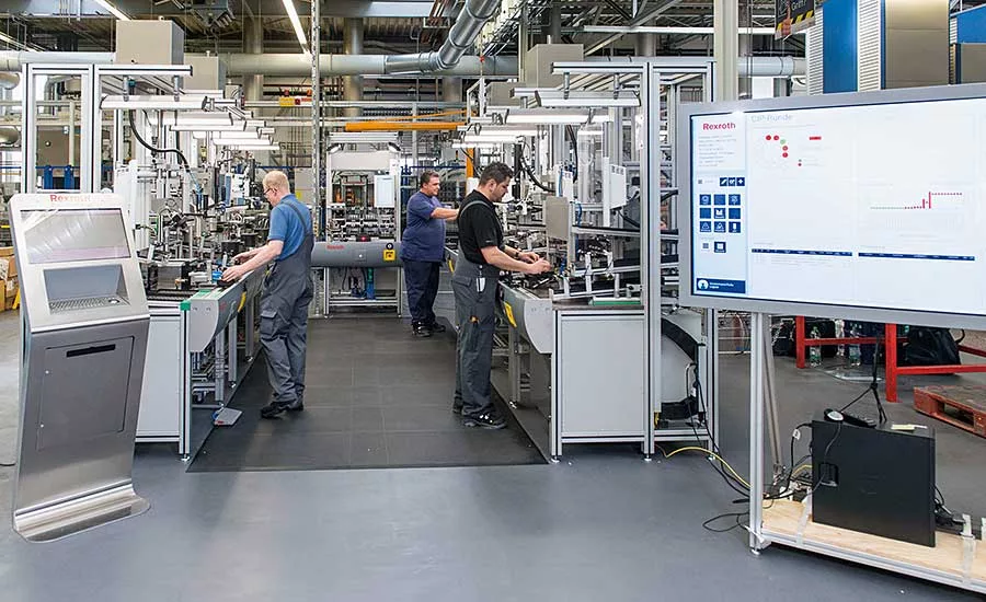

“Typically, U-shaped cells give you the most flexibility,” says Locher. “They enable the same operator to move around and do both the first step and the last step in the line. But, it’s not always practical. It often depends on the type of product being assembled, plus the size and configuration of production equipment.”
Strategos’ Lee believes manufacturing engineers should also consider creating more assembly cells. “Smaller, more focused lines or multiple assembly workcells often provide better results [than traditional assembly lines],” he points out. “Cells and smaller lines also reduce demand variation, and reduce both finished goods and WIP inventory.
“Line balancing is more difficult with long, linear lines commonly used in automotive and appliance assembly,” notes Lee. “Workcells make it easier to self-balance, because operators can easily move around and help each other out.”
