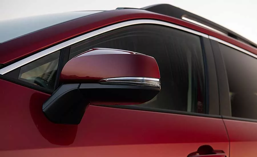

The Toyota RAV4 is one of many vehicles that feature side-view mirrors produced at the 2020 Assembly Plant of the Year. Photo courtesy Toyota Motor Corp.

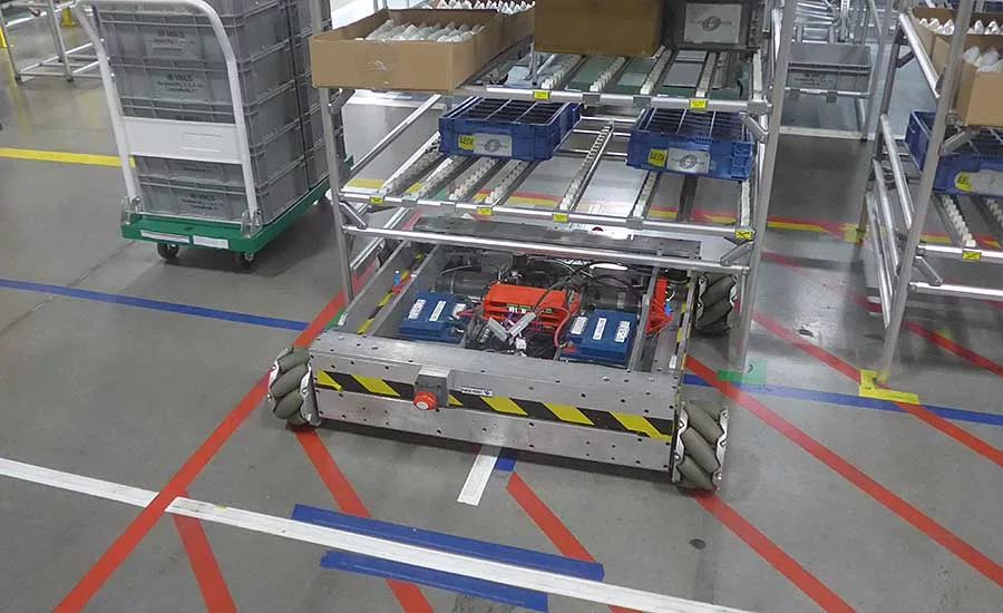

In-house developed AGVs have improved productivity and saved Murakami thousands of dollars. Photo by Austin Weber

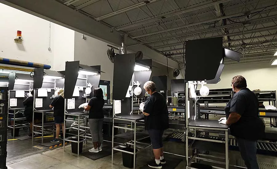

Three assembly lines in the service department produce spare parts and support older vehicle models. Photo courtesy Murakami Manufacturing USA Inc.

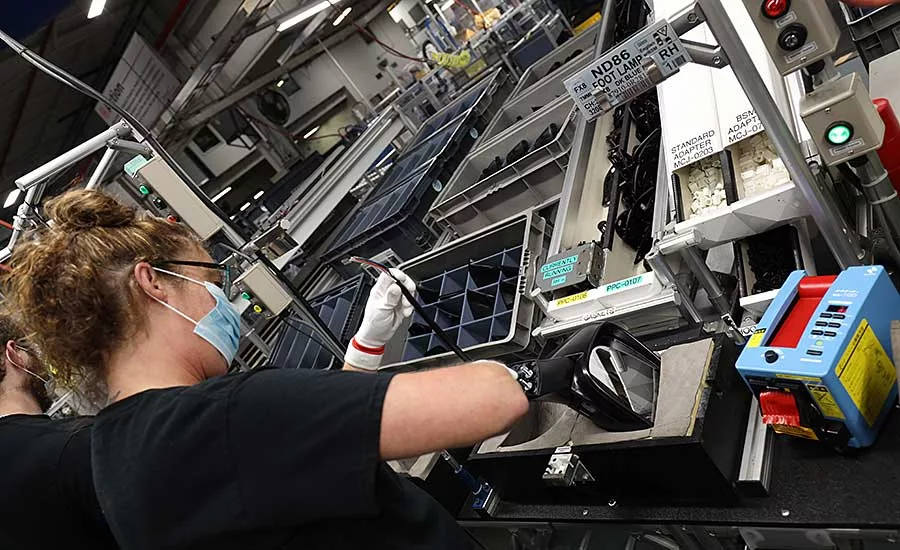

Assemblers carefully install wiring harnesses and other electrical components. Photo courtesy Murakami Manufacturing USA Inc.

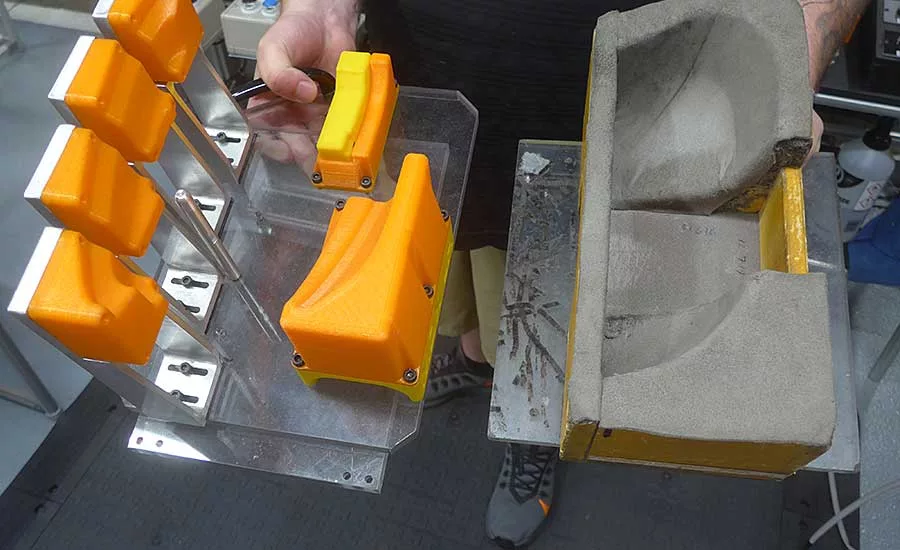

The fixture on the left was produced in-house with 3D-printing technology. Photo by Austin Weber

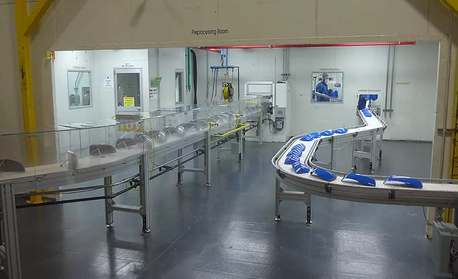

A new modular belt conveyor that connects the injection department with the paint shop has improved throughput by 58 percent. Photo by Austin Weber

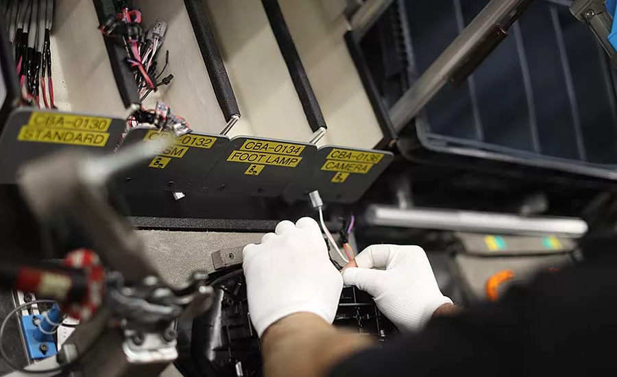

“On all of our lines, any process that deals with a critical component or part is labeled with what we call a ‘Critical C,’" notes Pulley. “This is a visual indicator to the team member performing the task that a critical function of the mirror assembly is being performed at that process.
“Previously, most mirror assemblies we produced only had a couple of standard features, such as manual or powered actuators for glass movement, defrosting capabilities and side-turn indicators,” says Pulley. “Now, with some luxury vehicles, we are seeing mirror assemblies that incorporate several advanced feature sets.
“Our highest-grade mirror consists of a powered actuator for glass travel, electrochromic dimming glass, defrosting capabilities, blind-spot and side-turn indicators, and power folding capabilities,” Pulley points out. “Other features include user memory retainment, illuminated puddle (courtesy) lamps, advanced camera systems with CAN interfacing systems and chrome-trimmed accents with vehicle color-matched covers.”

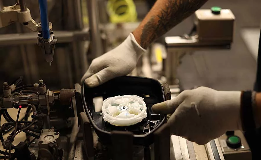

The production process at the 2020 Assembly Plant of the Year starts with plastic injection molding. To control quality and streamline production, MMUS operates a three-shift department that can produce up to 70,000 components per day on 15 state-of-the-art presses.
Acrylonitrile butadiene styrene is used to produce all parts that will be painted, such as body shells, while acrylonitrile styrene acrylate and glass reinforced polyamide are used for all internal, nonpainted parts.
MMUS recently installed a modular belt conveyor to move parts from the injection department to the paint shop. “The new system has improved throughput by 58 percent and reduced labor costs,” says Allen Gaines, manager of injection and paint.
“We use three robots to paint about 130 different colors,” explains Gaines. “We paint nine to 10 colors to support each current model-year vehicle platform. The other colors are reserved for older models that our service department supports.”
The majority of mirrors are painted in monochromatic colors, such as black, gray, silver or white. However, lots of blues, reds and other colors are mixed in. The flexible paint shop is designed for frequent changeover and typically runs 40 to 50 different colors per day.
Parts receive three coats consisting of a primer, a base and a clear coat. Then, they bake in an 80 C oven for 1 hour.
After components leave the paint shop, they’re loaded onto another conveyor where they move past a manual inspection station where eight people pull off parts and carefully examine them. Components that pass are put on an upper belt, while rejects are placed on a lower conveyor and returned to the paint shop.
An in-house quality lab also measures a variety of factors, such as ensuring the correct color match, in addition to testing paint adhesion, hardness and thickness.

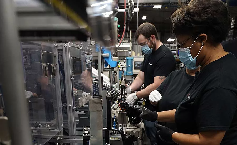

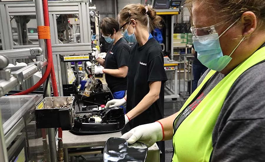

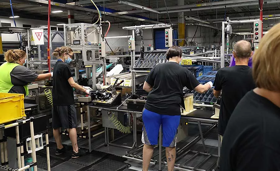

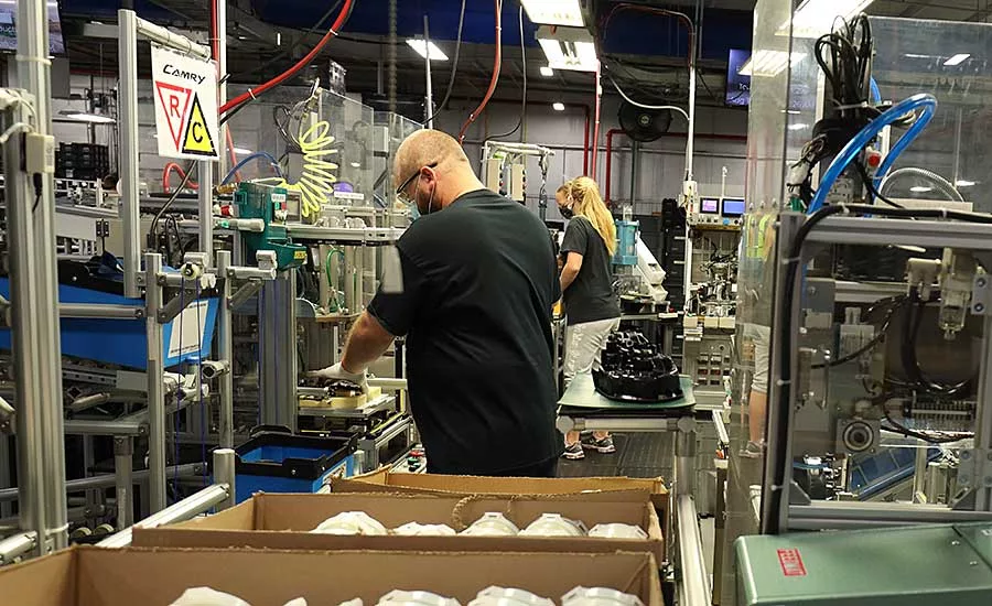

Murakami operates nine assembly lines in Campbellsville that support current model-year vehicles. A 10th line for a new product will be ramping up in December. In addition, three assembly lines support a dedicated service department, which is responsible for producing low-volume, on-demand mirrors for legacy vehicles.
The service department supports 21 older vehicle models and ships out service parts for five of the current mass-production models. A team of 12 individuals produce more than 9,400 pieces monthly.
“With some models requiring us to produce parts for up to 20 years after the program ends, keeping each standard assembly line was just not feasible,” says Chance Harker, assembly manager. “With each model requiring its own torque and screw count specifications, we knew that trying to combine multiple lines would prove to be difficult for us.
“We came across a hand driver system that was capable of switching between eight different preprogramed sets of torques and screw counts,” explains Harker. “With volumes being much lower for service than in a mass-production scenario, we were able to eliminate all the screwdriving robots in favor of these hand drivers.
“With this technology, we were then able to link several of these units together to make a tabletop-style assembly line,” notes Harker. “This was helpful in reducing the space of a traditional-style assembly line.

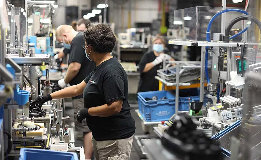

The other assembly lines at MMUS are unique to each customer’s specification, but use standardized tools and workstations.
“In 2013, we launched our ‘model line’ initiative,” explains Harker. “With that, we developed a line layout system that we have used in all assembly lines since. This common layout allows for easier cross training between models and a better standardization throughout the plant.
“Our equipment is also standardized as much as possible between the lines, depending on the design of each part,” says Harker. “Screwdriving robots and end-of-the-line testers are the norm for each assembly line. We also utilize pneumatic pressing robots, as well as hand drivers and vision systems on some of our lines. The product features, although similar, can vary between each line.”
Daily production volumes vary between 650 and 1,900 pieces per line. To maximize flow, workstations are arranged in U-shaped cells staffed by three to five operators who rotate every two hours. Each line is replenished by AGVs once an hour.
Assembly tasks include installing actuators, cameras, glass mirrors and wiring harnesses, and attaching a bar code label for traceability. Snap fits are used whenever possible, but assemblers use screwdrivers to attach many internal components. Wire crimping is also used. One of the last steps in the assembly process is installing a back cover and ensuring that the correct color is used.
“One of our lines produces lower grade mirrors that still incorporate an actuator that has to be manually adjusted in the vehicle,” says Harker. “Some lines produce a high-grade mirror that can also house several different functions, such as a power actuator, power folding, electrochromic dimming and defrosting options for the glass, blind-spot detection, side-turn indicators, memory retaining, intuitive camera systems, puddle lamps and chrome trim.”
After each mirror assembly passes electrical and functional testing, it’s cleaned and carefully placed into returnable dunnage, then transferred to finished goods racks that are shipped to auto plants on a daily basis. Every side-view mirror has a cable and two or three bolts protruding from its mounting base that enable MMUS customers to easily attach them on their final trim lines.

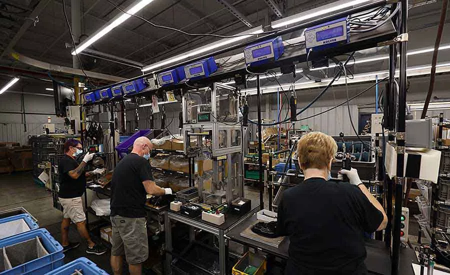

While snap fits are widely used in the MMUS production process, mechanical fastening also plays a critical role at the 2020 Assembly Plant of the Year.

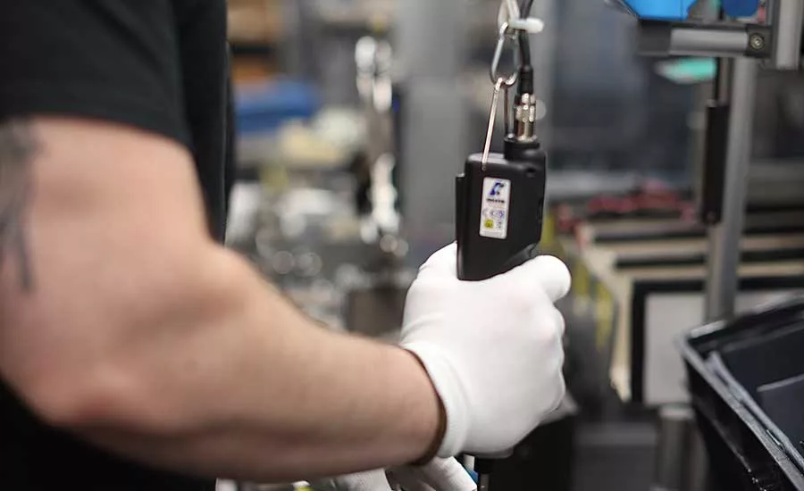

“Screwdriving is at the heart of the assembly process,” claims Harker. “Most of the internal structure of our mirror assemblies require some form of fastening. Ensuring these parts are held together correctly is imperative for the overall structural integrity of the mirror.
“We utilize several screwdriving robots, along with brushless electric hand drivers on each assembly line,” says Harker. “Daily, we ensure that these fastening tools are working properly to ensure we achieve the correct fastening torque, as well as the correct screw count for each process.”
MMUS recently decreased the size of its assembly line footprint by consolidating screw robots to perform multiple tasks.
“As we have grown, space has become increasingly more valuable,” explains Ron Sherman, engineering and tooling manager. “To reduce overall footprint, our launch team was tasked with reducing line size and maximizing equipment output. In doing so, we realized that certain pieces of equipment could be consolidated and combined into one robot.
“Taking part variation and volume ratio into account, we were able to combine some of our low-volume robots and incorporate them into the higher volume ones,” Sherman points out. “This allowed us to not only reduce the line size from a space-saving standpoint, but also allowed us to reduce operator walk time by eliminating the need to walk past equipment that was not always in use.
“Using our kanban system as a trigger, along with interchangeable fixturing, we were able to seamlessly incorporate the change between low- and high-volume parts,” says Sherman.

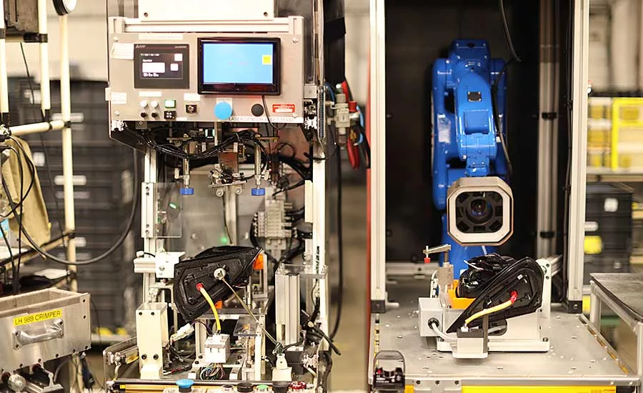

To verify product quality, MMUS has invested in state-of-the-art cameras and vision systems that inspect and detect missing parts or defective products.
“Our vision systems are mainly used for detection,” says Harker. “These cameras help ensure that certain components are correctly placed or present before moving onto the next process on a line.
“We typically use the cameras to check for things that may not be visible once the part is assembled, ensuring that no components are overlooked,” explains Harker. “Other times, we use the cameras in conjunction with our kanban system to verify that each version of the part receives its own unique components, ensuring each part meets its intended specification.
“We have recently invested in a vision system for complete part inspection,” notes Harker. “This system uses advanced vision with machine learning to ensure the quality of our final product. Our current system checks approximately 24 different locations on the part. This includes checks for gaps, missing components, soft set connections and proper positioning.
“We have used past history to identify potential issues and incorporated them into this vision system,” says Harker. “This allows us to be able to add checks as needed. While we currently have this vision system on two of our lines, we plan to fully integrate this system across all lines within the next five years.”

“After the electrical testing is complete, mirrors go through a thorough visual inspection to guarantee quality,” says Harker. “This inspection is currently done by operators on the assembly line.
“Regular audits are performed by trained quality team,” Harker points out. “We also have recently implemented a robotic vision system to help with up to 24 of the visual checks. It monitors things such as gaps, missing components, soft set connections and proper positioning.”

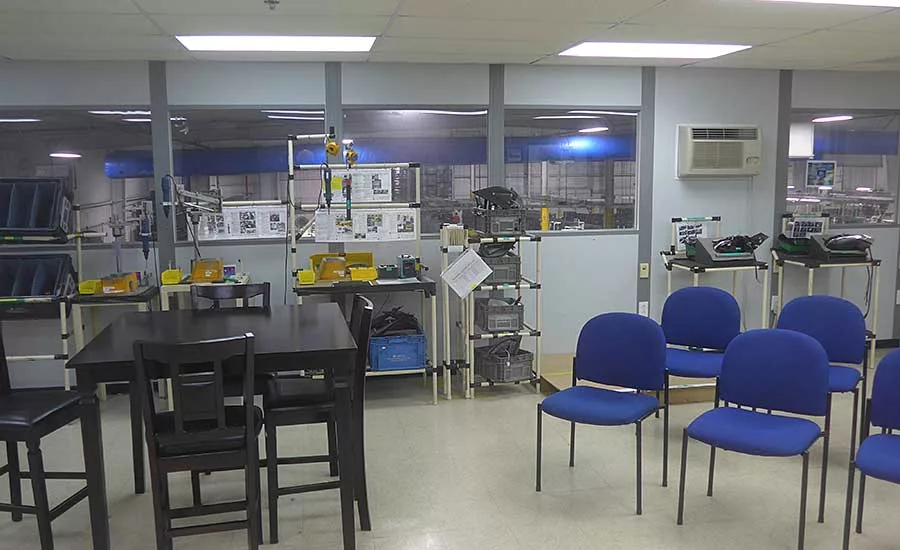

Lean Manufacturing
Murakami Manufacturing USA Inc. has embraced a variety of lean manufacturing principles to drive continuous improvement and just-in-time production initiatives.
“Working closely with Yoshiaki Nakada, our senior Japanese coordinator, we have a dedicated Murakami Production Systems (MPS) department that works with operations to establish and review cycle times, line balance and standardized work,” says Pulley. “MPS also reviews and provides assistance as required for team member continuous improvement submissions.”
Every morning at 8 a.m., group leaders gather and fill out targets and actuals on a board that tracks key performance indicators, such as quality and safety. All employees also participate in a kaizen program. Continuous improvement ideas are tracked and each team member who submits an idea gets recognized at a monthly meeting.
“We have combined global benchmark activities and internal continuous improvement to provide a platform for constant growth,” claims Pulley. “This concept provides the unique opportunity for cross-functional groups and different cultures to come together with the common goal of improving processes and people, along with sharing of ideas in the spirit of continuous improvement.”
Incentive programs for maintaining safety, quality, production and continuous improvement submissions, coupled with opportunities for training and development, keep all employees involved in problem solving and process improvements.
“At Murakami, we are always encouraging team members to submit kaizen suggestions,” says Pulley. “While not all of these suggestions can be followed through on or implemented, several suggestions have actually been put into place and created huge improvements for our assembly lines by eliminating non-value-added work.”

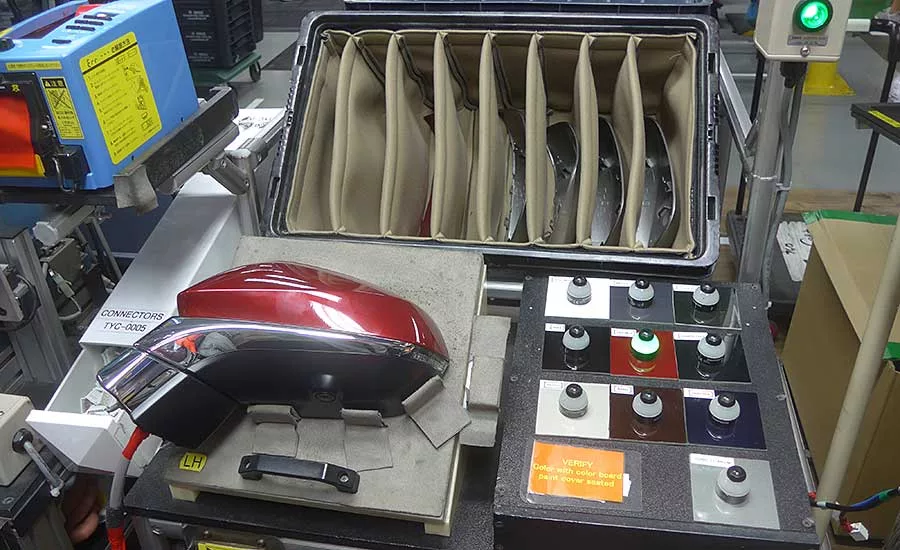

“In 2015, we began our journey into karakuri to improve the handling of totes and boxes,” says Pulley. “The goal was to eliminate any non-value-added processes. With a better understanding of how karakuri is used, we reached out to our parent company in Japan for support.
“These racks were already being used throughout our Japanese plants, and designs were already complete for lines similar to our own,” recalls Pulley. “We decided to purchase several racks from Japan with the idea that we could then reverse engineer them in-house."
“Once we received the racks, we were able to study them and gain a great understanding of how they were built,” explains Sammy Ross, manufacturing launch engineer. “We then began to duplicate these racks, making modifications and improvements as we went.
“With this activity, we were able to produce three assembly lines; one consisting of the racking from Japan and two of which we had built completely in-house,” says Ross. “After these lines were put into place and we began running tests on them, we found many areas we could improve upon. With these improvements in mind, we began design and development of our own unique racks, separate from anything we had received from Japan.
“Through much trial and error, we were able to come up with a design that would be the basis of all of our racking moving forward,” Ross points out. “Utilizing this design, we were able to not only boost production by eliminating the non-value-added processes we had initially set out to do, but we were also able to alleviate several ergonomic concerns as well.
“Our greatest ergonomic achievement to date has been the elimination of the need to handle heavy totes,” claims Ross. “One of the totes used to house our finished product weighs approximately 28 pounds.
“This tote was being lifted between 20 to 25 times per hour,” recalls Ross. “With the introduction of our in-house design, we were able to completely eliminate this task with a series of counterweights and brake systems.
“Since the implementation of our karakuri racking systems throughout the assembly shop, we have been able to reduce a total of 56 non-value-added processes, as well as a reduction of more than 13,000 labor hours per year as of 2019,” adds Ross.

Last year, MMUS began to use a fleet of AGVs to move parts to its assembly lines. The in-house engineering project has saved the company thousands of dollars and has improved productivity.
The AGV initiative was first started in 2016 in conjunction with the University of Kentucky mechanical engineering department as a capstone project led by Chris Force, systems engineer. Initially, the AGVs were set up to transport preloaded pallet jacks between the injection molding department and the assembly lines.
“It would tug pallet jacks between the two areas where operators detach the pallet jacks and move the pallets to their final destinations in those areas,” recalls Sherman. “Due to spacing and manning requirements for this version, they were only prototyped and not put in full production.
“However, after a new subassembly area was installed in injection, the AGV was redesigned to transport totes to the assembly lines it fed,” says Sherman. “We chose to move totes instead of the pallets on a pallet jack to reduce the storage space and material handling issues the previous version had. This was the first AGV put into production.
“In late 2018 and early 2019, with the addition of our new warehouse, we looked for a way to automate the movement of parts and materials from the warehouse to assembly,” notes Sherman. “Our solution was to design new AGVs and carts to automate this process, improving our material handling and parts delivery, due to reduced travel time and decreased floorspace.”
More than 95 percent of part transportation between the warehouse and the assembly lines is now automated. Previously, this type of material handling was done manually with pallet jacks.
“Travel time for parts handlers in assembly was also reduced,” explains Harker. “The parts coming from the warehouse were all in one place right next to the line, instead of the rows of shelves they previously had to walk down to find warehouse parts.
“We previously used long shelves by the assembly lines to store warehouse parts that were refreshed with new parts twice a day at most,” says Harker. “By refreshing warehouse parts hourly on a cart, less storage space is needed in assembly. We only need an hour’s worth of parts, letting us replace large shelving units with single sets of carts.”
Additive manufacturing is another cutting-edge technology that was recently adopted by the 2020 Assembly Plant of the Year.
In 2018, the newly formed engineering department started to design new fixturing for an upcoming program that would launch the following year. The goal was to create a fixture that was easy to set the part in without operators needing to focus on part placement; they would drop it in and it would settle in the correct position. At the time, the fixtures had to be covered with protective felt to prevent scratching or marring surfaces.
“The jig was originally supposed to be machined,” says Pulley. “Given the time and costs involved with machining, we used additive manufacturing to prototype the fixture, but we found that the best designs would be difficult to machine and even more difficult to felt. After researching softer materials, we decided it would be better to simply print the fixtures.
“The new fixtures hold parts better by forming exactly to the part surfaces,” explains Pulley. “If the part is placed in about the right position in the fixture, any slight pressure from the equipment will lock it into place or the team member will slide it the rest of the way into position on the fixture.”
In addition, the increase in touch points and the softer material reduces the risk of damage.
“By using softer material, but in more locations or along surfaces of the part, we could use mostly softer material while keeping proper part position,” says Pulley. “Previously, felted fixtures had maintenance issues, such as getting peeled up and worn down.
“The glue that was holding the felt could then damage the part,” Pulley points out. “The felt would also affect the position of the part in some of the equipment. The material we print with cannot mar the part and will deflect if a chip comes between it and the part so that the part is not scratched.”
Fixtures and their replacement parts are also cheap and easy to produce.
“Previous fixturing cost upwards of $3,000,” claims Pulley. “The new 3D-printed fixtures cost between $1 and $100 in material and assembly cost.
“In the past, fixturing would take a few weeks to arrive or would require expensive expedited shipping,” adds Pulley. “The 3D-printed fixtures have replacement fixtures premade and any further replacement parts can be printed within a day.”
