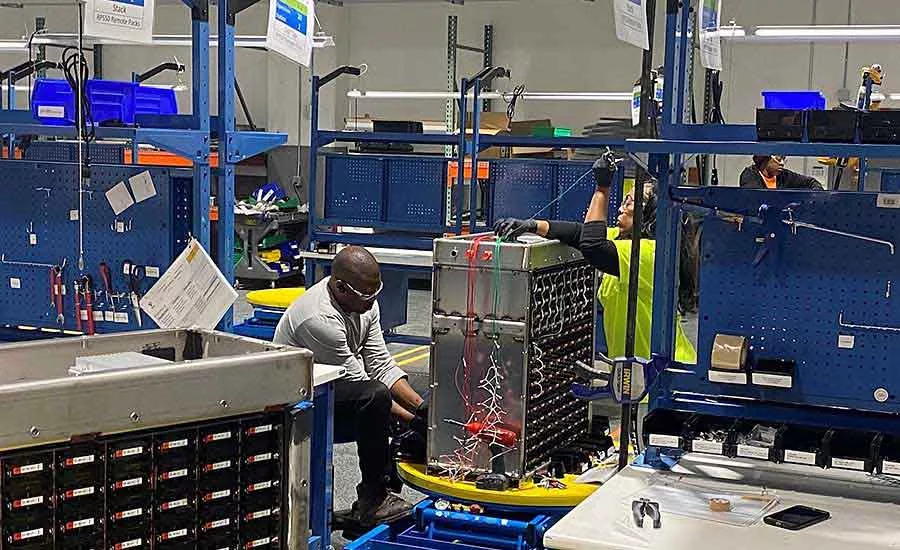

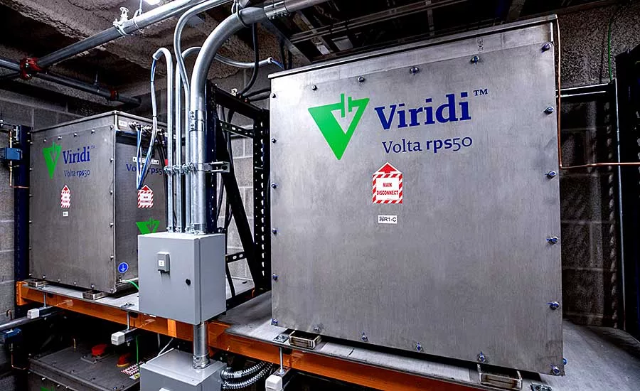

Viridi’s Volta batteries provide stored energy to power buildings. The batteries are designed to be fail-safe for installation in occupied spaces. Photo courtesy Viridi Parente Inc.

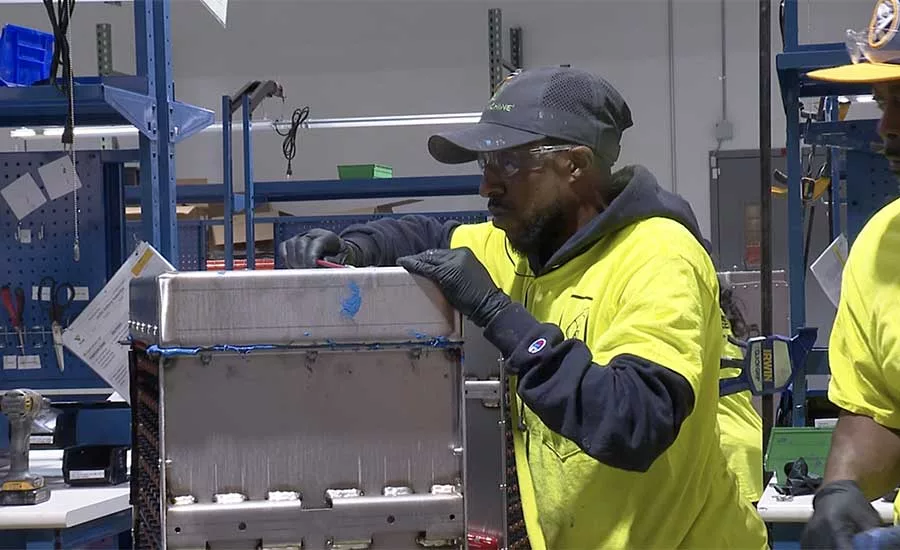

Viridi sponsors GreenForce, a community-based nonprofit organization that recruits unemployed and underemployed candidates and provides them with training and support to obtain advanced manufacturing jobs. Photo courtesy Viridi Parente Inc.

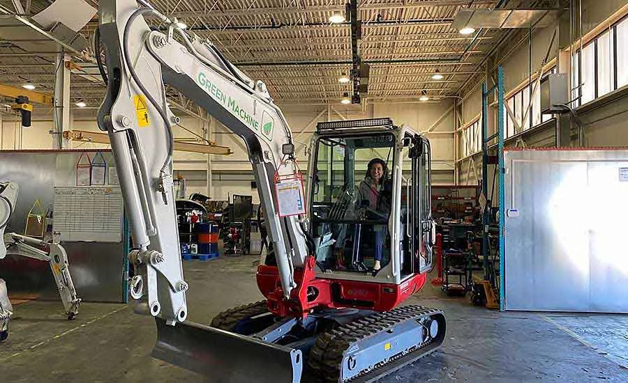

New York Gov. Kathy Hochul tries out a battery-powered excavator at Viridi’s assembly plant in Buffalo, NY. Photo courtesy Viridi Parente Inc.

His start-up company, Viridi Parente Inc., makes lithium-ion batteries—brand-named Green Machine—for construction equipment, such as excavators, enabling the machines to run on electricity instead of diesel fuel. The brand is being lauded for its long cycle life, resilient physical design and completely self-contained architecture. The batteries have already logged more than 250,000 hours of field use with actual customers. By some estimates, the market for electric-powered construction equipment could reach $205 billion in North America by 2025.
An alternative version of the battery—brand-named Volta Energy—provides a source of stored energy to power buildings. The batteries are designed to be fail-safe for installation in occupied spaces. Battery systems can be configured to provide from 50 kilowatt-hours to 5 megawatt-hours of distributed energy storage at the point-of-use. Applications include data centers, manufacturing facilities, homes, businesses and research facilities—anywhere that fail-safe, resilient, renewable energy is needed.
