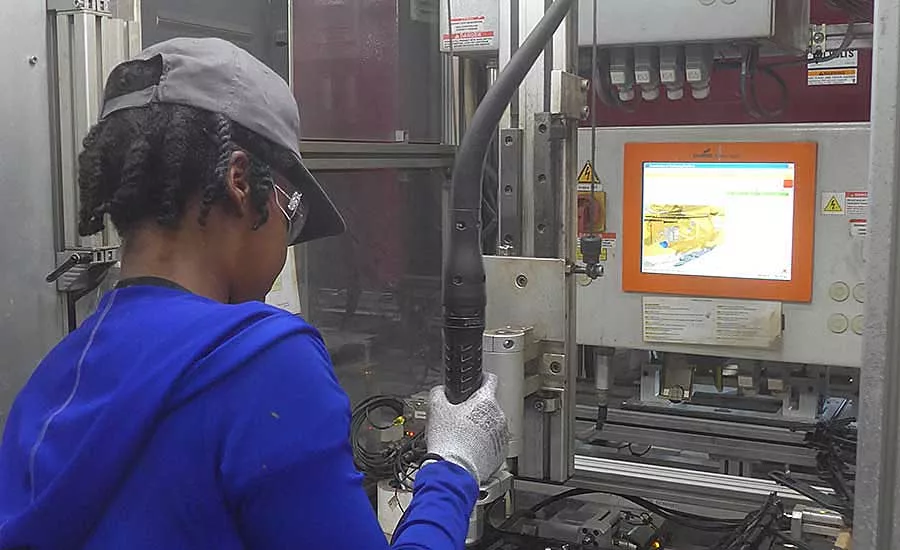

Many manufacturers are investing in collaborative screwdriving systems that enable humans and machines to work in close proximity on assembly lines. Photo courtesy Visumatic Industrial Products Inc

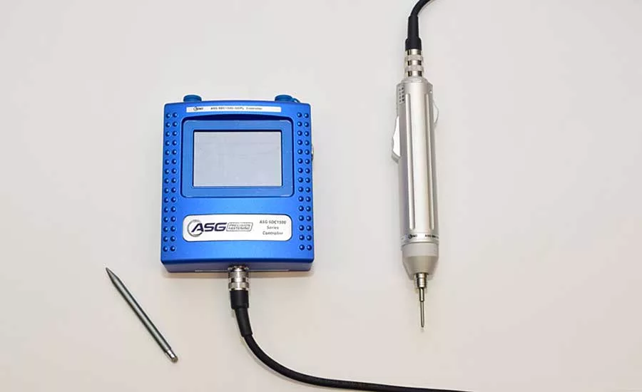

This current-controlled screwdriver can be used as a handheld tool, fixtured in a torque arm or mounted to an automated system. Photo courtesy ASG, Division of Jergens Inc.

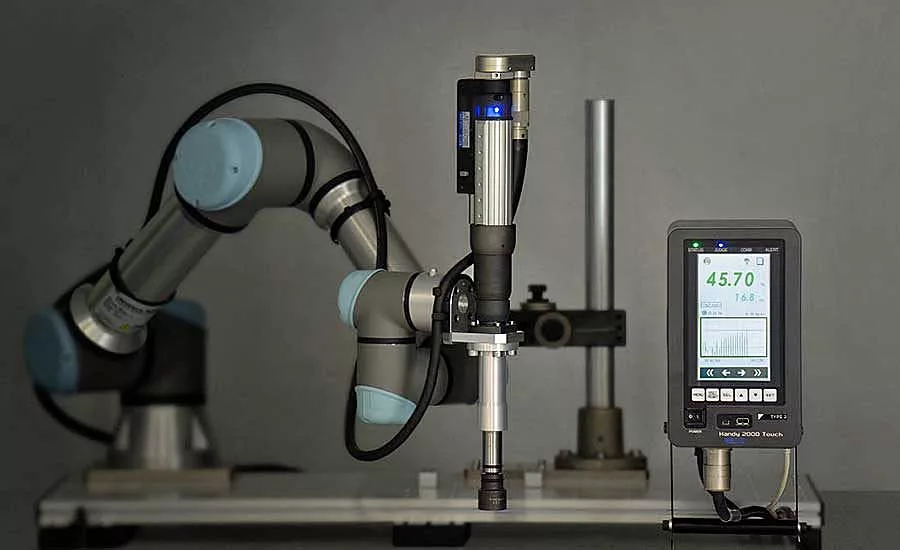

This transducerized screwdriver allows engineers to control a variety of parameters during run-downs, including angle, running torque, clamping torque and total torque. Photo courtesy Kolver North America

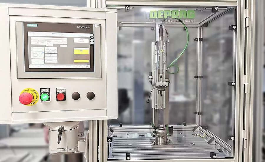

This screwdriving system provides precise control over speed, torque, axial force and stroke. Photo courtesy Deprag Inc.

Automatic screwdriving machines can be equipped with electric or pneumatic tools. For general assembly work, pneumatic tools are preferred for their durability and high power-to-weight ratio.

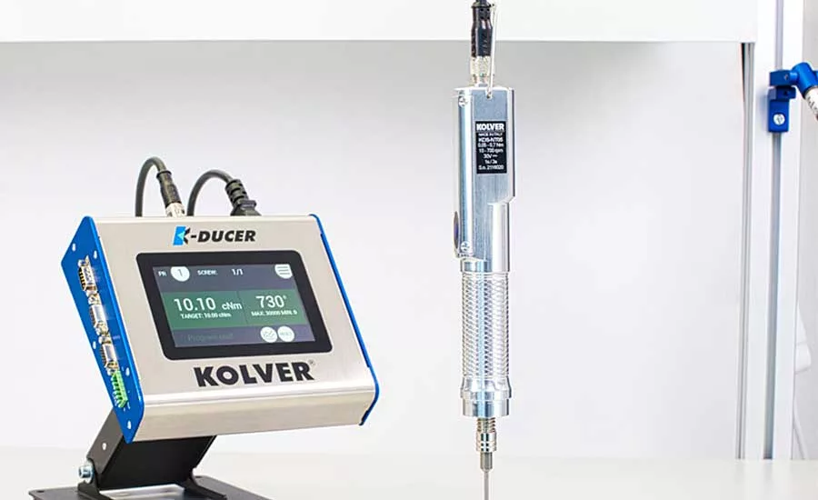

For low-torque applications, a brush DC electric tool is often preferred. Some assemblers want torque and angle measurement from the tool for statistical process control. In this case, a brushless DC electric tool with a transducer and encoder is used.
With the right tooling, torque control with an automatic system should be as good as with a manual tool. However, engineers may need to adjust their torque specifications to allow for the drag as the bit and fastener exit the jaws of the machine.

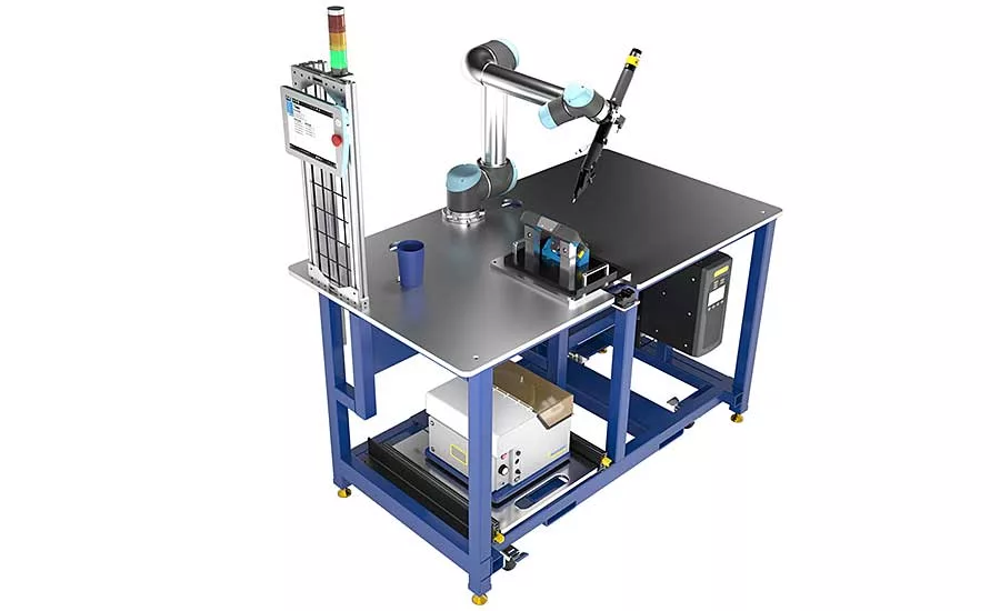

Screwdriving tends to be a dull, repetitive task for humans, making it prone to errors. It’s a perfect candidate for collaborative robots, which can provide flexibility and repeatability.
Faced with severe labor shortages and reshoring initiatives, large and small manufacturers are investing in collaborative screwdriving systems that enable humans and robots to work in close proximity on assembly lines.
Operators can work side by side with cobots. Humans can focus on tasks that are easily accessible, while the machines work on things that are more difficult, such as inserting and driving screws in hard-to-reach areas or confined spaces where fasteners aren’t always visible.
“[Automated] screwdriving used to be a task that was complex, costly and took up a large footprint on the assembly line,” says Catherine Leclerc, product owner for screwdriving applications at Robotiq Inc. “As such, it was reserved for use in vast plants with big automation budgets producing in high volumes.
“This type of custom project by an integrator could hardly meet the reality of small manufacturers that deal with [limited] assembly line space, tight budgets and [sparse] automation staff,” Leclerc points out. “Now, with screwdriving systems designed specifically for cobots, the technology has become accessible to any manufacturer.
“There are screwdriving systems that can be bought off the shelf, shipped within a few business days, easily installed and adapted to production changes,” claims Leclerc. “It’s a completely new era.”
“Screwdriving is a great application for cobots,” adds Joe Campbell, senior manager of strategic marketing and applications development at Universal Robots, the company that pioneered the technology more than a decade ago. “In fact, it’s one of our most popular applications.
“All of the programming is done through the UR teach pendant,” Campbell points out. “That has simplified things and removed a lot of risk, especially for smaller manufacturers that may have shied away from automation in the past.”
Collaborative screwdriving is used in many industries. However, engineers must perform a thorough risk assessment and deploy proper safeguarding to ensure the safety of humans working around or with a cobot.
“Every company is different in how they determine what ‘collaborative’ means and how they set up in-house rules of engagement,” adds Jarrod Neff, marketing manager at Visumatic Industrial Products Inc.
“We have some customers that use cobots in conjunction with light curtains, safety guarding or area sensors that can detect human movement,” says Neff. “They want higher throughput, but simply don’t feel comfortable operating their machine at maximum speed.”
According to Neff, cobots are popular for driving small screws that range in size from M1 to M3. “Typically, screws with lengths up to 20 millimeters work best,” he points out.
“Cobot screwdriving requires slower movements, lower throughputs and lighter duty tooling on the end of arm,” claims Neff. “As a general rule of thumb, any application that requires a torque of 50-inch-pounds or less, should be OK to use with cobots,”
“[Using] safety-caged, fully automated [screwdriving] is typically expensive, complicated and maintenance intense,” adds Don Seay, general manager at ESTIC America Inc. “Engineers can now take a hybrid approach and consider which assembly processes are best served by an operator, and what processes could be performed by a torque tool integrated on a cobot working beside a human.
“Engineers need to consider what applications an operator can do better than a robot,” explains Seay. “Then, assign tasks to the machine that would make the human’s job easier. You might see humans do hand starts of screw, with cobots doing final tightening with a torque tool down the line. That allows cycle times for humans to be faster.”
