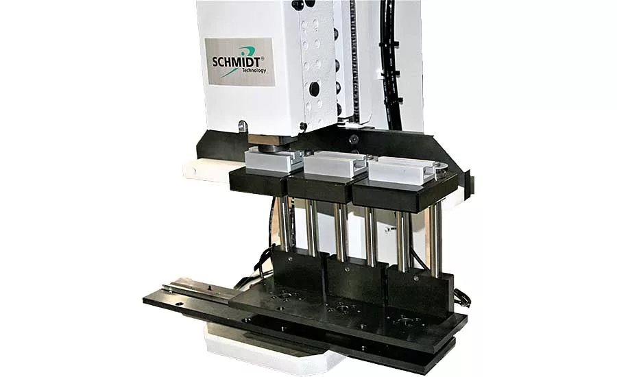

Schmidt has designed shuttle fixtures for pressing cells. The tooling for three different assemblies are grouped side-by-side on a sliding shuttle. To change from one assembly to another, the assembler simply unlocks the tooling and slides another set into place. Photo courtesy Schmidt Technology

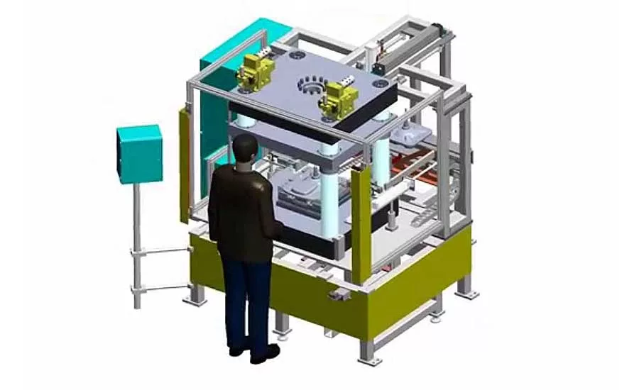

Tox designed this semiautomatic joining press for a transmission component. The final assembly is walked to the rear and placed on a conveyor. Photo courtesy Tox Pressotechnik

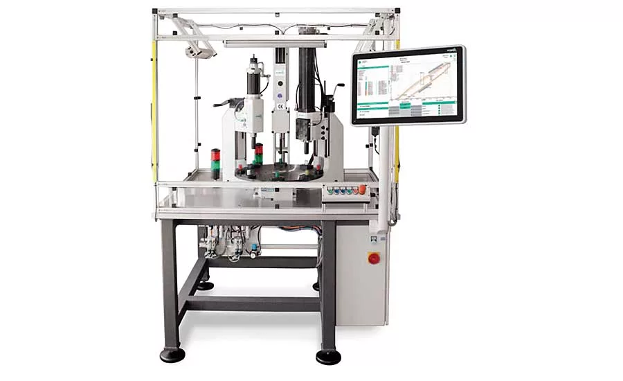

This small rotary indexing system features three presses. An operator loads and unloads the parts. Photo courtesy Schmidt Technology

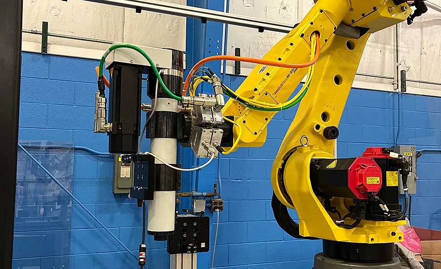

The Promess L-Series Robot EMAP is a lightweight optimized servo press for robotic applications. The press features quick-connect technology, allowing the press to be used as one of many tools in a flexible robotic assembly cell. Photo courtesy Promess Inc.

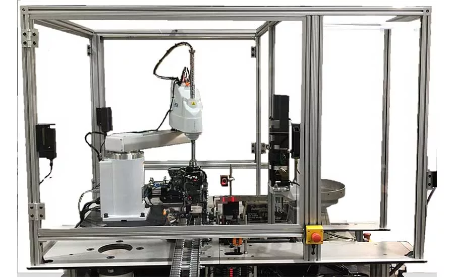

In this system, a SCARA robot picks parts from a conveyor and places them into a fixture on a linear slide. The slide then takes the parts into a press. Photo courtesy Schmidt Technology

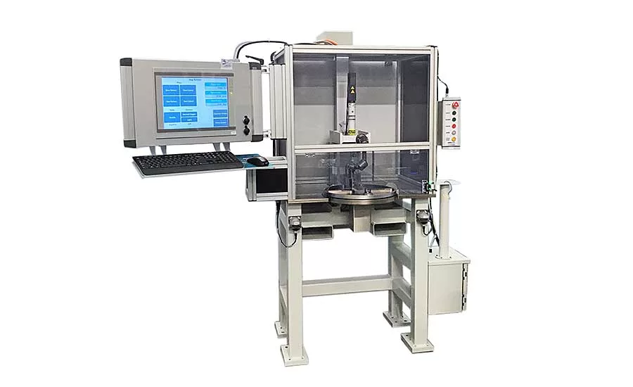

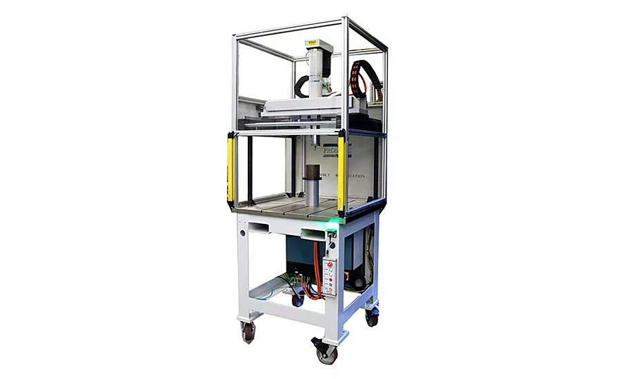

This servo press workstation equipped with a load-bearing index table. Force can be directly applied to the table without any external load back-up. The press area is also isolated, so the operator can safely load the next part while the press is running. Photo courtesy Promess Inc.

Another way to increase throughput via fixture design is to reduce changeover time. Schmidt has designed shuttle fixtures for pressing cells. The tooling for, say, three different assemblies can be grouped side-by-side on a sliding shuttle. To change from one assembly to another, the assembler simply unlocks the tooling and slides another set into place.

It’s also becoming more common for manufacturers to reverse the process. Instead of having a robot take the parts to a press, the robot takes the press to the parts. This arrangement can be accomplished with a six-axis robot, for large assemblies, or a gantry robot, for smaller assemblies.
The former arrangement is more common in fully automated assembly lines or when parts are too large to move easily. The latter is good for small assemblies requiring fast, simple pressing operations, such as press-fitting pins. An assembler loads a tray with a matrix of parts, and the gantry moves the press from part to part processing each part. This way the operator can perform other tasks or load and run additional machines while the first machine is processing the tray.

If only a few steps are needed to complete an assembly, integrating a press with a rotary indexing table can double output compared with a manual operation, says Nausley. There are two advantages to using an indexing table. First, it will increase throughput, since assemblers can unload completed assemblies and reload fresh parts, while other assemblies are being processed in other nests.
“This technique can also add safety to a manually loaded operation, since loading and unloading take place outside of the working envelope of the station,” Nausley points out.
However, for this option to work, the table must be designed to support the load.
“Most indexing tables on the market are not designed to take the high loads that are required in a pressing operation,” Nausley observes. “This is important for two reasons. First, of course, the indexer must be able to survive long-term having the press load applied to it cycle after cycle. And second, the indexing table must provide the level of mechanical stiffness and precision required for the assembly operation.”
A rotary indexing system can do 60 assemblies per minute. Such systems are typically horizontal, but they can also be vertically oriented, like a Ferris wheel. For example, Tox recently designed an automated press system to assemble lug nuts for a pickup truck. That system is able to complete 85 to 100 assemblies per minute.
