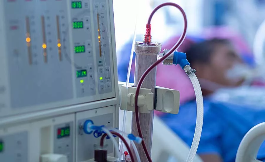

hemodialysis filter
Many medical devices, such as this hemodialysis filter, are assembled with ultrasonic welding. Photo courtesy Branson Welding and Assembly at Emerson
July 4, 2023
Ultrasonic welders are used to assemble a variety of plastic products. However, the requirements for a welder to make medical devices are much stricter than those for a machine to weld, say, toys or consumer products. Here’s a list of things to think about:
