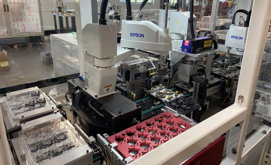

SCARA robots load and unload pallets. The robots provide flexibility to handle different components or different shipping trays.
Photo courtesy Epson Robots

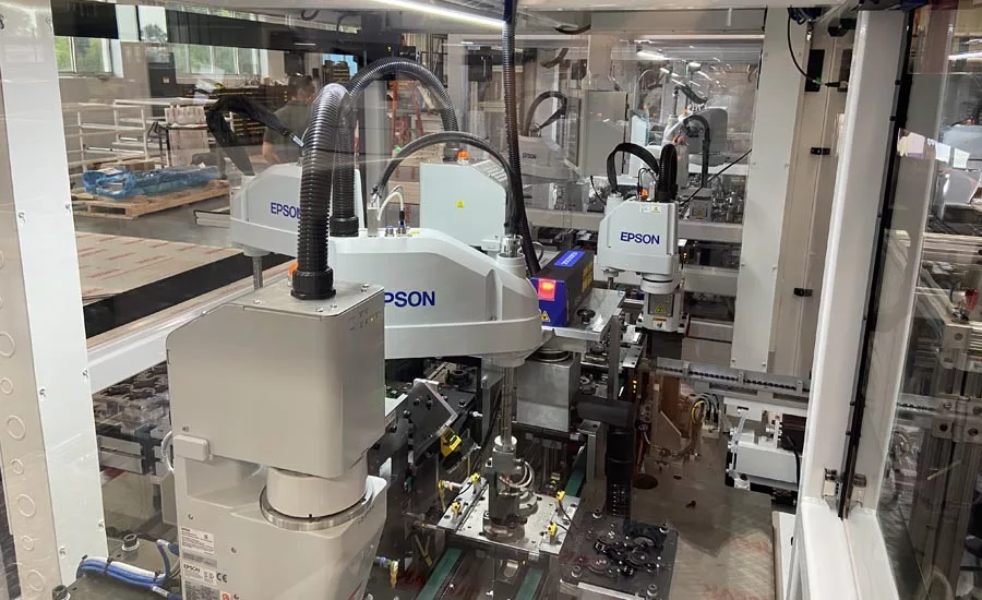

Some robots at Husco have been running for more than 14 years.

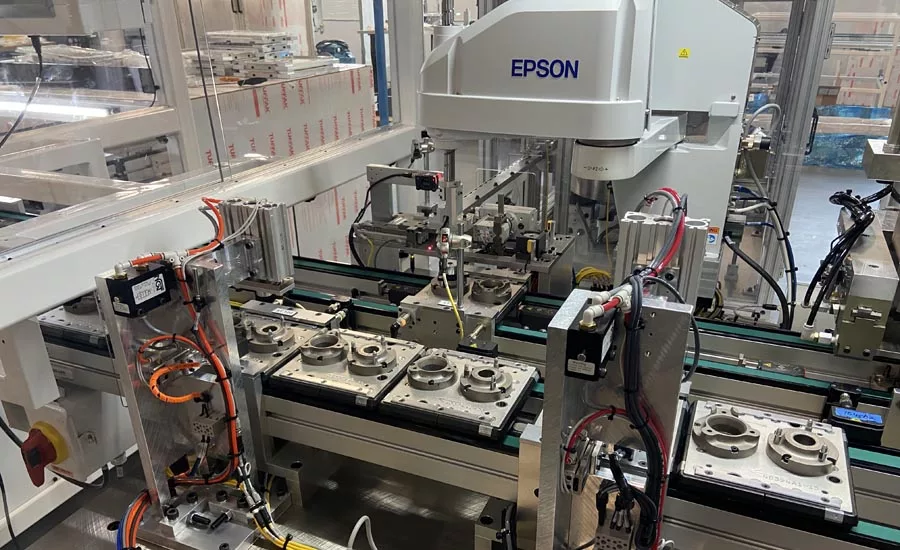

In some cases, SCARA robots replaced pneumatic or servo-driven pick-and-place mechanisms.

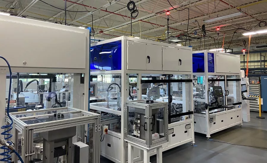

Husco engineers developed a modular automated assembly system consisting of a pallet-transfer conveyor and 10 Epson SCARA robots for most of the material handling.

To make that possible, the AMG team developed a modular automated assembly system consisting of a pallet-transfer conveyor and 10 Epson SCARA robots for most of the material handling. They settled on one Epson G6, two G3, and seven T-Series systems.

The system consists of three cells. “In the first, we load armatures, c-pulls, caps, and coil assemblies, combine them, press them together and crimp them,” Wampole explains. “In the second, we test for air leaks and do force vs. distance curve testing of the finished products. Finally, we pack them out into a set of vacuum-form trays for shipping to customers.”
To assemble parts at the necessary speed, “we have to load and unload the pallets with robots, and we need flexibility to handle component variations or to adjust for the trays we use for shipping,” he adds.
Husco and AMG most often use Epson T-Series robots for pick and place operations, but upgrade to the G-Series when they need higher speed and accuracy.
“The T-Series offers a very cost-effective solution for moderately complex or quick movements, and its built-in controller is an excellent option for quick installation and easier integration,” says Wampole. “Its cost effectiveness gives us the flexibility to replace pneumatic or servo-driven pick-and-place stations with a robot.”

One bottleneck has been the crimping operation at the end of the assembly, which uses a machine Husco purchased from an external machine builder. “Up until last fall, we were running a pneumatic slide to move the parts to and from the crimp station,” he says. The machine picked a part from the pallet, flipped it vertically, then placed it into the crimp nest.
“We were able to run simulations with an Epson C4 six-axis robot that showed an ability to reduce the cycle time from 7.5 seconds to 6.5 seconds,” Gietzel recalls. That would mean an increase of 13 percent, or almost 550,000 parts per year.
Because it was an existing product, Gietzel’s AMG team built the robotic setup parallel to the assembly line, together with a secondary electrical cabinet and a direct drop to power the new robot. That way, once everything was ready, they were able to switch out the old pneumatic system with the robot with just three days of downtime.
This project, completed at the end of last year, was a resounding success, meeting its goals for cycle time reductions and increased productivity.
“Crucial to the success of the project was our ability to power on and test the new robot, and pretty much do all the movement simulations in our build area before we took the old machine down,” Wampole adds.

“For the most part, we’re getting five, six, seven years out of the standard SCARA robots without having to replace many, if any, components. In fact, we have some Epson robots that have been running for over 14 years. And I can’t say we run them in clean rooms—they do their work in oily, dirty situations. We put them through the ringer!”
