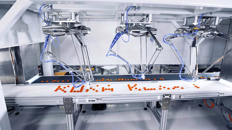

By installing several delta robots in a row, even the most demanding production rate requirements can be met with a minimal investment in floor space. Photo courtesy Kuka Robotics Corp.
