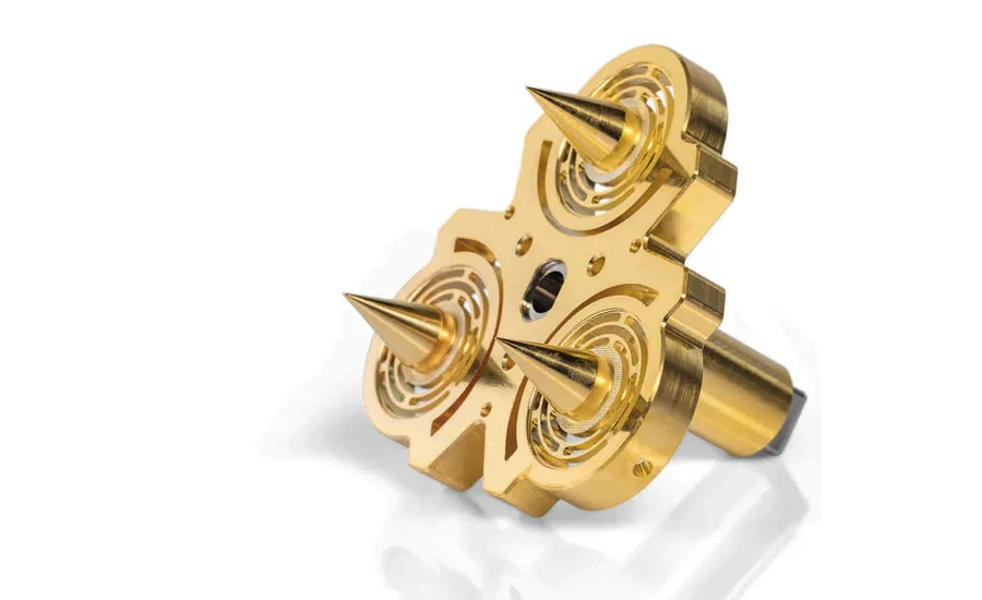

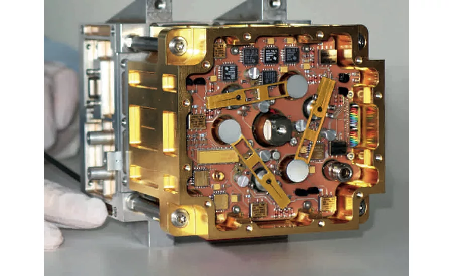

Developed by the Physical and Meteorological Observatory in Davos, Switzerland, CLARA is an electrical substitution radiometer for measuring total solar irradiation. Highly accurate and durable, it is based on a new design with three cavities to offer built-in redundancy and degradation tracking capability while minimizing size and weight.
Torsional Ultrasonic Welding

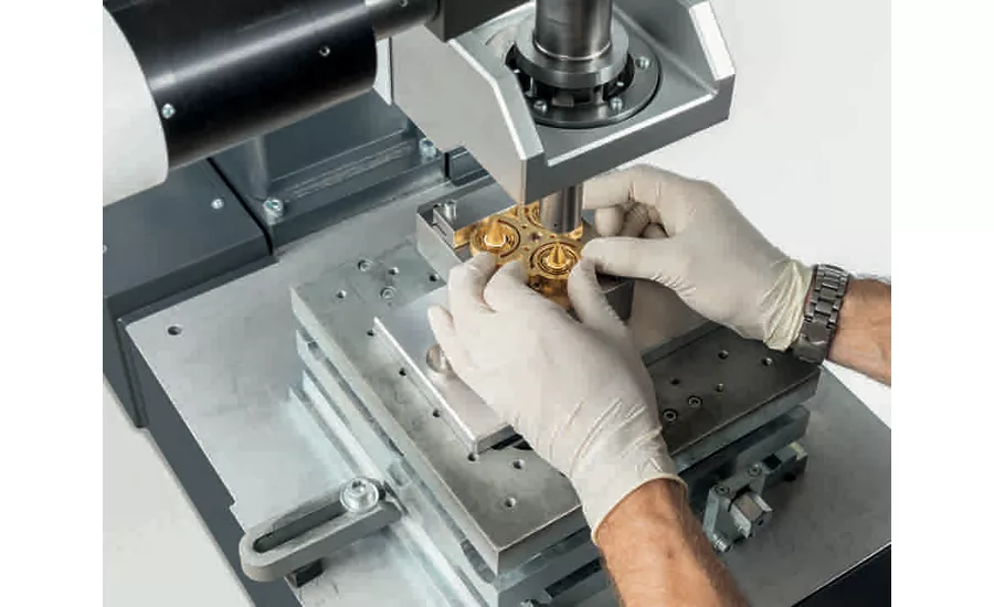

Assembling the instrument posed some challenges. One of them was to find a suitable method for connecting the small, 0.13-millimeter thick cavities to thermal resistors.
After extensive testing, the Observatory’s engineers chose the torsional ultrasonic welding system from Telsonic AG.
A traditional ultrasonic welding system applies linear vibrations at the joint interface. In contrast, torsional ultrasonic welding applies the linear vibrations in combination with a twisting motion at the same frequency. The result is a strong weld at the molecular level.
The technology is a proven and reliable method for assembling metal parts, such as a wire to a terminal. It offers fast processing times and extensive process control. The purely metallic connection is not subject to aging or fatigue. The firm bond also ensures very low contact resistance between components.
Ultrasonic welding can be used to join both similar and dissimilar materials, such as copper and aluminum. Additional consumables such as sleeves, solder or flux are not necessary, because the metals are welded together directly. In addition, ultrasonic welding produces low thermal stress on the parts.
This method produces a firm and mechanically stable connection that can withstand high vibrations. The torsional motion of the sonotrode introduces only minimal vibrations around the weld seam, protecting sensitive components and surfaces.
Although the satellite’s mission was originally scheduled to end in December 2022, it is continuing to transmit data. CLARA is still in operation and functioning well. However, the satellite has encountered issues with its gyroscopes, leading to inaccuracies and partial inability to align with the sun. In such cases, valid radiation measurement values cannot be obtained. Nonetheless, there are still correct measurement phases, and so far, nothing indicates a poor or degraded connection of the welded parts.
“Our CLARA instrument is still in operation and functioning well,” says Silvio Koller, electrical engineer and co-leader of the Technical Department at the observatory. “However, we require a precision of approximately ±0.5 degree for sun alignment, which is usually not a problem with larger satellites. NorSat-1 is a small satellite, more cost-effective, and therefore potentially slightly less reliable.”
