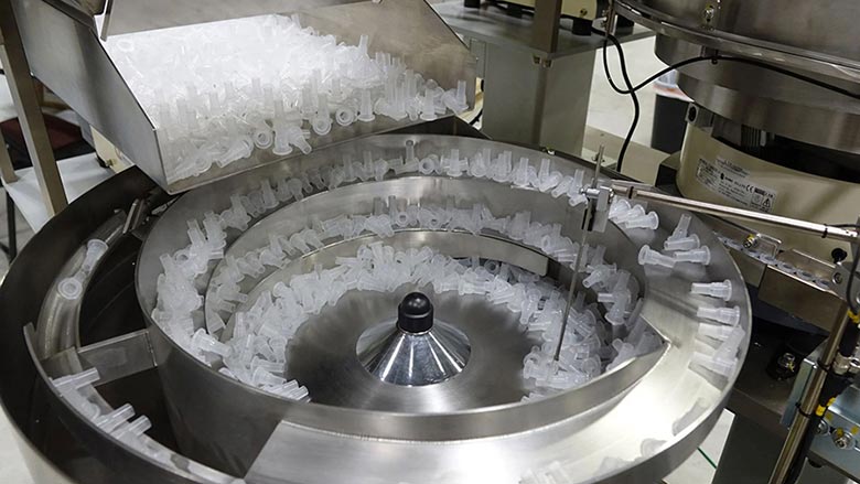

Feeder bowls
Feeder bowls are notorious for reducing OEE. Bent parts jam. Some parts tangle. The tuning changes over time. Photo courtesy Bellco Feeders
