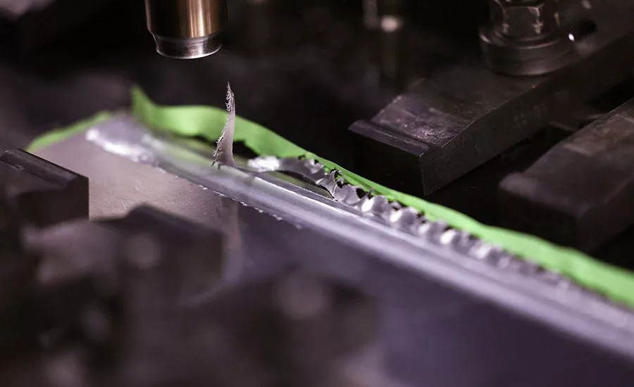

“The conventional wisdom for decades has been that plastic and metal are fundamentally incompatible, and there’s no reason to try welding them together,” says Dong. “However, we discovered that the right combination of heat and pressure in the right areas can cause the carbon and oxygen in plastic to bond with metal.”
Dong and his colleagues developed a robust technique for directly joining polymer to metal at speeds of up to 5 meters per minute. It works through the formation of chemical bonds at the joint interface by creating a localized pressure and temperature.
To apply heat and pressure, the engineers used a spindle tool adapted from an existing CNC machine. As it rotates at high speed and moves along a plate, the frictional tool generates heat that melts plastic to a bridging layer, creating a hybrid joint.
The joint configuration can be in the form of a spot or spatial curve. According to Dong, the strong chemical bond formed at the joint interface is the first viable method for welding plastic and metal directly together.
“We used an off-the-shelf machine that looks similar to a drill press with a cylindrical spinning head,” Dong points out. “The metal is placed on top of the plastic and the head is lowered onto the two materials.
“This creates heat and pressure, bonding the two materials together in either a spot weld or a linear weld,” says Dong. “A thin strip of a nylon-6 film provides the oxygen needed to force the formation of a nice, connected interface between the metal and plastic.

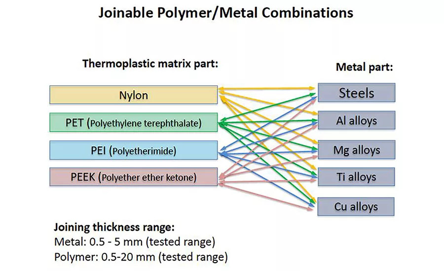

“Any metal can be bonded directly with any plastic that contains an adequate amount of oxygen-carbon compounds,” explains Dong. “The key is to calculate the ‘sweet spot’ of heat and pressure that will weld a given combination of materials. For plastics that don’t have enough oxygen-carbon compounds, like polypropylene, we can put an inexpensive plastic film between the two materials to ‘seed’ the bond with oxygen and carbon.”
A variety of plastics can be used, including nylon, polyetherimide, polyether ether ketone and polyethylene terephthalate. In addition to aluminum and steel, metals include copper, magnesium and titanium. Joining thicknesses for polymers range from 0.5 to 20 millimeters, while metal thicknesses vary from 0.5 to 5 millimeters.
