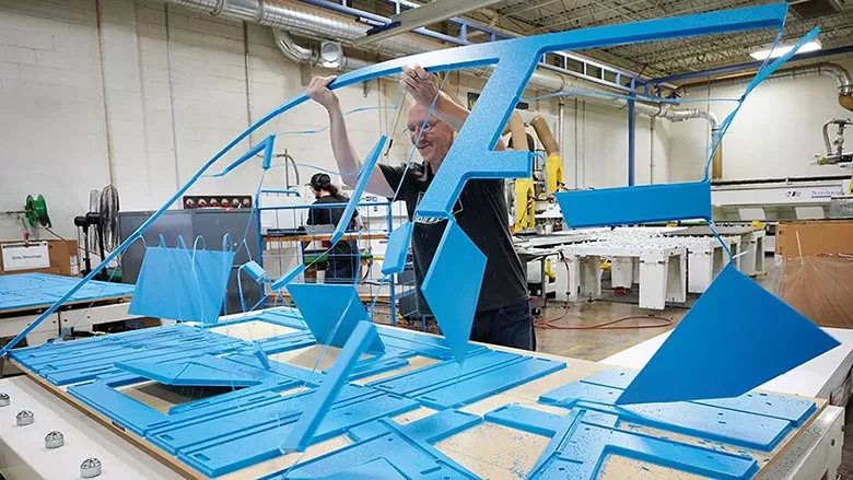

furniture manufacturing
Loll Designs manufactures durable, all-weather, outdoor furniture and accessories made with high density polyethylene. Photo courtesy Loll Designs
