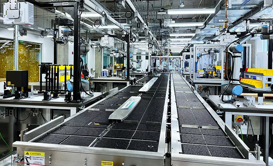

The Smart Factory Lab features an automated assembly cell and six “connected worker” cells (foreground). Photo courtesy Purdue University

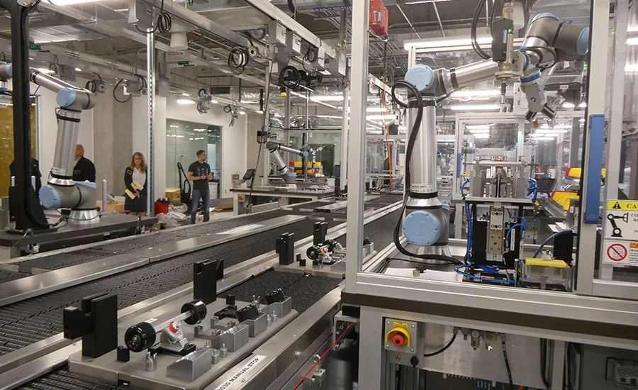

The assembly line is educational, but uses collaborative robots and other types of real-world manufacturing technology. Photo by Austin Weber

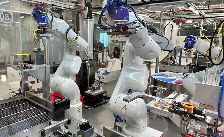

The automated portion of the assembly line features six-axis and SCARA robots. Photo courtesy Purdue University

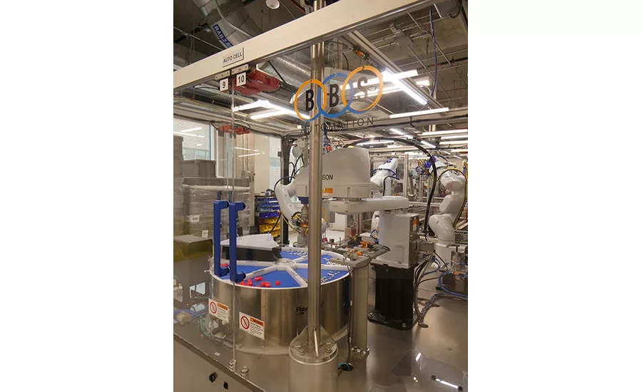

A flexible bowl feeder sorts wheels and other components. Photo by Austin Weber

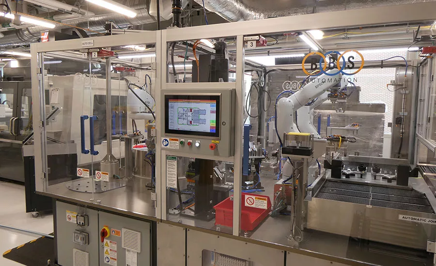

The heart of the Smart Factory is its assembly line, which was built by BBS Automation Chicago Inc. While it was building the system, the systems integrator invited several summer interns from Purdue to work on the project.
“We tried to design the system around Purdue’s curriculum,” says Chad Ross, senior sales engineer at BBS Automation. “That was very challenging, because they wanted us to design the assembly line to ‘work and break.’ Our system enables Purdue professors to program in flaws on purpose, which allows students to find problems and make necessary improvements.
“The focus of the assembly line is not about building products,” explains Ross. “It’s really about giving students hands-on experience with a working production line that generates lots of data for them to analyze and learn from. Students can pull data off the line and evaluate it, then make updates to make the process operate more efficiently.
“That was a challenge for us, because we always try to build machines and systems that are as solid, sound and bulletproof as possible,” notes Ross. “For educational purposes, Purdue wanted the opposite.”
“The idea is that the students get a real, physical experience with an actual production machine,” adds Jim Fikert, senior controls engineer at BBS. “For the students doing assembly, they can look at this automated process and say ‘Hey, how is it doing this task better?’ From there, they get software experience by performing optimization and debugging for the software.”
“They basically wanted a ‘restart button’ that enables professors to go into the controls and purposely let students in one class play with and break it, then turnaround and reset everything for the next class,” says Ross. “Therefore, we made some things redundant on purpose. That way, students can collect two sets of different data, correlate it and understand how it works.”

There is an automated cell that features one SCARA and three six-axis robots from Epson Robots and a flexible bowl feeder from Ars Automation. In addition, there are six lean, “connected worker” cells that use six cobots from Universal Robots. Assembly processes used include pressing and screwdriving.
The assembly line also has a fully automated pallet-based conveyor system from Shuttleworth, a Keyence 3D bin-picking system and an augmented reality visual guidance system from LightGuide. In addition, the system has various components from Bosch Rexroth Corp., Cognex, ESTIC America Inc., Ingersoll Rand, Markforged, OnRobot and Starline.
