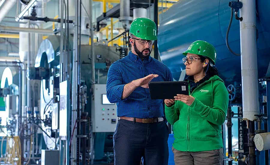

To troubleshoot, operators hold a tablet over a piece of equipment and critical data pops up in real time on the screen. Photo courtesy Schneider Electric

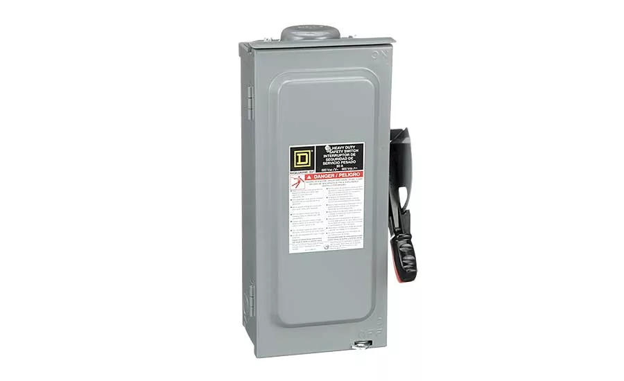

Schneider Electric Lexington has been making load centers and safety switches since Dwight D. Eisenhower was president. It opened in 1957, a year before the first issue of ASSEMBLY magazine rolled off the printing press.
Back then, the jet age had just begun and steam-powered locomotives were still in use on American rails. Polyethylene was a new-fangled material, and a world’s fair was about to be held celebrating atomic energy. However, cell phones, collaborative robots, cordless screwdrivers, laptop computers, paperless work instructions, RFID tags, torque sensors and other things that engineers take for granted today were unheard of.
When Schneider Electric Lexington celebrated its 50th anniversary, it was the recipient of ASSEMBLY’s 2007 Assembly Plant of the Year award. The vertically integrated facility was honored for its cost-cutting continuous improvement and lean manufacturing initiatives.
By implementing the Schneider Production System in the late 1990s, the plant achieved a 20 percent growth in volume between 2002 and 2006. The facility also spent a decade streamlining all areas of fabrication and assembly to remove 113 minutes of process lead time.
Quality Products

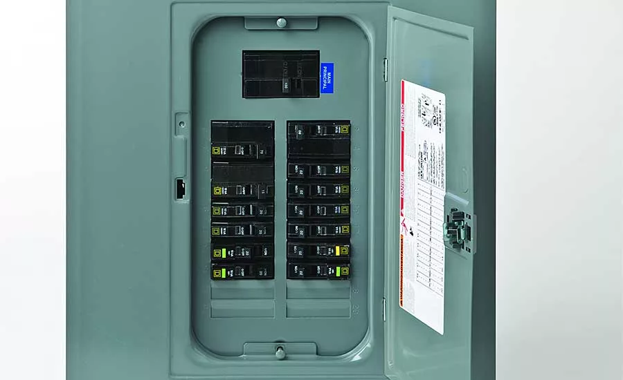

Today, the 64-year-old Schneider Electric Lexington plant is still going strong, producing more than 10,000 units a day. Every year, operators assemble 2.8 million load centers and 800,000 safety switches.
The metal boxes house an assortment of bus bars and other aluminum, copper and plastic components that distribute and control low-voltage electricity. Contractors and builders buy the boxes and electricians stuff them with different types of circuit breakers to protect homes from electrical overloads and short circuits.
It’s a simple solution to a potentially deadly problem. Although most load centers look the same, they’re not. A wide variety of options are available. In fact, assemblers at the Lexington plant build more than 200 different configurations of load centers. And, safety switches vary in size from 30 to 200 amps.

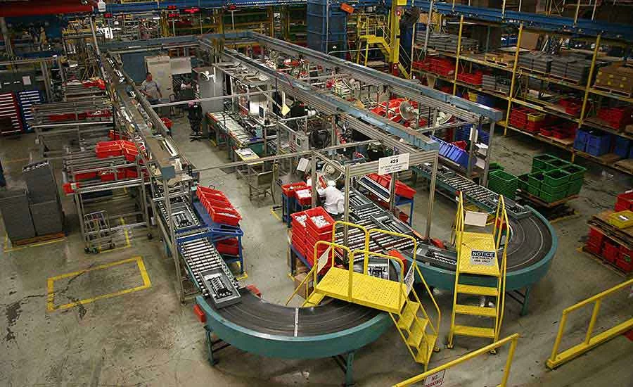

The plant’s semiautomated assembly process has evolved over the years from manual fabrication, assembly, packaging, batch processing, quality inspection and MRP scheduling to a facility supported by a multitude of lean manufacturing processes.
Over the past 30 years, a significant amount of capital has been invested to drive labor productivity, improve quality, increase capacity and reduce cycle time.
For instance, in 2008, Schneider Electric Lexington installed a $4 million power-and-free conveyor system that improved productivity and ergonomics by delivering painted parts directly to assembly workstations. The one-mile-long conveyor snaking through the plant eliminated manual palletizing and greatly reduced internal fork truck traffic.
“Conveyors have enabled us to streamline material handling,” says Luke Durcan, director of IoT and EcoStruxure at Schneider Electric. “The amount of work in process (WIP) has been significantly reduced to prevent blockages from the press department to welding and then from the paint shop to final assembly. RFID tags tied into a Magelis PLC enable us to track and synchronize WIP movement throughout the facility.”

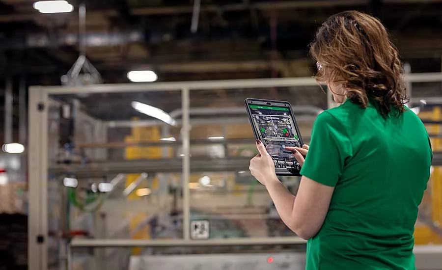

“If a technician or an operator on the shop floor has a problem, I get an alert,” explains Lyczkowski. “This make the assembly line more efficient and I have the ability to control my core processes remotely.”

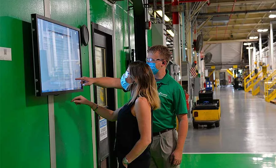

Today, the Lexington plant continues to drive efficiencies and establish new smart factory benchmarks. For instance, monitoring and analyzing energy usage has driven a savings of 3.4 percent year-over-year, contributing to $6.6 million in regional savings since 2012.
In addition, unplanned machine downtime has been reduced by nearly 6 percent through increased visibility into operations. And, 90 percent of paperwork has been eliminated.
Other impressive improvements include a 26 percent energy reduction, a 78 percent CO2 reduction in conjunction with renewable energy credits and a 20 percent water use reduction.

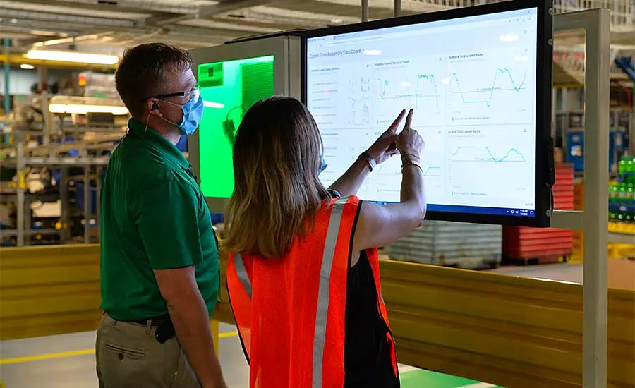

Schneider Electric Lexington has deployed a digital energy management strategy that leverages IIoT connectivity, edge-based descriptive analytics and cloud-based predictive analytics to drive efficiencies across the operation.
EcoStruxure technology forms the heart and soul of the Lexington factory. Schneider Electric’s proprietary system is a vendor-neutral, IIoT-enabled architecture that includes an open but tailored stack of connected products; edge control-level software; and cloud-based apps, analytics and services. End-to-end cybersecurity for supporting applications and data analytics are embedded across the EcoStruxure architecture.
This open architecture approach accommodates information technology and both Schneider Electric and third-party equipment and software.
At the connected products layer, EcoStruxure Augmented Operator Advisor (AOA) has enhanced operational insight and reduced equipment downtime by 20 percent. Residing at the edge, EcoStruxure Power Monitoring Expert utilizes connected meters and sensors to create powerful visualizations and descriptive analytics of energy consumption by machines and processes.
Cloud-based EcoStruxure Resource Advisor pulls granular plant data and provides a platform for energy management at a global level. It offers predictive insights to energy trends and spend patterns that enable manufacturing engineers to optimize their energy costs.

“Three years ago, we started to think about the Lexington factory as an integrated data architecture,” says Durcan. “To bring disparate systems together, we introduced a solution called AVEVA Insight. We created a hybrid manufacturing cloud environment that enables us to look at real-time information coming from our lean digitization system, which combines operator input data with production and MES information.
“Insight is very flexible, which makes it much easier to do data integration,” claims Durcan. “It uses standardized templates with customization that enables the plant to adapt. Operators get to manage data and create individual dashboards based on their unique needs. It enables us to get tools into the hands of the people who need them the most.”

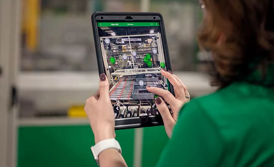

One recent addition, EcoStruxure AOA, digitizes machine information in an augmented reality format, and the data is viewable from a standard portable tablet. For instance, a maintenance technician can walk up to a piece of equipment and determine whether or not a cylinder has retracted inside the machine without ever having to open up the machine.
The tool provides information augmented over a real-time view of the machine and, more importantly, provides the latest set of schematics and documentation pertaining to that particular machine. As a result, technicians no longer have to spend time digging through a panel looking for print manuals that are often outdated.

“We’ve had great success in Lexington with AOA,” says Durcan. “This tool improves operational efficiency with augmented reality, enabling operators to superimpose current data, links to documentation and virtual objects onto a cabinet or machine via their tablet computer’s camera. EcoStruxure AOA puts real-time information at their fingertips, wherever and whenever it is needed.
“It provides overlays into asset performance, which has streamlined predictive maintenance,” explains Durcan. “This has enabled us to reduce mean time to repair at the Lexington plant by 18 percent.
