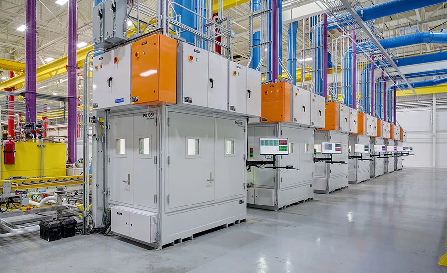

Electrification test facilities require battery simulators and emulators, chassis or power train dynamometers, and high-voltage charging systems.
Photo courtesy ACS Inc.

Consider, for example, a renovation to a manufacturer’s battery abuse test cell to expand battery testing capabilities. Using a systems integrator, the manufacturer was able to plan, design and build a 15,000-square-foot applications engineering lab to boost capabilities for testing components of bigger battery cells and modules consistently, safely and repeatedly.
The test cell upgrades serve as the foundation for the ongoing expansion of battery testing volume and capabilities for the company. With this renovation, this global manufacturer experienced an increased market share in e-mobility and other growing market segments.
