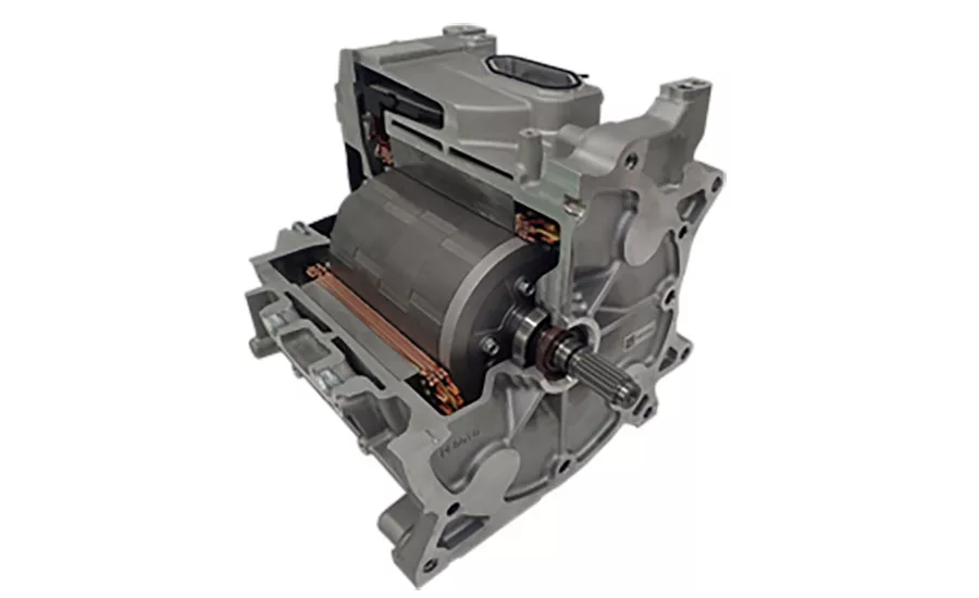

electric vehicle motor
Hitachi Astemo specializes in motors (above) and inverters. Photos courtesy Hitachi Astemo Ltd.

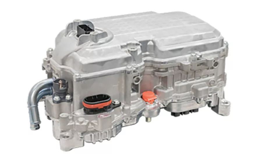

electric vehicle inverter
Hitachi Astemo specializes in motors and inverters (above). Photos courtesy Hitachi Astemo Ltd.

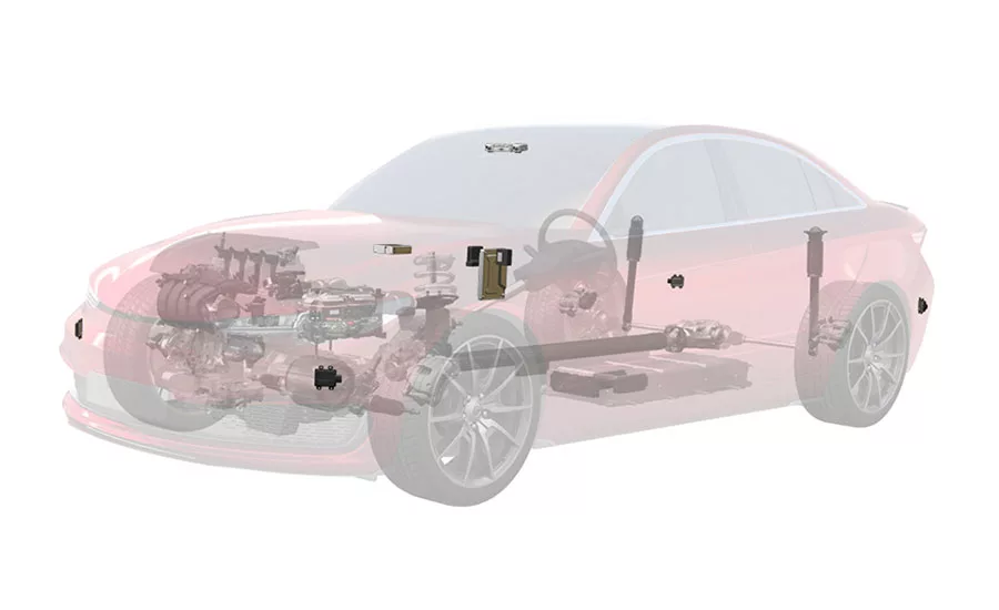

automotive systems
Hitachi Astemo supplies automakers with a variety of brake, power train and suspension systems. Illustration courtesy Hitachi Astemo Ltd.

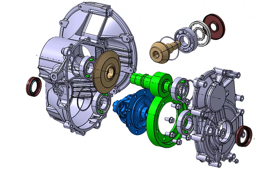

e-axles
A new line of e-axles that feature efficiency, low vibration, low noise and modular design. Illustration courtesy Hitachi Astemo Ltd.

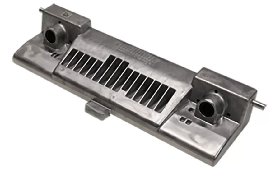

stereo cameras
Hitachi Astemo is a leading supplier of stereo cameras used for ADAS and autonomous driving applications. Photo courtesy Hitachi Astemo Ltd.

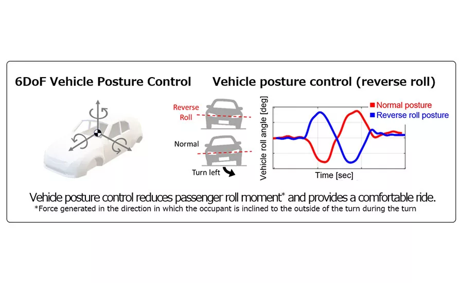

vehicle posture control technology
Vehicle posture control technology suppresses uncomfortable swaying during acceleration, deceleration and turning. Illustration courtesy Hitachi Astemo Ltd.

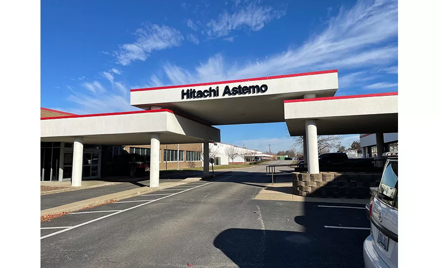

Hitachi Astemo’s factory in Berea, KY
Hitachi Astemo’s factory in Berea, KY, features state-of-the-art assembly lines that use the latest Industry 4.0 technology. Photo courtesy Hitachi Astemo Ltd.

Hitachi Astemo engineers have developed a line of e-axles that feature efficiency, low vibration, low noise and modular design. The technology includes optimization control software for motors and gears.
The engineers have also developed an inverter with industry-leading power density, thanks to its unique cooling module and small, thin, highly heat-dissipating insulation mounting technology. The component consists of power modules with built-in power semiconductors, control boards, capacitors and current sensors.
Electric motors are Hitachi's legacy product, and Hitachi Astemo has established a competitive advantage in torque density through the technologies it cultivated over the years—including material development, analysis, sound-reduction and manufacturing technologies—to develop magnetic circuits comprised of magnets, electromagnetic steel sheets and windings.

It also unveiled 360-degree sensing technology that uses multiple stereo cameras to measure distances by combining long-range detection with a wide viewing angle. It detects pedestrians and other objects with a high degree of accuracy, in addition to storing identification patterns in advance using artificial intelligence and machine learning.

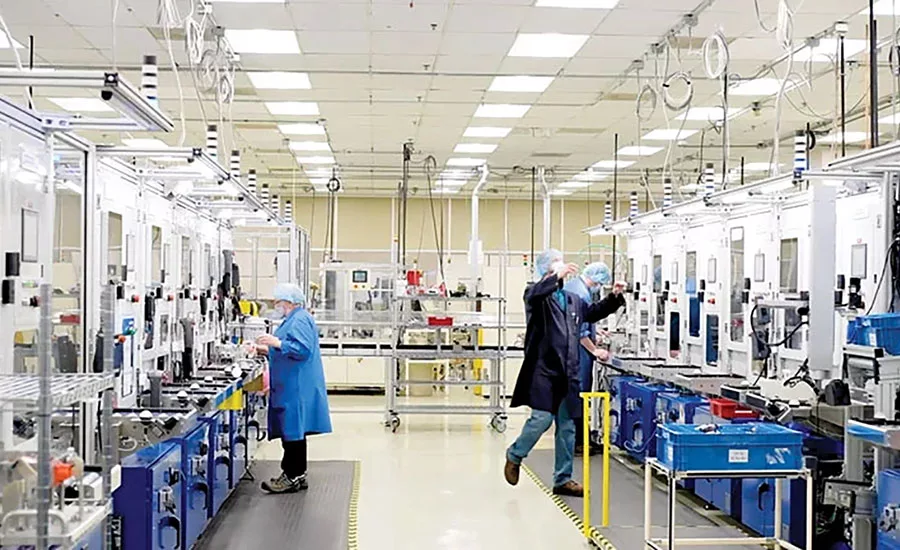

Nunneley: It has given us an opportunity to rethink our plants and production processes. Motors and power inverters are much different than many of the other products that we make. They’re larger, more complex and tougher to handle manually than brake and suspension parts. In the early stages, when volumes aren’t so high, we can do single-station batch builds of these products. But, as we ramp up to to higher volumes with EVs, it gives us an opportunity to create new assembly lines with Industry 4.0 tools, such as data collection and analysis, built in. That’s much better than adding them onto a legacy line. It’s easier to have things designed in at the beginning rather than trying to add them as we’re ramping up and running production. We can’t build a brake caliper and a motor on the same line. But, on the electronics side, we can build things such as battery pack control modules for EVs on the same surface-mount assembly lines as we build ICE engine controllers.

Nunneley: This facility currently makes suspension products. We’ve been adopting a lot of Industry 4.0 tools, such as data tracking, on equipment to observe and react to line performance, plus identify bottlenecks. The goal is to improve overall equipment effectiveness in the plant. We are also in the process of renovating part of the plant and installing new assembly lines for EV products. We started producing electric motors in 2022 and production will ramp up over the next few years.
