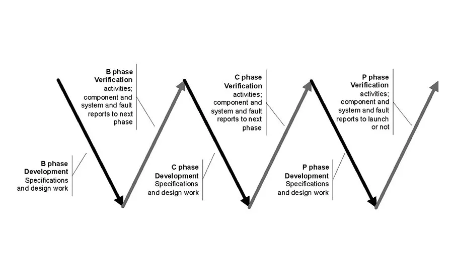

Vehicle manufacturers typically follow a specific workflow for product development: Define the system; define the components of the system; deliver an iteration of the product; learn from those iterations; adjust the documentation; and add heretofore unknown systems and components. Illustration courtesy Value Transformation

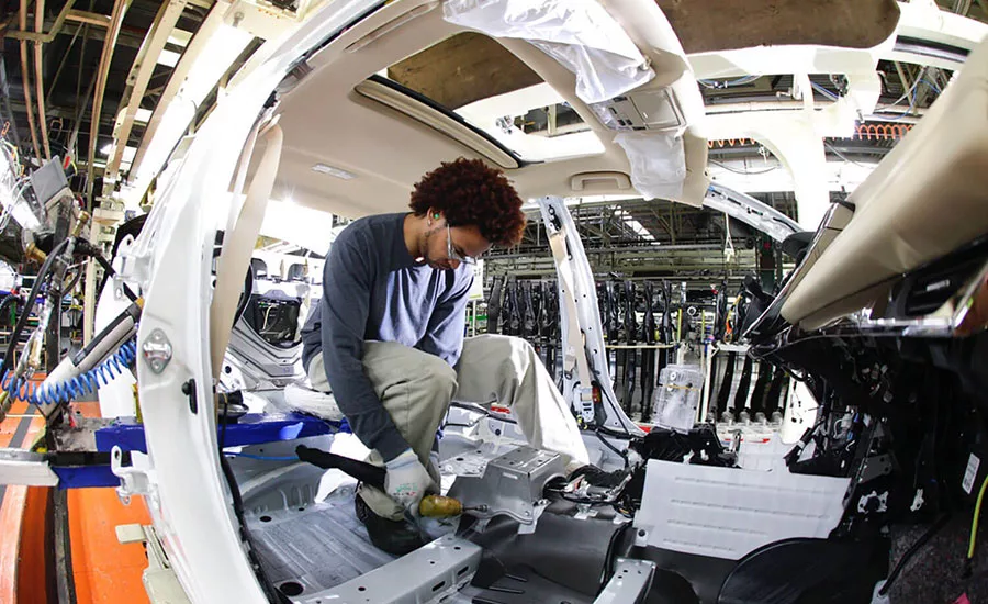

Chesterton’s Fence is a simple rule of thumb that suggests you should never destroy a fence, change a rule, or alter a tradition if you do not understand why it was created in the first place. Photo courtesy Toyota Motor Corp.

Long ago, I worked as a process manager for the development department of a vehicle manufacturer. The company had many processes, but our department’s understanding of those processes—who needed what, and when—were largely unknown.
As a vehicle manufacturer, we had a specific workflow for product development: Define the system; define the components of the system; deliver an iteration of the product; learn from those iterations; adjust the documentation; and add heretofore unknown systems and components.
This exercise allowed the refinement of specific department processes (for example, wire harness engineering) and artifacts. We then set about refining the process descriptions.
Since we didn’t necessarily know everything about a particular process, we had to be careful in making changes, and I was reminded of the concept of Chesterton’s Fence.
