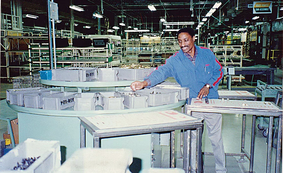

Creative thinking led to the development of this carousel system to help workers pick parts in a kitting application.

Here is an example of how a team I was leading went through the creative lean process to overcome a challenge at our assembly plant. Our product is only 85 percent complete when it leaves the factory. The remaining 15 percent of the assembly process is done by the dealer. Two associates pick and pack fasteners to ship to the dealer to complete the assembly.
The picking process was laborious. The associates picked parts from bins spread out on two 12-foot-long tables. The fasteners were packed in five numbered bags that corresponded to a certain part of the final assembly process. The associates would walk back and forth about four hours a day, filling 200 sets of these five bags. They did a great deal of walking to fill those bags!
Our first thought was to automate the system, but quotes ranged from $150,000 to $225,000. Totally out of the question. Then, we thought of implementing a vertical storage unit that could move the parts to the pickers, instead of the other way around. That solution would cost $85,000 to $110,000, which was also out of the question.
It was then that we got creative. One team member brought up the idea of a lazy Susan. He had recently eaten at a Chinese restaurant, and his table had a big lazy Susan in the middle. That was our inspiration. Could we design and build a round, rotating parts carousel that would bring the parts to the pickers and stay within our budget?
Fortunately, we had some mechanical engineers on our kaizen team. The team did some engineering to come up with size, rotation speeds and other specifications that we needed to make our idea feasible. Three weeks later, we had a fully functional carousel designed, fabricated and painted for a mere $6,800! It worked well, and the pickers loved it. Had the team not been open to a creative solution, the carousel idea would never have been brought up, much less implemented.
