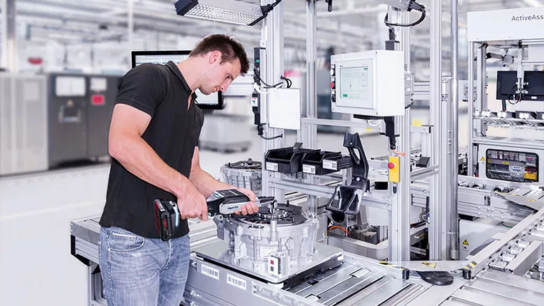

assembler using a Nexo cordless nutrunner
The Nexo cordless nutrunner has an advanced controller built directly into the tool.

Manual assembly can only be effective if it is as tightly controlled as automated manufacturing systems. The newest generation of high-performance, cordless fastening tools combines ease of use, ergonomic design and sophisticated digital intelligence to enable full-featured, “handheld automation” in manual assembly processes.
Such tools offer advanced capabilities, including:
  • Tightening a threaded fastener to defined parameters.
  • Automatically inspecting each operation via built-in sensors calibrated to national standards.
  • Digitally documenting every fastening operation.
  • Alerting the assembler if an error or deviation has occurred, enabling prompt remediation.
Intelligent tools provide the real-time data collection, quality monitoring, and precise, reliable, repeatable performance of Industry 4.0 technology, along with the flexibility of manual production.
Bosch offers four battery sizes, giving manufacturers the ability to use a heavier battery with a longer runtime or a lighter one to make it easier on workers. Photo courtesy Bosch Rexroth Corp.
