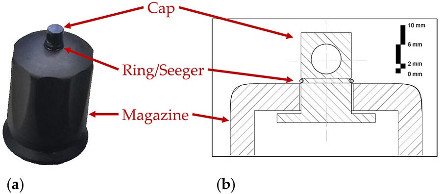

The OEM wanted to automate assembly of a subcomponent for a larger product. Assembly of the subcomponent was initially performed manually. Although the operations were straightforward, they consisted of repetitive tasks that were not considered value-adding by the manufacturer. Nevertheless, they were essential for completion of the product.
cross-section showing location of parts for subcomponent
An OEM wanted to automate assembly of a subcomponent for a larger product. The image on the left shows the assembled component. The image on the right is a simplified cross-section to show the location of the parts. Source: Marche Polytechnic University
The sequence of operations to assemble the subcomponent is as follows:
This diagram shows the sequence of steps in the automated assembly process. Source: Marche Polytechnic University
  1. Pick and place a cap.
  2. Pick and place a magazine.
  3. Pick and place a cone (a reusable tool for inserting a ring into a housing)
  4. Pick and place the ring.
  5. Insert the ring into its seat.
  6. Remove the cone from the assembly and reposition it on its base.
The cone is instrumental to the assembly process. It is used to guide insertion of the ring into the housing. The cone facilitates the elastic deformation of the ring as it is pressed towards the wider part of the cone. This process causes the ring to expand and conform to the dimensions of the housing. Upon insertion, the ring attempts to return to its original size, thereby securing the cap to the magazine through a clamping action.

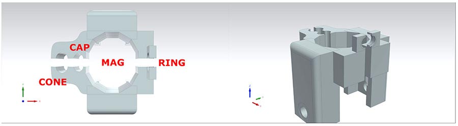

Design of the Fingers
The gripper fingers were designed to perform multiple tasks within a single setup. Developed using Siemens NX, the designs were exported in STL format for printing with the Formlabs 3 SLA printer. The fingers were printed using gray resin.
Description of the Functional Parts of the Gripper Fingers
Component Shape and Function Special Features
Magazine grip Irregular cylindrical, decagonal shape Adaptable to various positions
Cap grip Cylindrical with linear geometry Ensures secure and universal grip
Cone grip Negative form, narrow at base Prevents CONE from being pushed out
Ring grip Triangular and elliptical internal space Selects and grips small rings

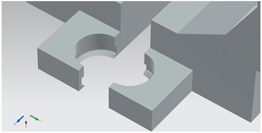

The gripper fingers were designed to perform the following tasks:
  • Magazine grip. The magazine has an irregular cylindrical shape. The adoption of a decagonal shape for the grip interface has shown practical effectiveness, as its geometry increases the contact points. This design advantage was observed through empirical testing, where the decagonal grip consistently accommodated various placements of the magazine, resulting in stable and secure handling without the need for precise positioning.
  • Cap grip. The cap grip uses a similar principle to the magazine grip. With the cylindrical shape of cap, a linear geometry aids in ensuring a more secure and universal grip.
  • Cone grip. The cone grip is designed for interference with a negative form fit. To ensure a firm grip on the cone and prevent it from being pushed outward, the negative form is designed narrower at the base and wider towards the top. Forces at play tend to push the cap upwards, which is then blocked by form interference. This part of the fingers also serves to push the ring into its final seat. Being narrower at the base ensures that the ring does not get trapped inside the cap.
  • Ring grip. This component is the most critical, because it’s so small (outer diameter of 9 millimeters and thickness of about 0.7 millimeter). This makes it difficult to grip. To make them easier to grip, the rings are inserted onto a special holder, lined up one above the other. The open gripper is brought into position over the holder and then closed. The lower triangular geometry of the gripper selects only one ring, and the inner space of the housing allows only one ring to enter. Furthermore, the internal space is elliptical, not circular, to accommodate the ring and allow for slight deformation. The ring is then transported and inserted into the upper part of the cone, already positioned over the previously assembled component. The ring is released and, with the seat of the cone, is pushed into its final position.
Normally, no more than 3 kilograms of force is necessary to seat the ring, but various types of friction can increase the force to unacceptable levels. Additionally, during this phase, the cap and the gripper must be vertically aligned, since misalignments can lead to an increase in insertion force that could exceed the robot’s 10-kilogram payload or even break the gripper. This could be avoided through force-control technology.
gripper fingers
The gripper fingers were designed to perform multiple tasks. The left images shows a top-down perspective, highlighting the central decagonal hole for gripping the magazine. The right image shows the hole for the cap and a conical hole for gripping the cone. Source: Marche Polytechnic University
