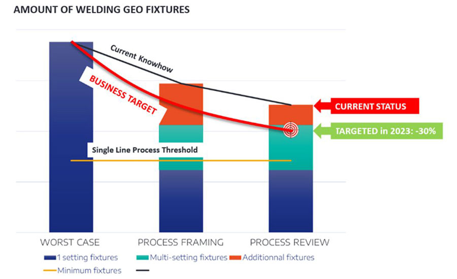

As an example, the geometric design of the welding process significantly influences cost efficiency. Consider the overall costs of the fixtures needed for assembly. In the theoretical worst case, each assembly would require its own set of fixtures. However, our expertise allows us to reduce costs by designing some fixtures that can accommodate more than one vehicle model and additional fixtures where necessary.
During the process review phase for a recent model change, we determined that we could further reduce costs through optimization activities, thus decreasing the number of additional fixtures required on the body-in-white (BIW) line. Our target was to reduce the number of unique fixtures by 30 percent by the end of 2023.
overall costs of geometric fixtures for assembly
This graph compares the overall costs of geometric fixtures for assembly: worst case (only unique fixtures), process framing phase (some multi-use fixtures and some unique fixtures), and process review phase (minimal number of unique fixtures). Our goal was to reduce the number of unique fixtures by 30 percent. Source: AutoForm Engineering GmbH

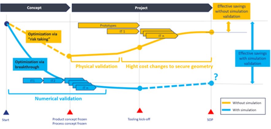

Simulation proves invaluable in reaching our business objectives. Without simulation, we face limitations in the number of possible validation loops for our assembly processes, and each loop typically consumes a substantial amount of time as it relies on physical validation. By that point, it’s often too late for significant product changes, and any geometry optimization necessitates costly mechanical corrective actions that also adversely affect time to market.
Assembly simulation allows us to evaluate concepts early, reduce validation loop durations, and increase their frequency, significantly influencing the product and process during a phase when optimization possibilities abound and ultimately reducing production risks.
benefits of using simulation for assembly processes assessment
This graph shows the benefits of using simulation for assembly processes assessment. The yellow line shows the process without simulation. Corrective actions occur during tryout when change costs are high. The blue line shows the process with simulation. Corrective actions can be evaluated during engineering, when change costs are lowest, resulting in greater savings overall. Source: AutoForm Engineering GmbH
Without simulation, process optimization becomes less ambitious since the opportunities to mitigate risks during physical validation are limited. Actual gains remain marginal because the few optimization loops secured during validation come at high costs to minimize time to market.
