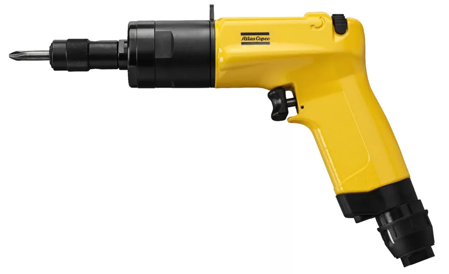

There’s still a role for pneumatic screwdrivers and nutrunners on the assembly line.
