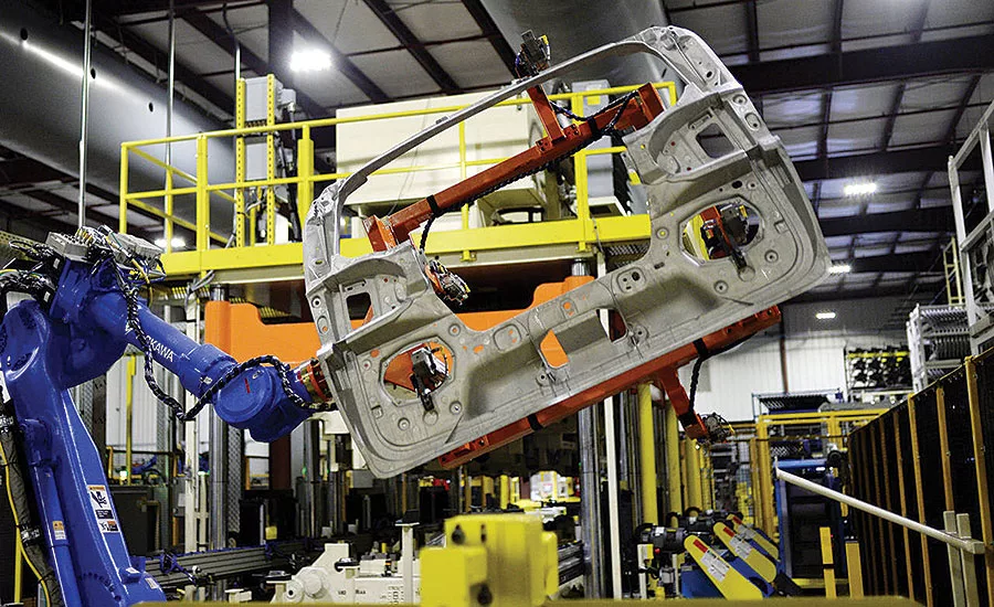

Efforts to reduce vehicle weight have mostly focused on aluminum, plastics and composites, but another lightweight material is also getting attention: magnesium. The ninth most abundant element in the universe, magnesium is as strong as steel, but 33 percent lighter than aluminum, 60 percent lighter than titanium, and 75 percent lighter than steel.
Worldwide demand for magnesium is growing steadily at a rate of 3 percent annually, driven primarily by the automotive industry. According to market research firm Ducker Worldwide, the average light vehicle contains some 10 pounds of magnesium, and that amount could triple by 2025.
Automakers are using magnesium for a variety of components, including instrument panel frames, seat frames, steering wheels, gearbox and air bag housings, closures, brackets, front-end carriers, engine cradles, engine blocks and even structural components. Fiat Chrysler Automobiles is using magnesium for the rear liftgate of its 2017 Pacifica minivan. General Motors recently introduced a new thermal-forming process and corrosion resistance treatment that will enable the automaker to use magnesium sheet metal for rear deck lids, body panels and other parts.

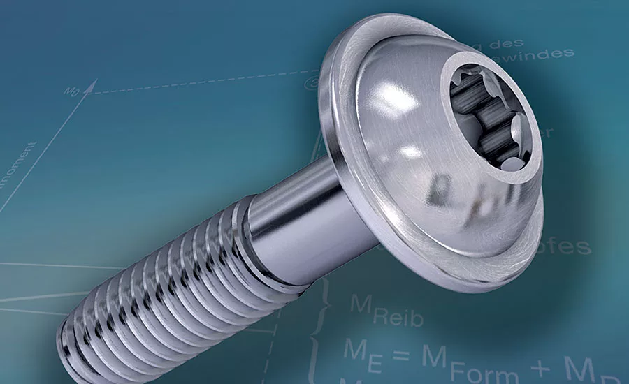

Several thread-forming screws have been designed specifically for magnesium parts.
One example is the Mag-Form screw from Acument Global Technologies Inc. It has a pentagonal shank profile, widely spaced threads, and a broad, 105-degree flank angle. When driven into magnesium, a compressive action forms strong threads with minimal debris generation. The large flank angle allows the fastener to be inserted and removed multiple times without damaging the threads.
“The Mag-Form fastener moves the material out and compresses it,” says Tripp.
Because they produce minimal debris during installation, Mag-Form fasteners are ideal for critical applications, such as steering components and air bag modules.
Another option is the ALtracs Plus thread-forming screw from EJOT. The fastener has a unique thread geometry that provides greater shear area between threads, resulting in higher pull-out and strip-out performance.
The threads have a 33-degree asymmetrical flank angle (a 22-degree load flank angle and an 11-degree back flank angle). This minimizes the amount of material the threads displace, says Tripp. Flank root support gives stability to the thread in high clamp-load conditions without hindering material flow during thread forming.
A round body shape provides greater thread engagement than multilobular fasteners, which improves clamp retention and ensures long-term joint strength.
The thread-forming zone consists of a tapered, noncircular point with thread-forming relief flats. The taper helps assemblers align the screw in the hole and decreases the amount of force and torque needed to start the thread-forming process. The flat areas in the thread provide relief during thread-forming, which reduces drive torque.

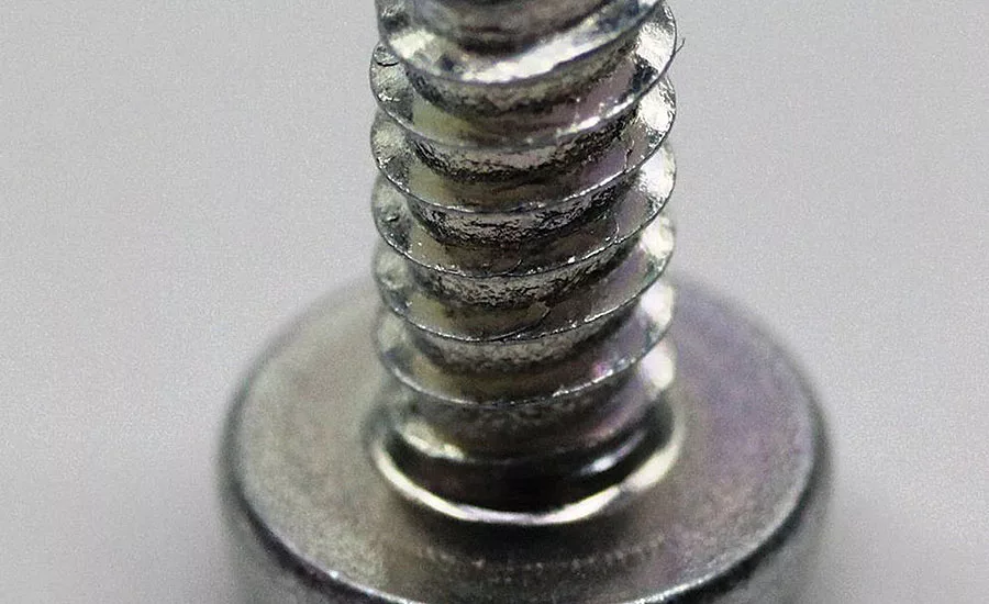

The ALtracs Plus is interchangeable with machine screws. As a result, the fastener can be used in existing tapped machine screw threads of the same size, or alternately, a machine screw of the same size can be used in the thread formed by an ALtracs Plus fastener, eliminating any field service concerns.
A third thread-forming screw for magnesium is the Magtite 2000 from Research Engineering & Manufacturing Inc. This fastener has a trilobular shaft with radiused threads instead of angled ones. The trilobular shape provides low thread-forming torque and high failure torque. The rounded thread creates a clean, uniform internal thread by compressing the magnesium rather than displacing it. This minimizes debris creation and allows the screw to be removed and reinstalled multiple times.
As a variation, Nitto Seiko offers the Magtite CP. Nitto applies a polymer coating to the bottom half of the fastener that captures even the small amount of chips that might be created during the thread-forming process. This can be critical for electronics assembly applications, where even minute metal particles could cause a short circuit.
