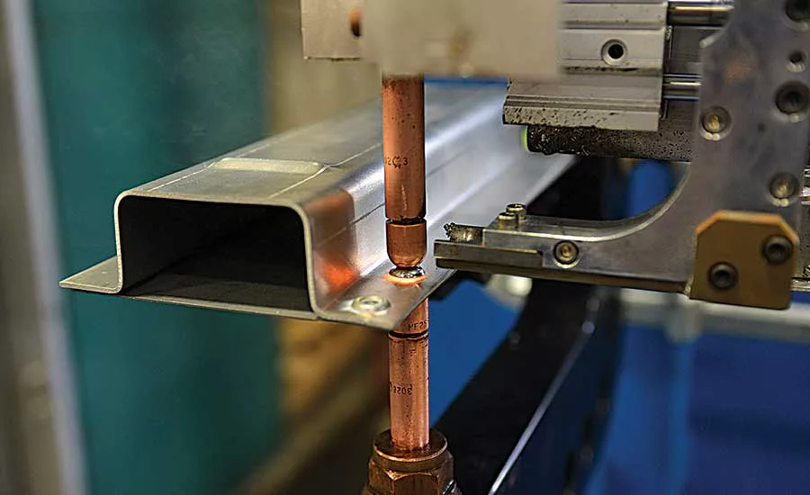

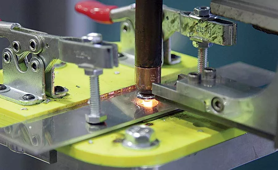

To create a joint, two or more sheets are placed between the electrodes of a standard spot welding system. The upper sheets have holes for the rivet. The bottom sheet does not. At the start of the cycle, a feeder delivers a rivet beneath the upper electrode. Next, the electrodes apply force and current to the rivet and bottom sheet, creating a weld. Photo courtesy Arconic Fastening Systems and Rings

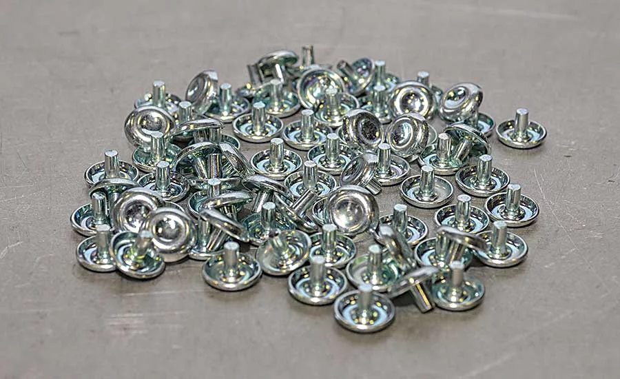

The RSR rivet is a small, mushroom-shaped fastener made from low-carbon steel or aluminum. Photo courtesy Arconic Fastening Systems and Rings

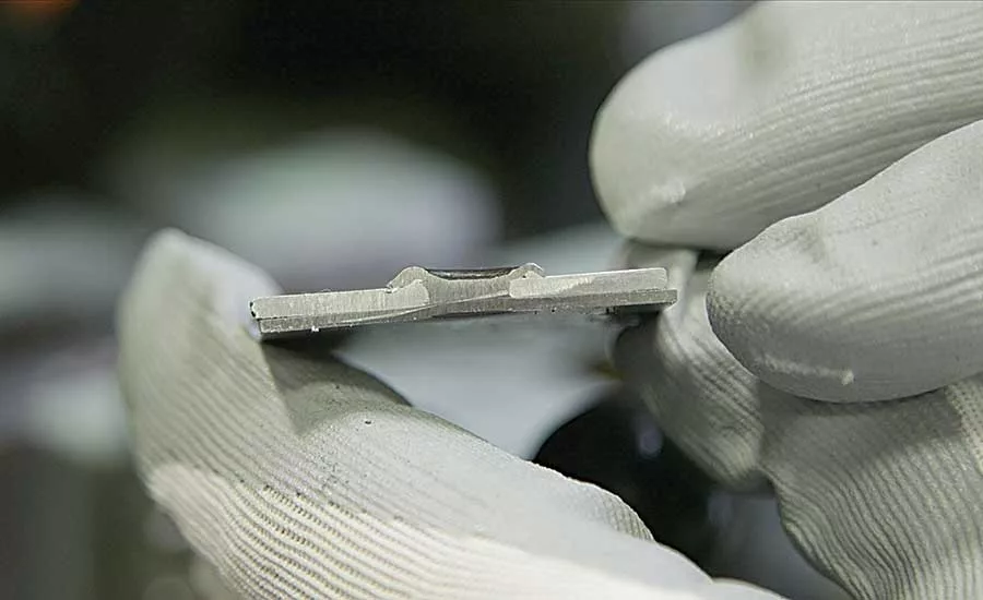

In RSR, the weld is between the fastener and the bottom sheet. The top sheets are not electrically involved. Rather, they are mechanically captured by the head of the fastener. Photo courtesy Arconic Fastening Systems and Rings

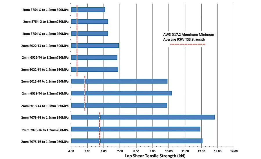

The RSR process exceeds the strength of competing technologies for current and future automotive materials, such as high-strength aluminum and ultra-high-strength steel. Photo courtesy Arconic Fastening Systems and Rings

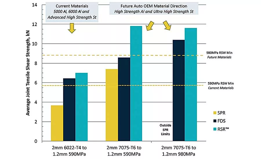

The RSR process was developed as a way to join mixed-material assemblies in auto body applications, such as aluminum to steel. This graph shows the tensile strengths created when a steel rivet is used to attach various aluminum alloys to a steel sheet. Photo courtesy Arconic Fastening Systems and Rings

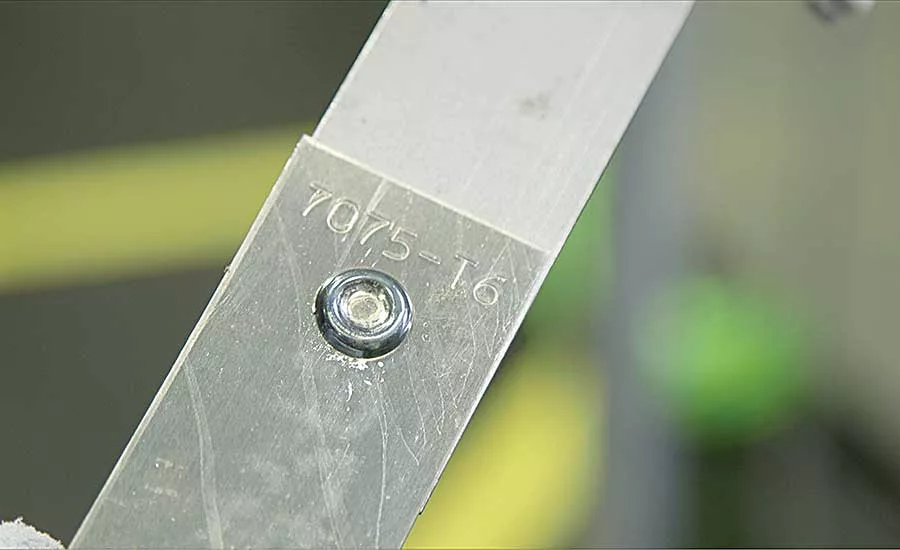

RSR works with existing spot welding equipment, enabling OEMs to weld or rivet joints without revamping their body lines. Photo courtesy Arconic Fastening Systems and Rings

The RSR rivet is a small, mushroom-shaped fastener made from low-carbon steel (electroplated with zinc for corrosion protection) or aluminum. Which material to choose depends on the bottom sheet—the steel rivet for steel sheets and the aluminum rivet for aluminum sheets.
The head of the steel rivet is 14.2 millimeters in diameter and 2.7 millimeters thick. The stem is 4 millimeters in diameter. Three stem lengths are available—3, 5.5 and 6.8 millimeters—for joining a top sheet (or sheets) with a total thickness of 0.5 to 4 millimeters. A steel rivet with a low-profile head is also available. The head is 11 millimeters in diameter and 1.8 millimeters thick. Stem length is 5.5 millimeters.
The stem of the aluminum rivet is 8 millimeters in diameter and 3 millimeters long. Its head is 14.3 millimeters in diameter and 2.5 millimeters thick. It can join a top sheet (or sheets) with a total thickness of 0.5 to 2 millimeters.

To create a joint, two or more sheets are placed between the electrodes of a standard spot welding system. The upper sheets have holes for the rivet. The bottom sheet does not. At the start of the cycle, a special compact feed unit delivers a rivet beneath the upper electrode. When the weld cycle is initiated, the feeder retracts, and the electrodes apply force and current to the rivet and the bottom sheet, creating a weld. Total cycle time is 3 to 5 seconds, which is comparable to a traditional spot weld.
The weld is between the fastener and the bottom sheet. The top sheets are not electrically involved. Rather, they are mechanically captured by the head of the fastener. As a result, the top sheets can be any material: similar or dissimilar, painted or unpainted, conductive or nonconductive. As long as the total thickness of the top sheets matches the grip range of the fastener, the sheets can be any combination of steel, aluminum, carbon fiber, glass-reinforced composite or plastic.
There’s no limitation on the thickness of the bottom sheet. “Obviously, there are practical limitations,” says Musgrove. “You’re not welding a thin sheet to a 1-inch thick plate. But in general, the process is not sensitive to the thickness of the bottom sheet, because you’re not passing through the bottom sheet. You’re only contacting it, making a weld on the top side.”
The rivet head is designed to match the shape of existing electrodes and to center the fastener on the weld spot. The spot welder has a standard radiused electrode on the top side and a truncated electrode on the bottom side to provide a flat, aesthetic joint.
“The key parameters are force and current, just like with any spot welding process, so the weld schedules are very similar,” says Musgrove. “If your spot welding system is capable of welding the joint now, it can handle RSR. It does not require any additional force or current capabilities.
“In fact, aluminum RSR actually requires less current than a standard aluminum-to-aluminum spot weld, which saves on power consumption,” he adds. “Traditionally, an aluminum-to-aluminum spot weld would take a lot more current than a steel-to-steel weld. But, because there’s a fastener in the joint, it focuses the current, allowing you to make the welds at levels lower than those for traditional spot welding of aluminum.”
As for joint design, the same considerations that apply to resistance spot welding apply to RSR. Design rules for edge distance and spot-to-spot spacing are similar for both processes. “Any joint strength that you can get from a spot weld, we can get from RSR,” says Musgrove.
In most cases, the top sheets must have holes for the fastener. However, if the bottom sheet is steel and the top sheet is aluminum, then the top sheet does not necessarily require a hole.
“The steel RSR will actually extrude its way through the aluminum top sheet and still make a good weld,” explains Musgrove. “I would say, though, that [not having a hole] should be more of a fallback plan, because it does reduce grip range and increase cycle time. If the rivet pilots through the top sheet, the cycle time is about twice the time required than with a hole.”
In most cases, the RSR process requires access to both sides of the assembly. However, it is possible to create joints with access to only one side, as when welding a sheet to a tube. It’s also possible to weld three or more sheets together. “For example, in one of our test stack-ups, an aluminum top sheet is joined to two steel bottom sheets. The fastener welds to the top steel sheet first and then welds to the bottom sheet.”
