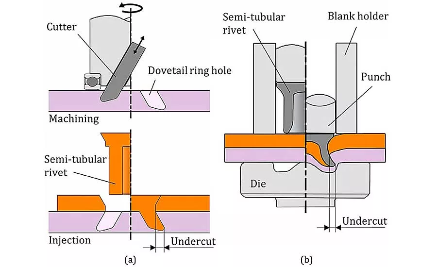

Self-pierce riveting (right) is a cold joining process for fastening two or more sheets of material. During assembly, the rivet is driven into the material stack at a controlled force, piercing the top layer or layers. The rivet radially expands into the bottom layer or sheet, under the influence of a die, forming a strong mechanical interlock. The rivet does not break through the last material.
Injection lap riveting (left) is similar, but its joining principle is based on plasticity and friction without fracture and formation of the surfaces. The process involves two consecutive operations. First, a dovetail ring hole is machined in the lower sheet. Then, a semitubular rivet is pressed through the upper sheet into the hole in the lower sheet.

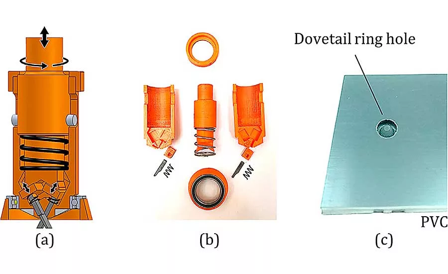

For their injection lap riveting process, the researchers invented a new cutting tool. It consists of two inclined cutters controlled by springs that will progressively open to deepen the dovetail holes as the upper table moves down. The tool can be easily attached to a drilling machine or milling machine.

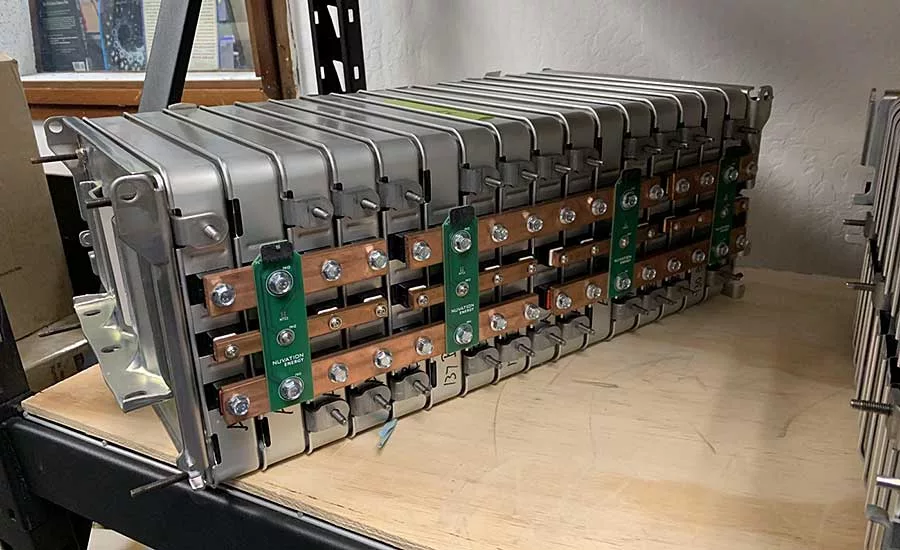

Bus bars are an essential component of electric vehicles. This metallic strip or bar efficiently distributes electrical power from high-energy battery packs to electric motors and other devices. Usually uninsulated, bus bars must have sufficient stiffness to be supported in air by insulated pillars. This helps cool the conductors and enables engineers to tap in at various points without creating a new joint.

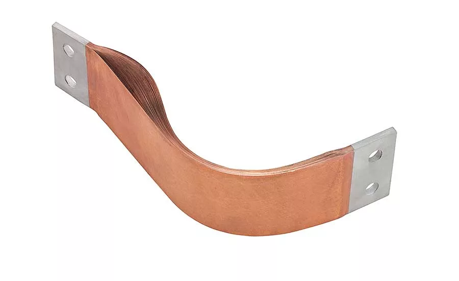

Bus bars are typically produced by stamping copper sheets. However, because aluminum is both lighter and cheaper than copper, engineers would like to use that metal for bus bars. The only problem with that idea is that aluminum has less current-carrying capacity and higher impedance than copper due to its greater electrical resistivity.
To get the best of both worlds, engineers are developing bus bar assemblies that use both metals. These hybrid bus bars combine the excellent electrical conductivity of copper with the low density and cost of aluminum.

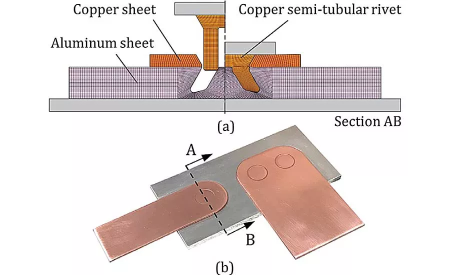

Now, Martins and his research team have introduced another new method for joining copper to aluminum: injection lap riveting. The new technique can be used to assemble hybrid bus bars or any other application involving two overlapping metal sheets.
The process is carried out in two stages at ambient temperature. First, a dovetail ring hole is machined in the lower sheet. Then, a semitubular rivet is injected through the upper sheet into the dovetail hole of the lower sheet to obtain an interlocking connection. The working principle is based solely on plasticity and friction, in contrast to self-pierce riveting, which relies on plasticity, friction and fracture to allow the rivet to create an undercut while it is pierced through the sheets.

The cutting tool consists of two inclined cutters controlled by springs that will progressively open to deepen the dovetail holes as the upper table moves down. The tool can be easily attached to a drilling machine or milling machine. The design of the tool is flexible and allows easy and fast replacement of the inclined cutters for sharpening.

Next, the researchers installed the rivets into the holes with a press. After assembly, some test joints were halved lengthwise for cross-sectional analysis. Some joints were subjected to pull-out and shear tests, and other joints were tested for current flow.

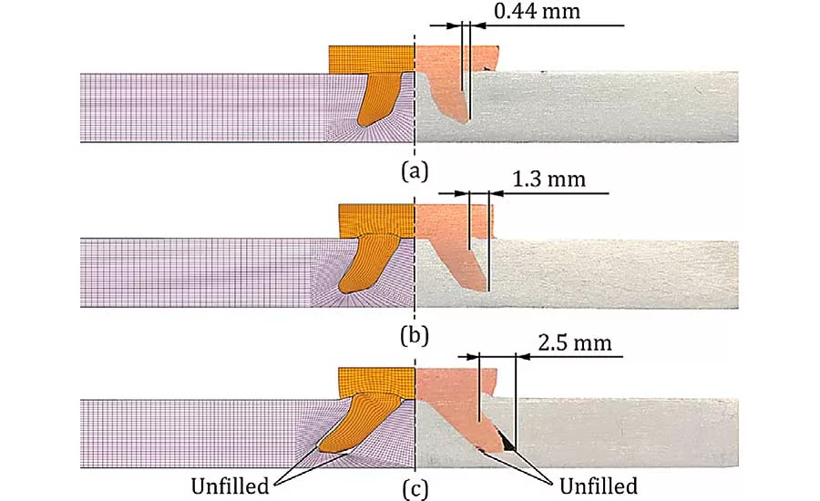

The researchers found that the dovetail holes in the aluminum sheets behave as die cavities into which the shank length of the rivet flowed. The rivet completely filled the holes with inclination angles of 15 and 30 degrees, but unfilled material pockets were visible in the holes with an inclination angle of 45 degrees. These pockets result from deformation of the hole and are not critical if the joints are to intended for purely mechanical connections. However, such pockets are detrimental for electrical connections, as in hybrid bus bars, because they create additional resistance to current flow.
Although the undercut is larger for the 45-degree inclination angle, the unfilled material pockets justify the choice of smaller inclination angles, such as 30 degrees, says Martins. Smaller inclination angles are also advantageous since less force is needed to install the rivet.
Shear and pull-out testing revealed that holes with a depth of 4 millimeters outperformed holes with a depth of 3 millimeters. The maximum forces that were measured in both tests correspond to collapse by shearing or by detachment of the rivets from the sheets.
