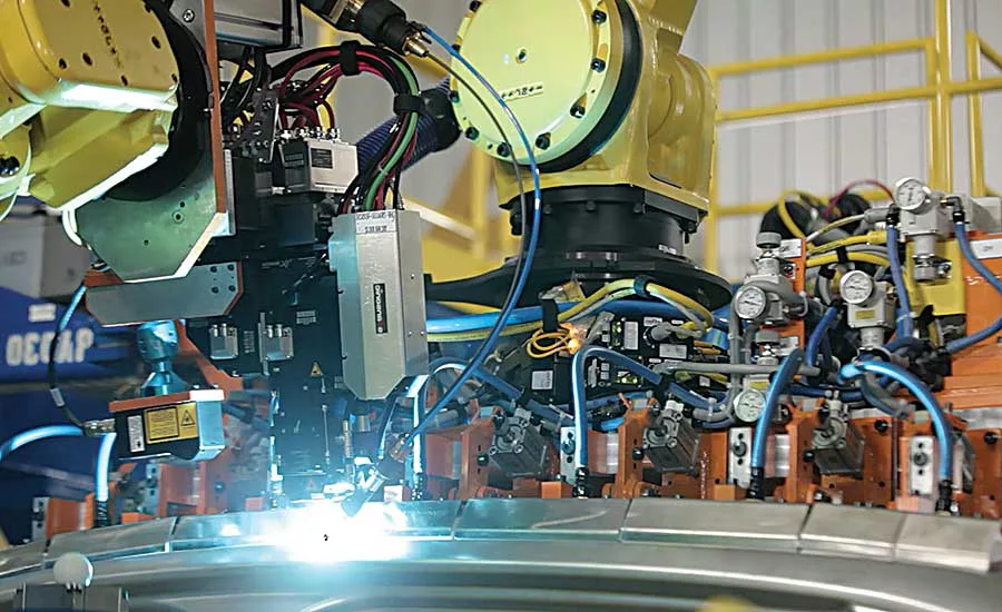

GM engineers use resistance spot welding to attach steel and aluminum components for the Cadillac CT6 sedan. Photo courtesy General Motors

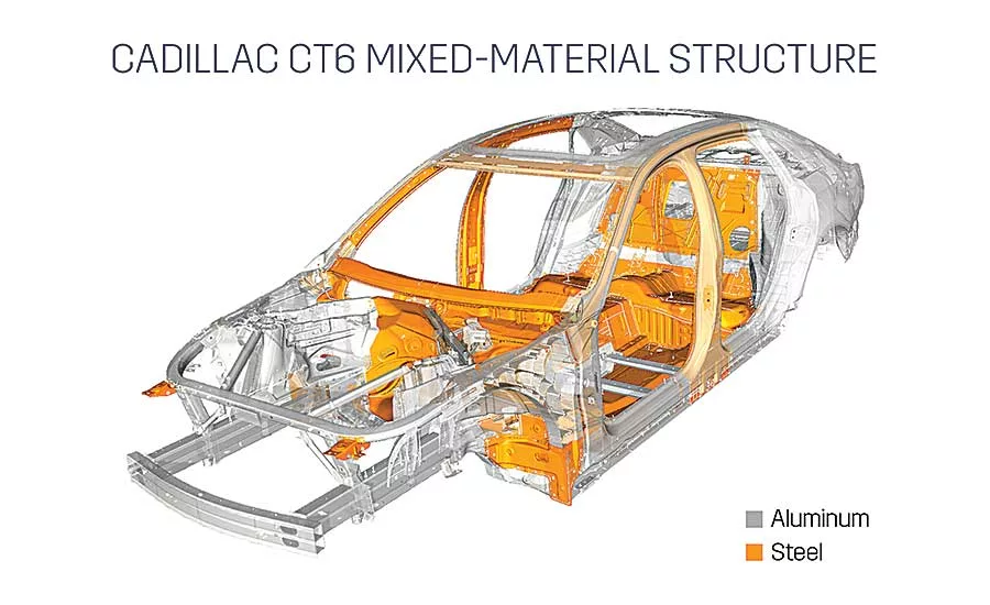

The body structure of the Cadillac CT6 sedan features a wide variety of steel and aluminum components. Illustrations courtesy General Motors
New Techniques for Joining Steel and Aluminum
The body structure of the Cadillac CT6 sedan features a wide variety of steel and aluminum components. Courtesy General Motors

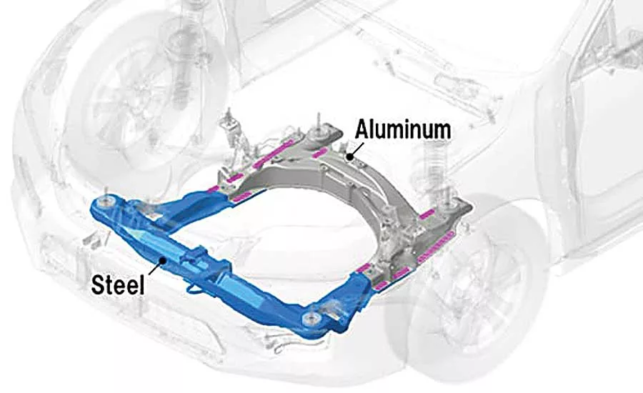

Honda uses friction stir welding to join aluminum and steel subframe components of the Accord sedan. Illustration courtesy Honda Motor

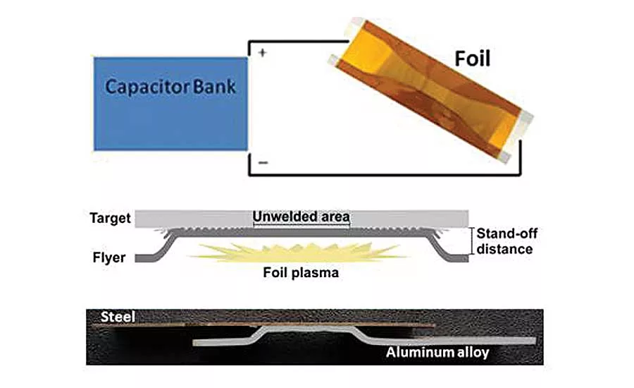

In the near future, vapor foil actuator welding may be used to assemble steel and aluminum automotive components. The new joining technique uses less energy than resistance welding, yet creates stronger bonds. Illustration courtesy Coldwater Machine Co.

"Welding offers the quickest cycle times for assembly," claims Eff. "Welds can occur in as little as 300 milliseconds when joining aluminum to steel using resistance welding or friction welding. Once the weld is made, it is instantly structurally stable and ready for the next step in production.

“Solid-state welding offers the best joint strength when welding aluminum to steel,” says Eff. “The friction welding family (inertia, direct drive and linear friction welding ) have produced aluminum to steel joints that exceed the strength of the aluminum alloy. Resistance spot welds are also capable of joining aluminum to steel, with a slight strength knockdown when compared to solid-state joining.
“Friction stir welding is an excellent choice when a continuous linear joint is required,” explains Eff. “Traditional fusion processes, such as arc welding and laser welding, produce large intermetallic layers and thus are typically poor choices for joining aluminum to steel.”
Friction welding creates mechanical friction between workpieces in relative motion to one another, heating the materials until they reach a plastic state (non-melting) at the joint interface. The materials are then forged together by force, creating a joint.
“A major advantage of [this type of] welding is that it allows dissimilar materials to be joined,” claims McCaughey. “Normally, the wide difference in melting points of the two materials would make it impossible to weld using traditional techniques, and would require some sort of mechanical connection.”
According to McCaughey, friction welding provides a full-strength bond with no additional weight. “It offers numerous benefits over other joining techniques, including elimination of filler metal or flux, higher quality joints, a very small heat affected area and no coarse grain formation,” he points out.

Coldwater Machine is currently partnering with the Impulse Manufacturing Laboratory at Ohio State University to commercialize its Vapor Foil Actuator Welding (VFAW) technology.
“With the VFAW process, an aluminum foil actuator is electrically vaporized by means of a capacitor bank,” says McCaughey. “This rapid vaporization generates a high-pressure pulse, which drives one metallic workpiece toward the other at extremely high speeds, with the resulting impact causing the metals to weld together, forming an atomic bond upon contact. The technique uses less energy than resistance welding, yet creates stronger bonds.”
The VFAW process has been used to successfully join different combinations of aluminum, copper, iron, magnesium, nickel and titanium. The goal is to have a system commercially available within two years.
