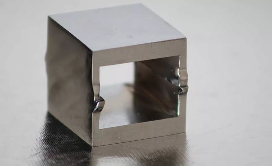

A major advantage of low-force friction welding is that it produces little or no flash. Photo courtesy Manufacturing Technology Inc.

A major advantage of low-force friction welding is that it produces little or no flash. Parts joined with conventional friction welding will have flash around the joint circumference. Though flash does not functionally affect the joint, it can be an aesthetic concern. As a result, manufacturers typically opt to remove the flash or design the parts to hide or contain the flash.
That’s not an issue with low-force friction welding. By varying the amount of heat and motion applied to the parts, engineers can limit flash so that little or no post-process machining is necessary.
“With low-force friction welding, you can make very low upset welds—they take on more of a bulge shape, as opposed to the flash curl typically generated by traditional friction welding,” says Adams.
For example, if conventional friction welding is used to join two metal tubes, engineers may need to remove the flash curl on both the outer and inner diameter of the joint. That can be complicated and expensive. With low-force friction welding, the joint might simply be a bulge.
“If you do choose to remove the flash, we can create a flash geometry that’s much easier to remove by manipulating the parameters of preheat, force and relative motion,” says Adams. “This would be especially useful for applications such as drill pipe or hydraulic cylinder rods.”
Less flash is also a benefit when welding blades to discs in aerospace applications. “When you join the blade to the disk with linear friction welding, you are left with a jagged ribbon of flash. The bulky flash reduces tooling space and makes it more difficult to add additional blades—especially the final blade,” explains Adams. “If you use low-force friction welding to join the blades to the disk, you instead get a bulge, which is contained in the weld collar. The bulge is smaller and less obtrusive, making it much easier to machine afterwards. It also frees up space for tooling.”
