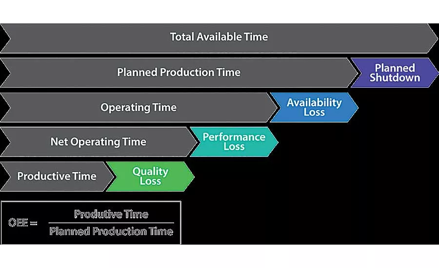

Before we delve into OEE and how to best calculate it, let’s briefly discuss the various time categories involved in the equation.
The first is “total available time.” This is the time that the plant is open and theoretically could be producing goods.
The second is “planned production time.” This is total available time minus planned shutdown time. Planned shutdown time could include meal breaks, holiday shutdown and scheduled maintenance.
The third is “operating time.” This is the difference between planned production time and the time lost to downtime. Downtime events include equipment breakdowns, unscheduled maintenance, setup time and changeover. This is included in calculating OEE.
The fourth is “net operating time.” This is the difference between operating time and time lost to a reduction in speed. Speed reduction events include operating equipment at below rated speed (increased cycle time), frequent short-lived stoppages not requiring maintenance, and certain operator errors. This is also included when calculating OEE.
Lastly, there’s “productive time.” This is the difference between net operating time and the time lost to quality issues. Quality loss includes rejected and reworked products. This, too, is included when calculating OEE.
How Is OEE Calculated?
By definition, OEE is the product of availability, performance, and quality percentages:
OEE = Availability * Performance * Quality.
Availability is a measure of downtime losses. Performance is a measure of speed losses. Quality is a measure of defect losses.
Each one of these OEE components represents losses that result in a reduction of operating time. We begin with total available time and subtract time losses due to availability (downtime), performance (speed), and quality (rejects and rework). Very quickly, one can see the effects of these losses on production time.
By definition then, productive time is a fraction of total available time. By measuring and understanding the losses, we can take the actions necessary to increase productive time as much as possible.
