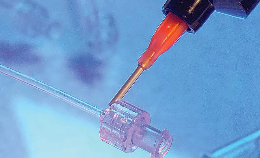

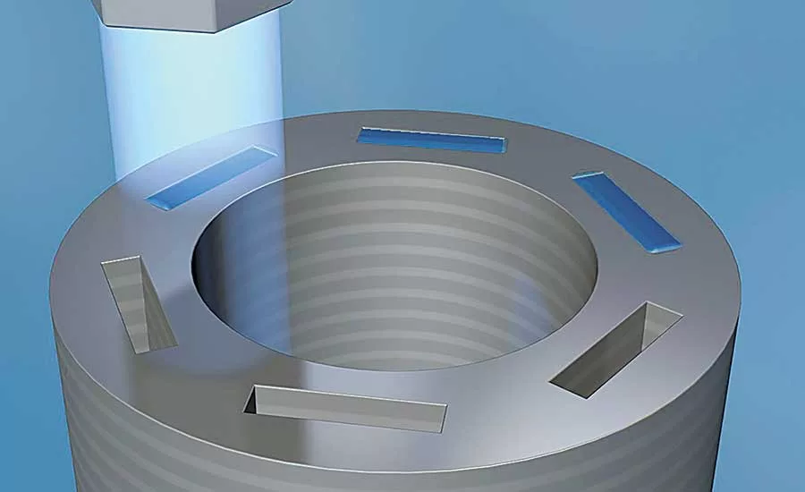

When exposed to ultraviolet light, UV-cure silicones and epoxies cure within 1 to 5 seconds. Graphic courtesy DELO Industrial Adhesives LLC

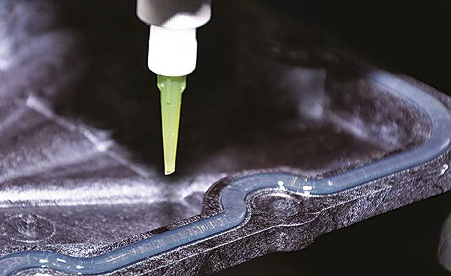

Types of UV-cure silicones include adhesives, conformal coatings and cure-in-place and form-in-place gaskets. Photo courtesy Henkel Corp.

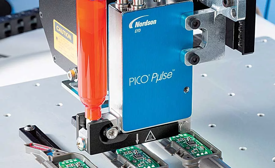

The PICO Pμlse valve is able to repeatably dispense microdots as small as 0.5 nanoliter, at up to 1,000 hertz continuously. Photo courtesy Nordson EFD

Each silicone adhesive is formulated with a photoinitiator that is sensitive to UV light. When exposed to light of the correct wavelength and intensity, the photoinitiator decomposes into free radicals that initiate the formation of monomer chains. After many propagation steps, the chains polymerize within seconds and become fully cured.
Epoxy adhesives also feature a photoinitiator, but it converts into a strong acid when exposed to the correct radiation wavelength. This acid drives the epoxy resins into a chain-transfer polymerization reaction.
UV-cure silicones come in single- and dual-cure formulations that are flowable (up to 5,000 centipoise [cps]) or thixotropic (100,000 to 300,000 cps). Product types include adhesives, conformal coatings and cure-in-place and form-in-place gaskets.
Dual-cure products initially cure with UV light, but require a secondary mechanism to fully cure. They are often used in potting applications or on parts with shadowed areas due to tall components on one side. Ambient moisture and heat are the most common secondary mechanisms. Final cure can take up to 72 hours.

Loctite SI 5031 is a silicone sealant that flows easily onto parts for sealing, potting and encapsulation applications. The one-part material cures tack-free in 20 seconds or less when exposed to either UV or high-power visible light sources. Once cured, it is a translucent (non-yellowing), medium-strength and flexible rubber sealant that resists moisture, corrosion, and extreme weather and temperatures. It is often used to pot connectors in automotive and electronics applications.

UV-cure adhesives require special equipment for proper curing, but work fine with standard time-pressure and positive-displacement systems—so long as all wetted parts (plastic or metal) are compatible with the adhesive, and all plastic components block UV light.
“Jetting valves are increasingly being used to apply UV-cure materials,” says Tom Muccino, regional sales manager at Nordson EFD. “They dispense 1,000 to 1,500 dots per second without even contacting the substrate.”
A couple years ago, Nordson introduced the PICO Pµlse valve, which is able to repeatably dispense microdots as small as 0.5 nanoliter, at up to 1,000 hertz continuously. The noncontact valve’s modular design enables it to jet low- or high-viscosity fluids onto any surface, including uneven and tough-to-reach substrates. Interchangeable parts increase the valve’s versatility. Muccino says users of the valve include machine builders, and makers of medical devices and consumer electronics.
