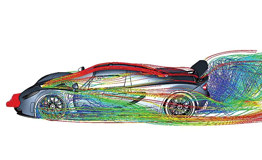

Simulation software that models airflow can be a boon to engineers when designing a clean room environment. By pinpointing potential problems early, such software can save time and reduce construction costs. The software—computational fluid dynamics (CFD)—also can be applied to an operational clean room environment to help identify the source of contamination problems and optimize the overall space.
However, for CFD to work effectively, the data must be clean and complete, and the model must have integrity. Based on the Navier-Stokes equations, CFD uses applied mathematics, physics and computational software to illustrate the flow of gas or liquid through a space and the effect it has on the objects it passes.
Architects and city planners use CFD to predict the effects of airflow around new buildings. Engineers use CFD to determine gas flow in manufacturing processes. CFD can also model temperature and humidity control in a space. A good CFD model can be thought of as a pre-construction step, enabling engineers to compare results of various facility options during the design phase. Based on preliminary plans, it allows engineers to visualize cause and effect prior to decision making.

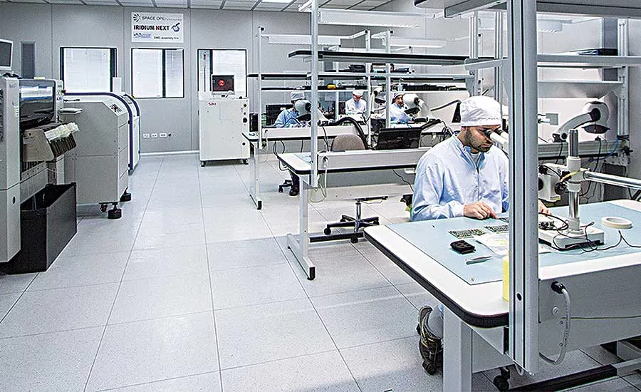

When modeling air flow a clean room, everything in the room should be accounted for. The CFD model should not be based only on an open floor plan, because it will change when tools and other items are added. It should, however, encompass enough of an area, so it is important not to shrink the model down too small. Also, it is cost effective to put tools in a model even if they are phased in gradually.
Items that are often missed in the model are furnishings, tool boxes, carts, trash cans or any other solid objects blocking air paths. Even lightweight materials, such as plastic, plywood, or cardboard installed over floors, can be considered obstructions if they are too close to an air return.
