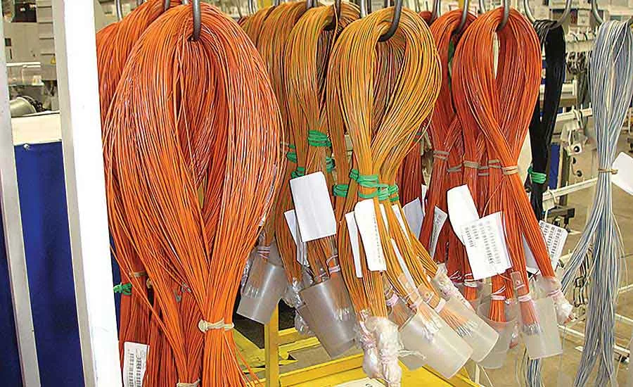

Wire kits, cut and preassembled, are given identification codes so they can be tracked by the MES. Photo courtesy Schleuniger Inc.

Wire processing in the cutting area is highly automated. Cut, Strip and Terminate (CST) machines cut the wires to specific lengths, strip off the insulation, and apply seals and terminals. More complex machines can perform additional process steps, such as twisting wires. Wires produced in this way are grouped into bundles and made available to the next production step.
In a CST machine, the production rates are usually very high and the wires are sometimes very small in diameter. It is primarily the CST machine that ensures precision and quality but the MES also makes an important contribution by transferring control data, such as crimp data, directly to the connected machines.
The MES can confirm quality assurance process steps, such as scanning the barcodes for the wire and terminals, enforcing crimp height and pull tests, and monitoring tool maintenance cycles. To set up traceability, an MES assigns a unique identification code to each wire bundle produced and manages it continuously throughout its history.
