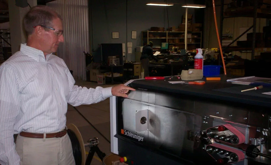

Rick Bromm points out the newest piece of equipment at the ALTEX facility in Westfield, IN. ALTEX invested in the Schleuniger MegaStrip 9650 to increase the size of the cable it can cut and strip. The machine handles cable up to 35 millimeters in diameter. Photo by Michael E. Fitzgerald

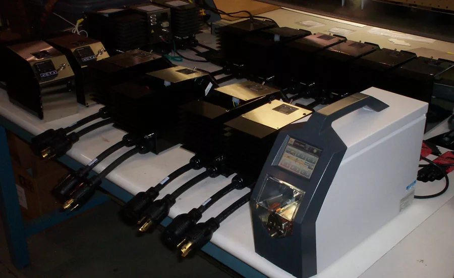

Temperature control modules for Blichmann Engineering’s homebrewing systems are manufactured, tested and packaged at ALTEX’s Indiana facility. Photo courtesy by Michael E. Fitzgerald

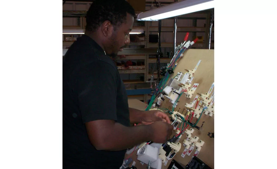

Devanta Guzman assembles a harness for a wheelchair lift at ALTEX’s Indiana facility. Photo courtesy by Michael E. Fitzgerald

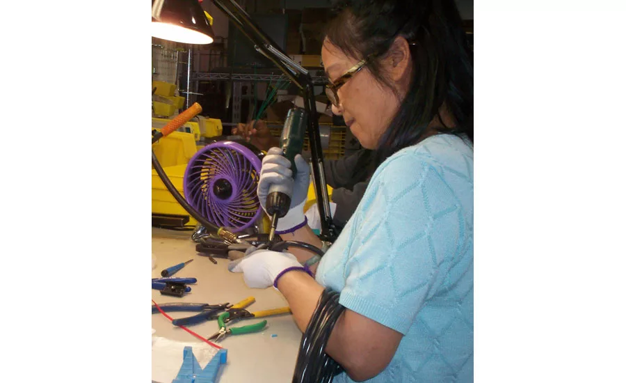

Using a cordless screwdriver, Daphne Song works on cables for mail-sorting equipment. Photo courtesy by Michael E. Fitzgerald

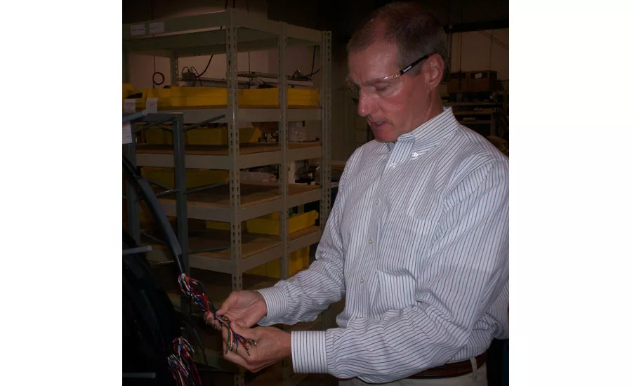

Rick Bromm explains that one of the labor-intensive jobs at ALTEX is cutting individual wires to different lengths. Operators use a strip-crimp machine to strip the wires and terminate the individual conductors. Then, they insert the terminals into housings and test for continuity and functionality with poka-yoke fixturing. Photo courtesy by Michael E. Fitzgerald

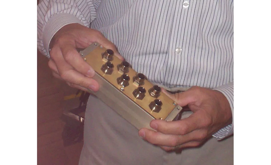

Through its design-assist services, ALTEX modified the process-control monitoring system it assembles for injection-molding machines. ALTEX engineers made the system smaller and networkable. Photo courtesy by Michael E. Fitzgerald

The key to Blichmann Engineering’s Tower of Power home-brewing system is its temperature control module, which monitors and adjusts the temperature of mash as it is being circulated. “Stepped mashes are as simple as dialing the Control Module up using the arrow keys and hitting enter,” contends an Aug. 31, 2012, review on the website of the Indianapolis beer and wine supply shop Great Fermentation. “Beer geeks rejoice: That 17-step mash schedule you’ve always dreamed of is now very, very doable.”
What makes the control module doable is the wire- and cable-harness manufacturer ALTEX Inc., which has built close to 5,000 controllers for Blichmann Engineering since 2012.
The founder and president of the home-brewing equipment company, John Blichmann, turned a hobby into an international business, explains ALTEX President Rick Bromm. “He did not like the products on the market, so he developed his own,” Bromm says. “He wanted to design and sell it. He did not necessarily want to do all the manufacturing.”
Blichmann found ALTEX through Caterpillar Inc., where he had been an engineering supervisor. ALTEX manufactures wire harnesses for Caterpillar and some of its suppliers.
While the temperature control module requires some harnessing, it is mainly an electromechanical assembly job, Bromm explains, noting that different versions are built for North America and Europe. “We do all of the assembly, build it, test it and then put in the box,” he says. All that Blichmann Engineering does is conduct a final check before selling each module.
“ALTEX has been a great vendor to work with,” Blichmann notes, describing ALTEX as being process-driven and praising it for attention to detail, quality, delivery and customer service. “While we aren’t a large customer, they treat us as if we are as important as the bigger clients. …ALTEX has definitely helped us achieve our quality goals.”

One example of how ALTEX improved a product through design assistance is a process-control monitoring system it assembles for injection-molding machines. “When [the customer] sent it to us, it was completely different. It was a big, rectangular, industrial-looking box,” Bromm recalls. “They said, ‘We need it smaller, and we need it to be networkable.’ ”
ALTEX’s engineers redesigned the monitoring system based on the customer’s parameters.
