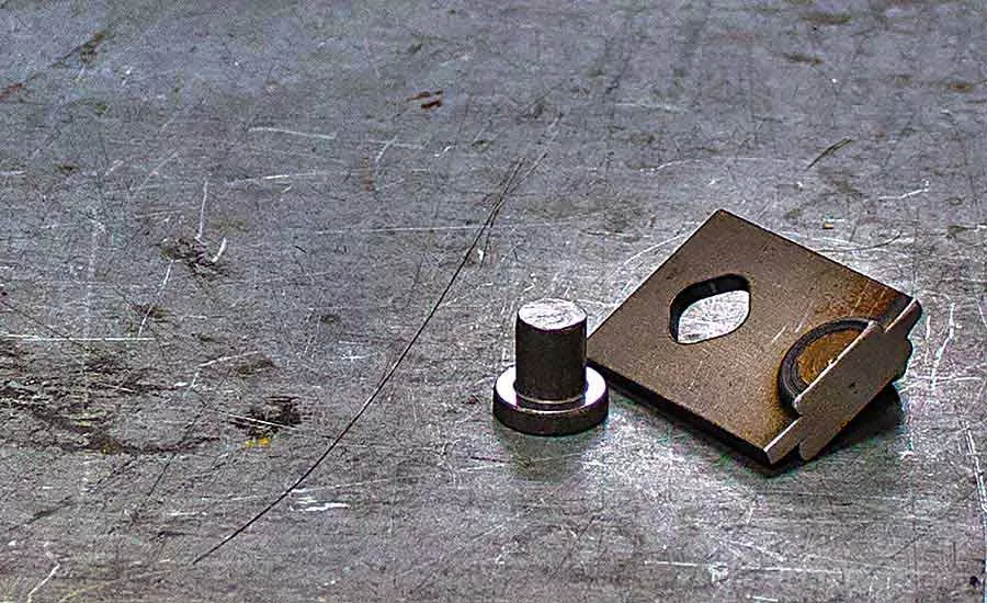

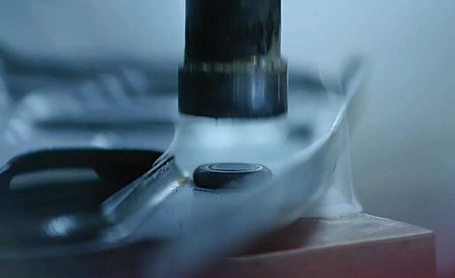

With hot upset riveting, it is possible to form a round fastener into a square hole, creating joints with very high resistance to torque. This makes the process excellent for forming parts that will incur high vibrational fatigue. Photo courtesy Orbitform Corp.
Hot Upset Riveting

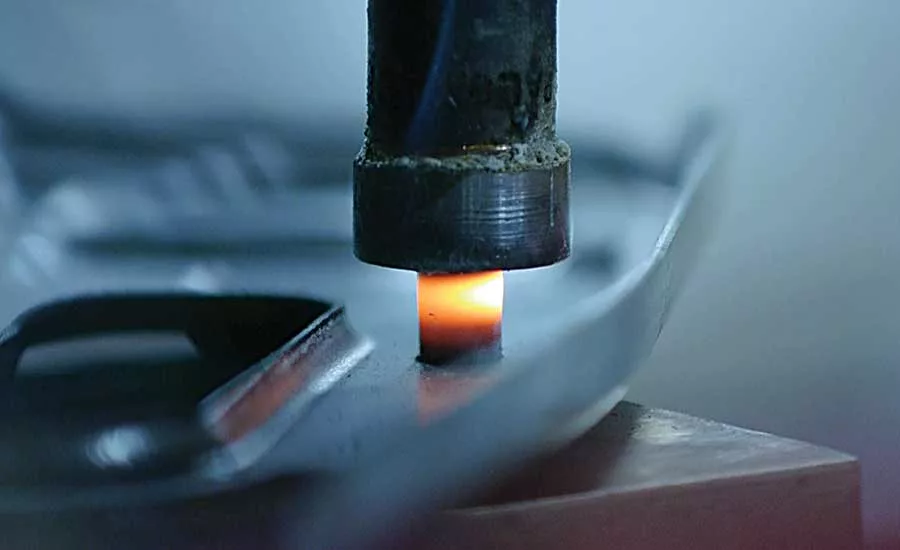

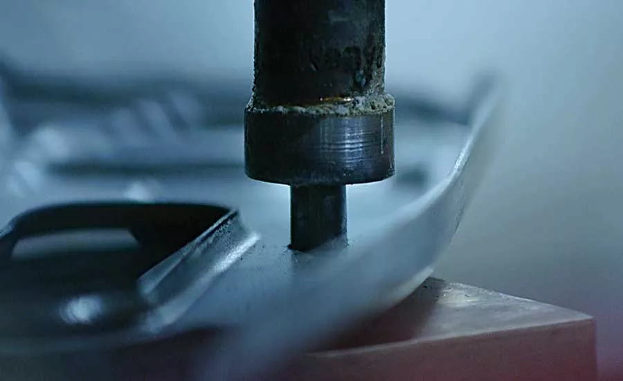

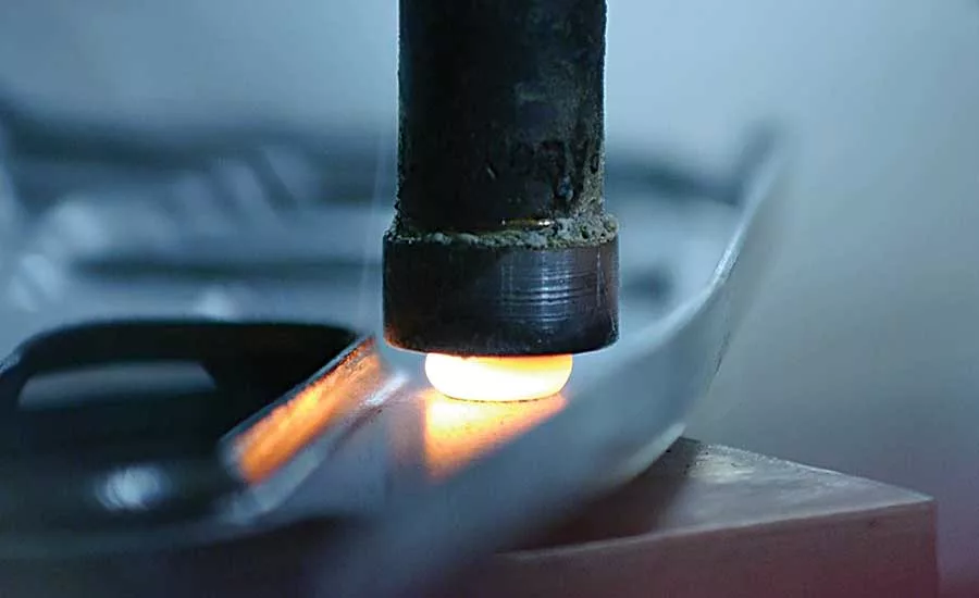

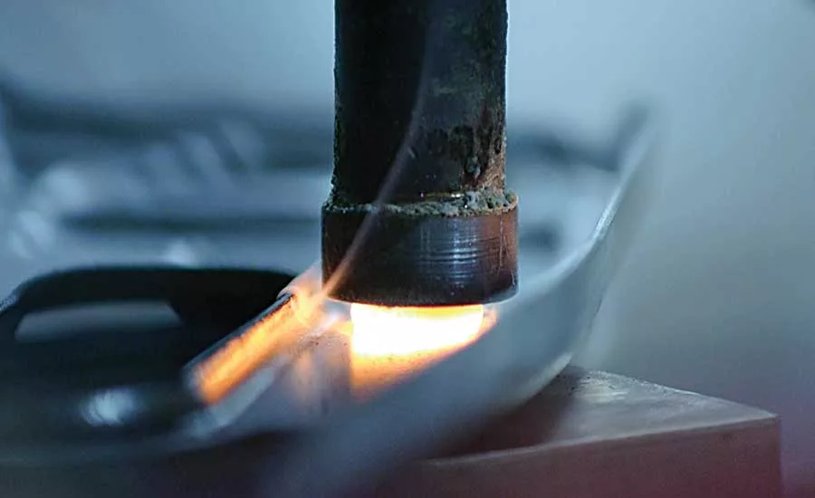

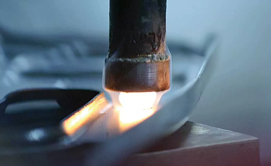

The hot upset riveting process uses heat and pressure to form a boss or rivet. At the start of the process, electrical current is applied to the workpiece. As the boss or rivet heats up, the material becomes malleable and collapses under pressure applied by the power head. After the material has formed, the current is turned off and the tool pauses briefly while the material cools. Photos courtesy Orbitform Corp.

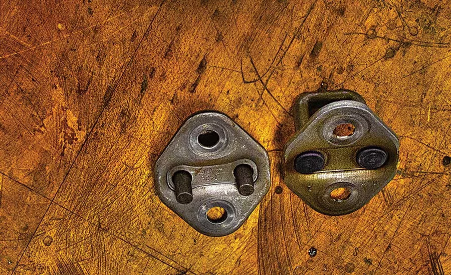

Automotive door strikers are a common application for hot upset riveting. Photo courtesy Orbitform Corp.

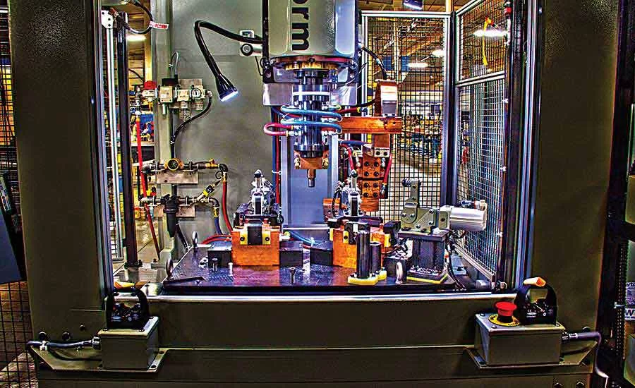

Hot upset riveting can be done with a simple benchtop machine that is loaded and unloaded manually, or it can be integrated into an automated assembly system. Photo courtesy Orbitform Corp.

Hot upset riveting is a permanent forming and fastening process that uses precision heat and pressure to form hardened workpieces. This process achieves maximum hole-fill, creating a robust joint. Depending on the part requirements, the result can be a fixed or movable joint assembly.

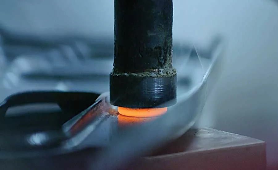

Similar to electro-forging, hot upset riveting combines electrical current with pressure to form a boss or rivet to a desired diameter and shape. Under pressure applied by a power head, the workpiece becomes malleable due to current that flows to the joint and finished head. As the material cools, it contracts. Hot upset riveting uses the resistive heat and pressure to form the workpiece and not heat the base material, preventing the two from bonding.
The joint strength comes from a combination of science, technology and geometry. While common practice is to form a round workpiece in a round hole, the hot upset riveting process proves the sheer strength of forming hardened parts with mismatched engagement geometries. You can form any shape workpiece into a circle, square, star-shaped or hexagonal hole. The heated material collapses and reforms to fill the space. This allows for interference at the joint engagement, resulting in maximum torque or sheer resistance.

Hot upset riveting is an exact science. If too much electrical current is applied, the workpiece can explode. If insufficient current is applied, the workpiece material will not successfully flow. The hot upset riveting process requires proper testing and training before operating.

When considering hot upset riveting, engineers can opt for a simple benchtop machine that is loaded and unloaded manually, or they can request a custom-engineered machine to be integrated into an assembly system. For a more automated machine, engineers can implement process intelligence and control features like linear variable differential transformers and load cells to monitor stroke position and force, sensors to monitor current, and sensors for power head advancement and retraction.
To stabilize the part during the forming process, the system can be outfitted with a part clamping pressure pad. A few safety specifications could include a light curtain, three-sided fixed guarding, automated front door guard, or dual-palm activation buttons.
Recently, Orbitform designed and built a custom hot upset system to automate assembly of an automotive door striker. The customer required automatic feeder bowls to orient, feed and join two parts using hot upset riveting. The assembly was then passed to a part marking station, where a tool laser-marked an identification code on the assembly. Orbitform custom-engineered the complete automated system, including the tooling.
