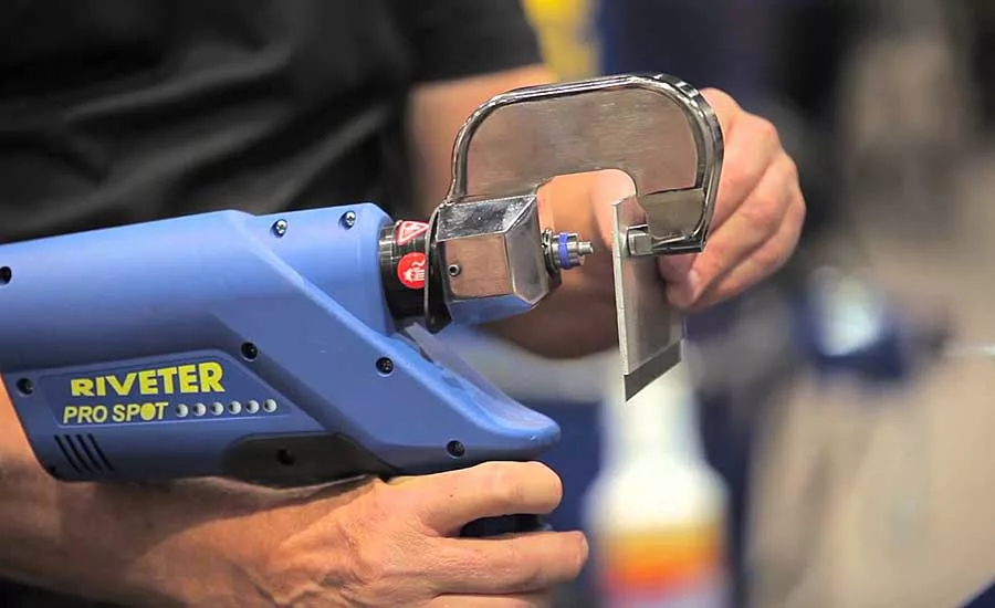

An SPR system typically consists of a C-frame press equipped with a riveting head and an upsetting die. Tooling can be customized to access most any area of an assembly.

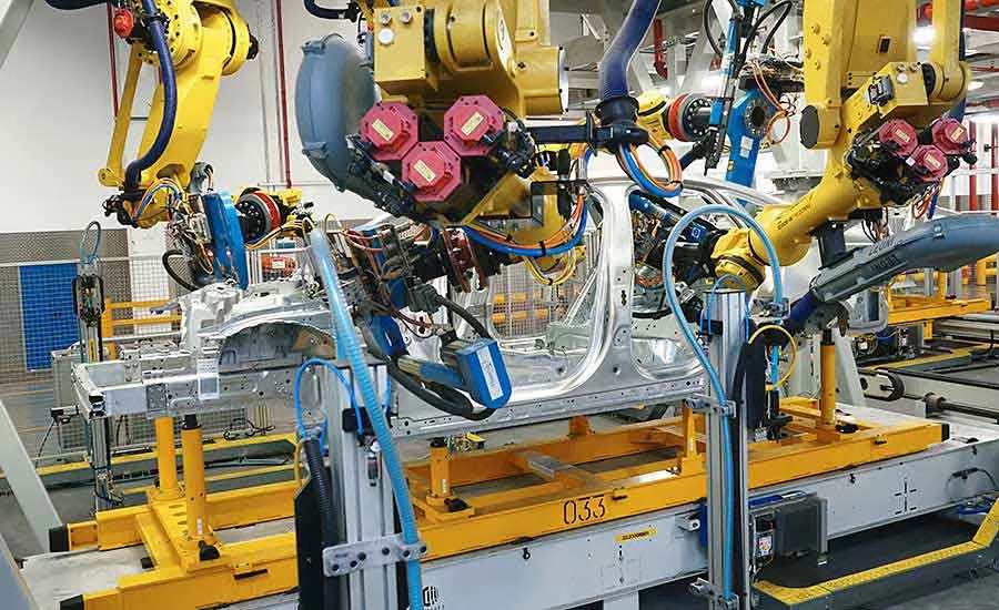

Riveters are available as handheld tools (both corded and cordless) and as standalone pedestal systems. Riveters can also be mounted to a six-axis robot for fully automatic assembly. Rivets can be supplied to the setting tool on tape or with a vibratory bowl and blow-feeding system.

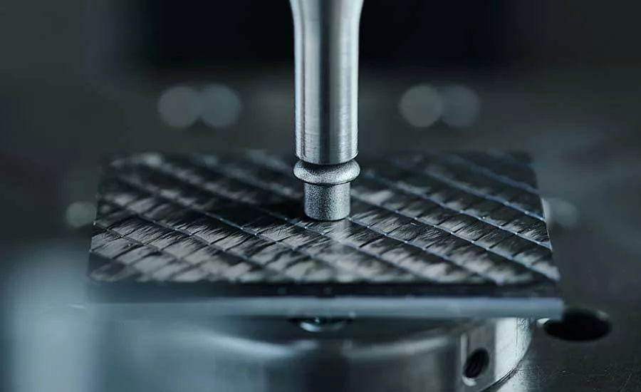

Researchers at Robert Bosch GmbH in Renningen, Germany, do not use heat, but rather vibration, to augment rivet installation. Florian Woelke, a technical project manager at Bosch, came up with the idea of applying ultrasonic energy to help drive the rivet into the materials. When the rivet contacts the materials, the punch applies vibrations at a frequency of 20 kilohertz and an amplitude of 0.1 millimeter. The vibrations excite the head of the rivet, so that, instead of applying ever more pressure, the rivet is coaxed through the material. The technique can join materials that are difficult to bring together, such as carbon-fiber composites and steel, or aluminum and magnesium.
