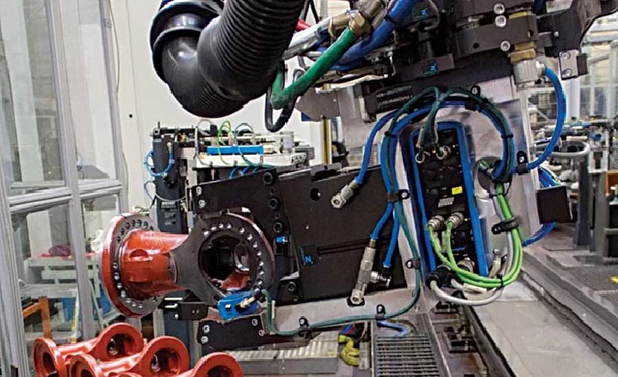

This Zimmer gripper handles a robot component within the KUKA production cell. Photo courtesy Zimmer Group

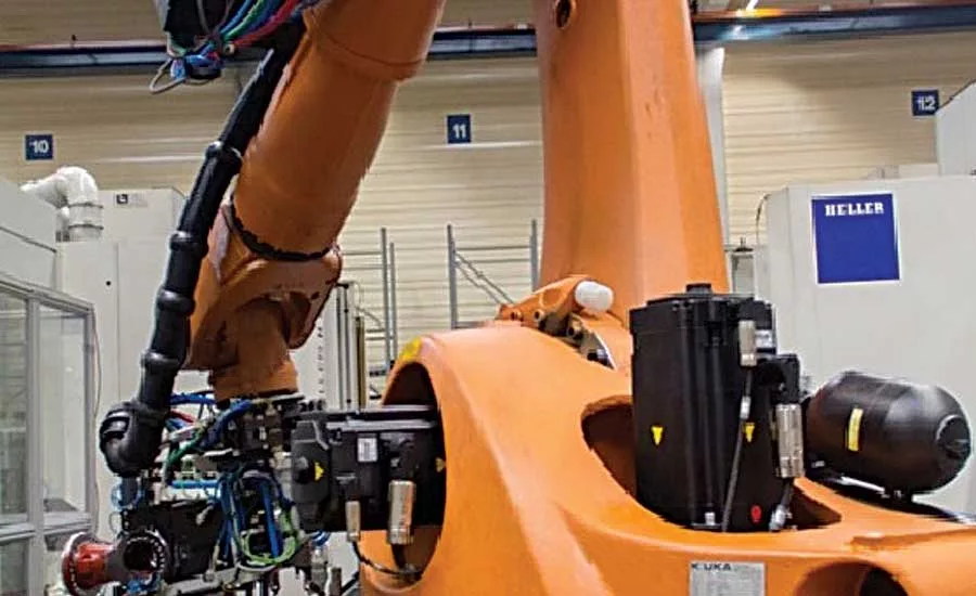

At the KUKA factory in Augsburg, Germany, each production cell consists of two Heller machining centers and a KUKA six-axis robot mounted to a KUKA linear axis. Photo courtesy Zimmer Group

At its factory in Augsburg, Germany, automation specialist KUKA is using its own robots to make more robots. KUKA engineers designed a fully automated, networked production cell that consists of two Heller machining centers and a KUKA KR FORTEC six-axis robot mounted to a KUKA KL 150-3 linear axis. With a maximum reach of more than 3.3 meters and a maximum payload capacity of 500 kilograms, the KR FORTEC was designed for heavy-duty applications, such as machining and casting operations.
The cell has been running with short cycle times since January 2015. The system makes bodies, arms and carousels for industrial robots on a daily basis. To master these tasks, the KR FORTEC relies on various grippers from the Zimmer Group, headquartered in Rheinau, Germany. A variety of factors motivated KUKA to use Zimmer grippers for handling tasks.

The robot picks up cast-iron robot components with the aid of pneumatic grippers. It uses a large pool of available grippers, called a gripper station, and selects the appropriate gripper for each step. It then feeds the cast-iron components to one of the two machining centers. There, the components are drilled and milled. Next, they are deburred by the robot and removed from the machine for quality inspection.
The majority of the grippers in the cell are pneumatic and activated by one of the 5/2 directional valves in the robot’s wrist. Inductive sensors in the gripper tell the robot controller when the gripper is open or closed. An optical sensor tells the controller when the robot has picked up the workpiece correctly.
