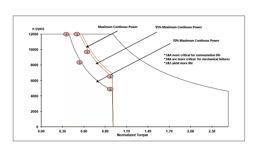

The Motor Basic Torque Speed Curve
The Characteristics of motor is represented by its speed torque characteristics. Below is the graph (Figure 1) of DC motor with precious metal commutation that shows torque on X axis and Speed on Y axis.
The maximum continuous torque line marks the thermal limit of using the motor continually without overheating the motor in normal conditions. The region on the right and left side of the maximum continuous torque line are called intermittent and continuous operating zones. In intermittent region the motor can be operated for a short duration that depends on how far it is operating from maximum continuous torque line. The farther the motor is operating; shorter will be the duration of its operation at that working point.
The critical motor design factors defining reliability at various working points is also defined in Figure 1.  Reliability at the high speed working points (point 1 and point 4) is function of commutation and bearing design.  Reliability at maximum continuous torque working points (point 3 and point 6) is a function of its thermal design. Reliability at any working point on right side of maximum continuous torque line is function of both thermal and mechanical design. The curve line shown by points 1-2-3 shows 95% of maximum continuous power and point 4-5-6 shows the 70% of maximum continuous power curve.  Operating at 70% of maximum continuous power will have higher reliability than operating at 95% of maximum continuous power curve.

Increasing higher speed requirements from a permanent magnet miniature DC motor is increasing stress on its commutation system design or bearing design whereas increasing high torque requirement increases stress on its thermal and mechanical design of various subassemblies. This signifies that the reliability of the motor varies if we operate a DC permanent magnet motor at Point 1 Vs at Point 2 Vs at Point 3 as explained above and shown (Figure 1).

b. The working point should cover high speed-low torque point (Figure 1 - Point 1) and low speed-high torque point (Figure 1 - Point 3). Life expectancy at these working points may be low as these are extreme points for commutation or thermal / mechanical failure of the motor. These points define limits of life during continuous operation of a motor. The life at mid torque and speed is higher and provides the useful life.

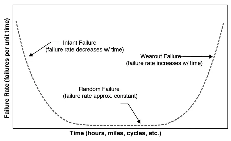

b. Weibull distribution is widely used for life prediction, since it is a generic distribution which encompasses exponential, normal, and other distributions. Simply speaking, a Weibull distribution represents a line where the Y axis represents the failure rate or unreliability and the X axis represents the time to failure. The slope of this distribution or line is called the shape parameter (b ). The intercept of this line with X axis is used to calculate scale parameter or characteristics life ( h). The characteristics life is life at 63.2% of failure. The intercept of the Weibull plot on x axis is given by bIn(h). By measuring this intercept in the graph, the characteristics life is calculated.
c. The Weibull plot (Figure 2) can result in life of motor falling in either of three distinct regions, often called the famous bath tub curve. If b<1 then the failures are infant failures, due to design issues, material issues or in general special reasons in design. If b= 1 then the failure rate is constant and such failures are called useful life failures or random failures. This is the life for which we mainly aim.  If b>1 the failures are wear out failures and they increase with time.

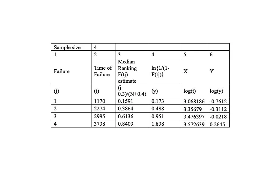

5. Calculating X and Y axis Values of Weibull Curve
a. The Weibull curve is plotted on a log-log graph. Let us assume that we have tested four motors at one of those points as indicated in Figure 1, and that all the test units were tested to failure and their failure times were recorded.
b. The failure times t needs to be arranged in increasing order – 1170 Hrs , 2274 Hrs, 2995 Hrs, and 3738 Hrs.
c. The corresponding X-axis values in Weibull curve are simply the natural logarithm of each time to failure i.e. X=In(t). We can also take base 10 logarithms which are used in this case.
d. The corresponding Y-coordinate requires calculation of failure probability F(t) or the unreliability of these motors. This means, we need to come up with unreliability estimates for each of our failure times in order to plot the data on a two-dimensional Weibull plot. These unreliability estimates are calculated by median ranking (MR) using Benard’s approximation.  It has the form:
Portescap1_IN
Where N is the total number of failures (in this case N = 4) and j is the failure order number. In this case j =1 for failure at 1170 Hrs, j=2 for failure at 2274 Hrs, j=3 for failure at 2995 Hrs and j=4 for failure at 2995 Hrs.
To arrive at Y axis value of Weibull curve we need to perform below steps:
  • Calculate unreliability estimates F(t) for each of our failure times based on Benard’s approximation
  • Use the above unreliability estimate for each failure and calculate the function
Portescap2_IN
  • From the value of , the Y axis coordinates of Weibull plot can be calculated taking the natural logarithm of .  We can also take base 10 logarithms which are used in this case.
The X and Y coordinates are organized in column 5 and column 6 of the table shown below.

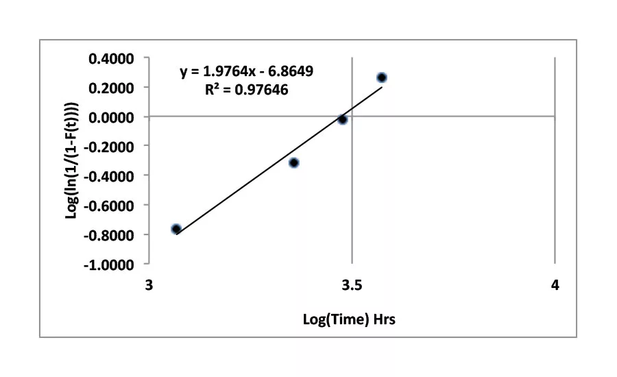

6. Plotting Weibull Curve
a. The next step is to use an excel spreadsheet to make a scatter plot with X axis as column 5 & Y axis as column 6 (Table 1). Then fit a line and display the equation of the line and degree of fit R2 on the plot (Figure 3)
Life Prediction Using Weibull Plot
a. Shape Parameter b(slope of  Weibull line)
The above graph gives the shape parameter bas 1.974. Since the value of bis >1 hence these failures are wear out failures.
b. Characteristics Life h
The equation of Weibull line above gives intercept on x axis b ln has -6.8649. From this we can calculate the characteristics life   by substituting value bin it. The value of characteristics life is 2975 Hrs.
c. B10 Life
B10 life is life corresponding to 10% of failure or 90% reliability. The above two parameters can be substituted in Weibull reliability equation to calculate B10 life. The details of Weibull reliability equation and its linear formulation are placed in Appendix for reference.  In this case B10 is 950 Hrs.
