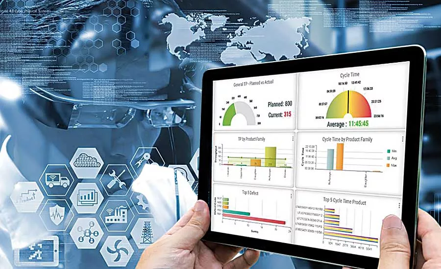

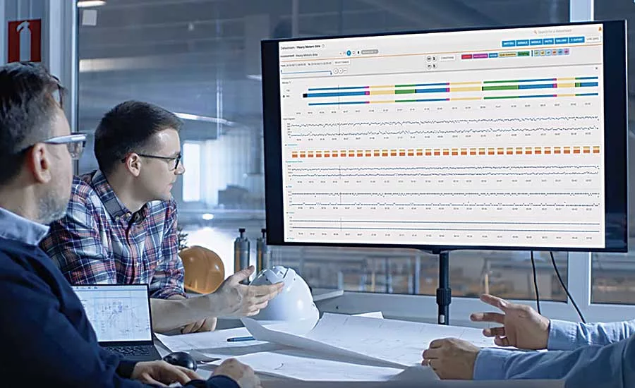

Data analytics software uses dashboards to display information such as quality, uptime or throughput. Photo courtesy 42Q/Sanmina
