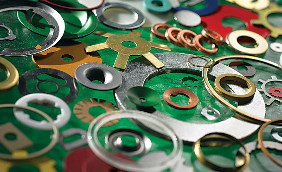

Washers are available in a bewildering array of sizes, shapes, materials and finishes. Photo courtesy Boker’s Inc.

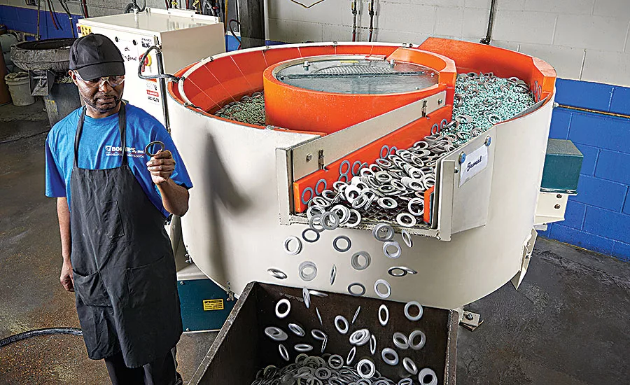

Washers are stamped parts. Make sure your manufacturer produces burr-free parts. Photo courtesy Boker’s Inc.

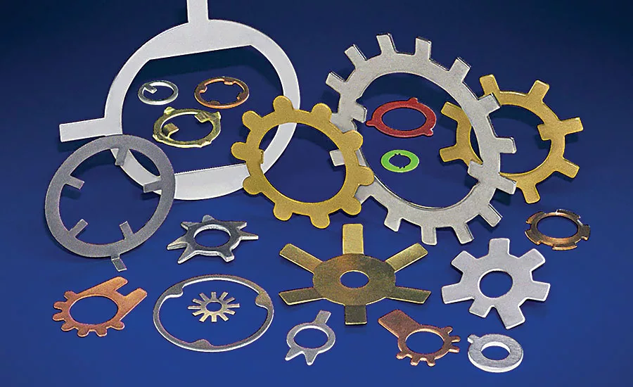

Tab washers are a type of lock washer with one or more tabs that can be formed to shape around a bolt or nut. These washers effectively lock a part into place in applications subjected to extreme heat or heavy vibration. Photo courtesy Boker’s Inc.

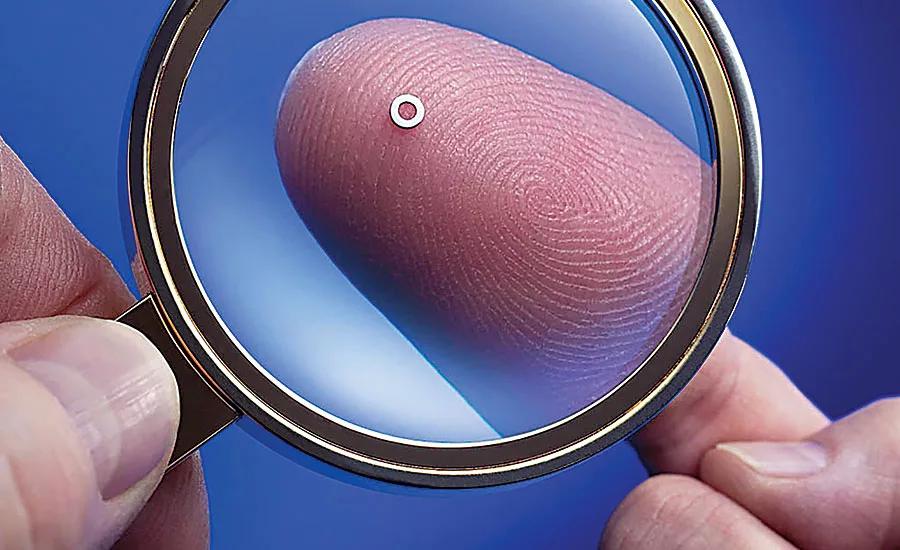

Miniature washers can be made with an OD smaller than 0.08 inch and an ID of 0.03 inch. They can be 0.005 thick or less. Photo courtesy Boker’s Inc.

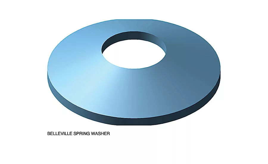

Belleville washers are often described as conical or spherical spring washers, as they have the form of a truncated cone or truncated sphere. They are commonly used in thermal expansion applications. Drawing courtesy Boker’s Inc.

Any type of material that can be stamped can be made into a washer. Washers are manufactured in a broad range of metallic and nonmetallic materials, including low- and high-carbon steels, stainless steel and steel alloys, copper-based materials, beryllium copper, phosphor bronze, titanium, aluminum, fiber, mica, polyester, rubber, nylon, PTFE and phenolic.
Material selection is important, because some applications require a specific material to ensure the washer withstands environmental conditions. For example, if a washer will go through cyclic loading, strength and fatigue resistance will be important design criteria. As a result, high-alloyed steels or spring steel may be required. Alternatively, nonmetallic materials can be used when washers are subjected to lighter loads or if they will be used on soft surfaces that could be damaged by a metallic washer.

Tab washers are a type of lock washer, round in shape and often manufactured with a single tab or multiple tabs and notches that can be formed to shape around bolts or nuts or designed to lay flat. These washers are ideal for use in harsh environments, effectively locking a part into place in applications subjected to extreme heat or heavy vibrations.

Belleville washers are often described as conical or spherical spring washers, as they have the form of a truncated cone or truncated sphere. These washers have the smallest deflection ranges and the highest load capacity of any of the three types of spring washers. The load and deflection capability is dependent on their height-to-thickness ratio. Belleville washers are common in thermal expansion applications, and are used to solve spring problems of high loads, limited space and small deflections.

Burrs—ragged, sharp protrusions on the edges of metal stampings—should be considered. Deburring operations can result in additional costs.
