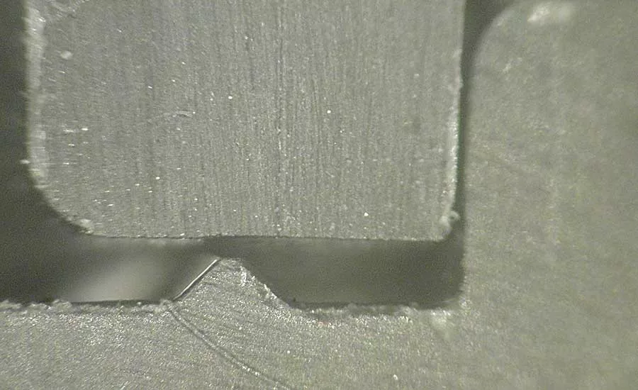

A step joint with an energy director is usually much stronger than a butt joint, since material flows into the clearance necessary for a slip fit, establishing a seal that provides strength in shear as well as tension. Photo courtesy Dukane

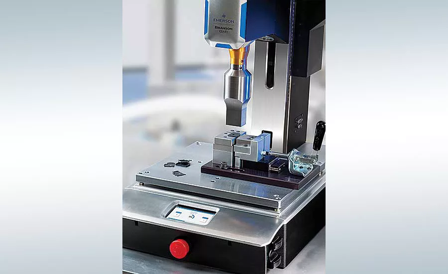

For ultrasonic welding, the part typically has to fit inside a 12-inch by 12-inch box. Photo courtesy Dukane

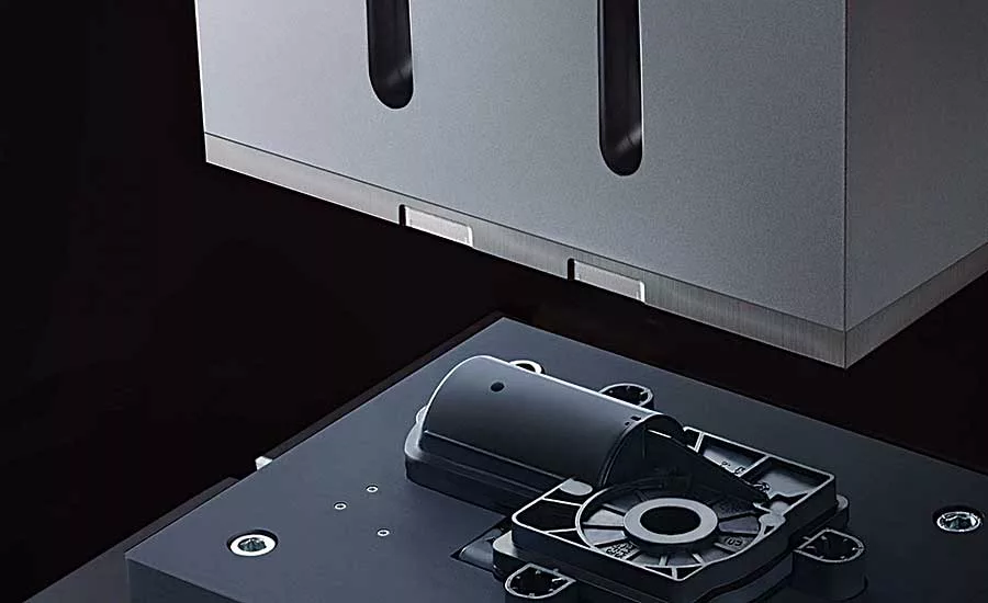

Because the horn must have intimate contact with the part, engineers should avoid features that could prevent the horn from reaching its target. Photo courtesy Weber Ultrasonics

Butt Joint
The butt joint with an energy director is one the most common joint designs for ultrasonic welding, and it’s the easiest to mold into a part. An energy director—a small, triangular ridge molded into one of the mating surfaces—is essential for this design. The ridge can be molded in the bottom part (pointing up) or the top part (pointing down).
The energy director limits initial contact to a small area and focuses the ultrasonic energy at the apex of the triangle. During the welding cycle, the concentrated ultrasonic energy causes the ridge to melt and the plastic to flow throughout the joint area, which helps bond the parts together.
“An energy director helps to initiate the melting process,” says Cristhian Mayorga, associate applications engineer with Emerson Industrial Automation.
Without an energy director, the ultrasonic energy will not be evenly distributed along the joint line, which means more time and energy will be required to produce the same result. That extra time and energy can translate into unacceptable flash or tooling marks on the surface of the part.
The point of the triangle can be molded at a 90-degree angle or a 60-degree angle. The former is best for amorphous resins, such as ABS or polystyrene. The latter is better for semicrystalline materials, such as nylon and polyethylene. As a rule of thumb, the width of the energy director should be no more than 20 percent to 25 percent of the wall thickness. The height of the energy director can range from 0.01 to 0.04 inch, depending on the material’s melt temperature.
Step Joint
A step joint with an energy director is relatively easy to implement in an injection-molding tool. This joint is usually much stronger than a butt joint, since material flows into the clearance necessary for a slip fit, establishing a seal that provides strength in shear as well as tension.
“My personal preference is a step joint with an energy director,” says Brian Gourley, welding group sales manager at Sonics and Materials Inc. “From a molding standpoint, this part design gives you a little more leeway in terms of tolerances for a dimensional fit. With a tongue-and-groove joint, the tolerances have to be a little bit tighter so the mating surfaces can fit together without having side-wall interference.”
“Another favorite is the shear joint,” adds Gourley, an engineer with 35 years of experience in plastics assembly. “One can be better than the other. It depends on the application. In some cases, if all you need is a mechanical weld, a step joint is probably acceptable. But, if the requirements for the application are stricter, the shear joint might be better than the step joint, especially if you need a hermetic seal or the assembly needs to hold pressure.”
The step joint supports self-centering of components, and it’s recommended when a good cosmetic appearance is required.
“A step joint will protect against flash, at least from one direction,” explains Jason Barton, director business development for the Americas at Dukane. “Most customers don’t want to see flash on the outside of the assembly, but they don’t mind if it goes into the inside. On the other hand, if it’s a vessel that’s involved with filtration, then the customer may not want flash inside or out. That’s where a tongue-and-groove joint comes in.”
Joint designs with energy directors tend to work best with amorphous materials—plastics with good stiffness and low to medium melt temperatures.
“Materials such as polyolefin, polyethylene and polypropylene don’t always work well with an energy director,” says Gourley. “Those materials are soft and compressible. They don’t transmit ultrasonic vibrations efficiently, so a step joint with an energy director is typically not our first choice. We’ll look at something that’s going to be a little bit more aggressive, such as a shear joint.”

Outside of the joint itself, there are some general considerations engineers should think about if they intend to assemble a product via ultrasonic welding.
One is wall thickness. “Thin walls may not have enough stiffness to transmit vibrations to the joint area to create an effective weld,” Gourley points out. “If the wall is too thin, maybe 0.06 inch or less, it’s going to act like a spring. It will move in a lateral direction instead of a vertical direction, and it will rob energy from the joint area.”
Another consideration is the overall size of the assembly. “There are limitations in terms of a single horn contacting a single part,” says Barton. “For ultrasonic welding, the part typically has to fit inside a 10-inch by 10-inch box or maybe a 12-inch by 12-inch box. But that depends on the materials, too. You’re not going to weld a 10 by 10 nylon box, but you might be able to weld a 10 by 10 polystyrene box.”
And, because the horn must have intimate contact with the part, engineers should avoid features that could prevent the horn from reaching its target. Machining excessive pockets into the face of the horn could impair its ability to vibrate.
Designs with straight lines or curves can be welded, but rounded corners are preferred over sharp ones. “Ultrasonic energy tends to migrate to sharp areas and cause cracks,” notes Potpan.
Near-field welds—in which the horn is 0.25 inch or less from the joint—are preferred over far-field welds, where the horn is more than 0.25 inch from the joint. The latter will require higher amplitudes and longer weld times than the former.
