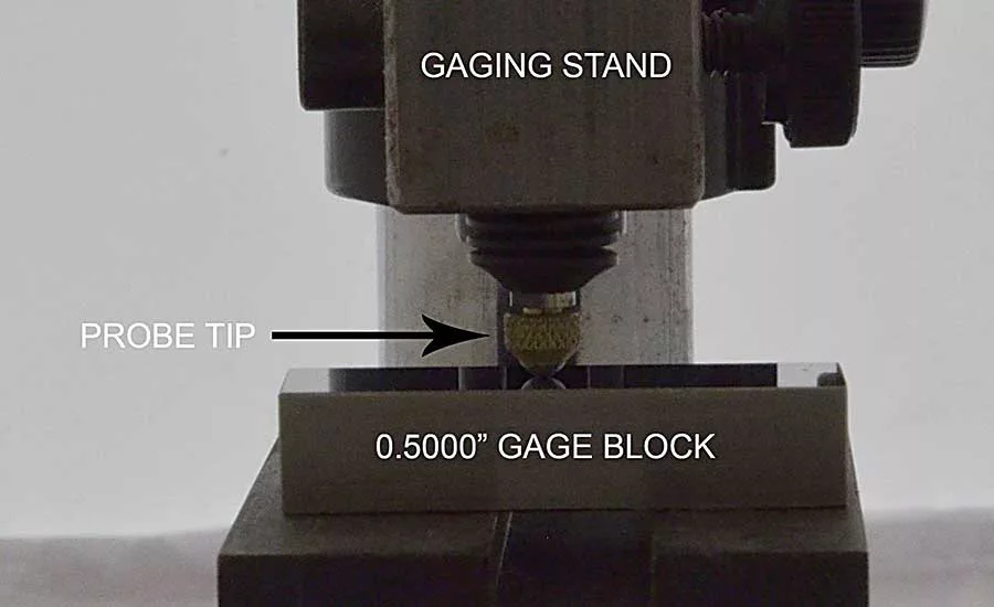

This image shows a spring-loaded position sensor in a typical gauging stand being calibrated with a precision 0.5-inch gauge block. The sensor delivers an output of 0 to 10 VDC fullscale for 0 to 1 inch of probe movement. Photo courtesy Alliance Sensors Group

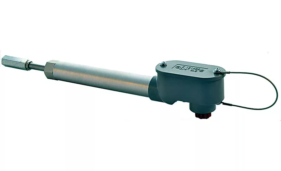

The PG Series of linear variable differential transformers (LVDT) were designed specifically for steam turbine valve position control system applications in electric power plants. The sensor has a heavy-duty terminal block inside an IP-68 sealed housing. A 0.375-inch OD core rod encases the LVDT core so it cannot vibrate loose. Photo courtesy Alliance Sensors Group

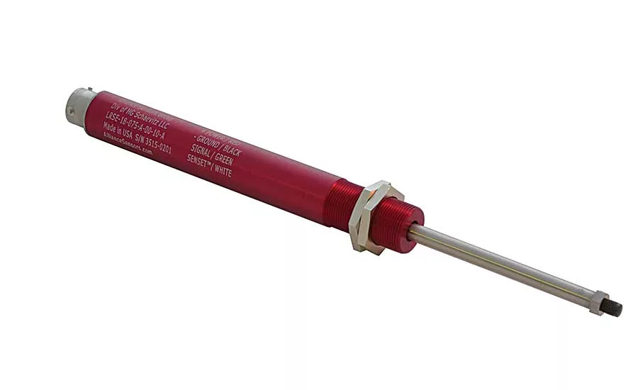

The LRS-18 series of linear variable inductance transducers are spring-loaded position sensors for applications where the sensing element cannot be attached to the object being measured. These include automotive testing, aerospace testing, robotic arms and packaging equipment. Photo courtesy Alliance Sensors Group

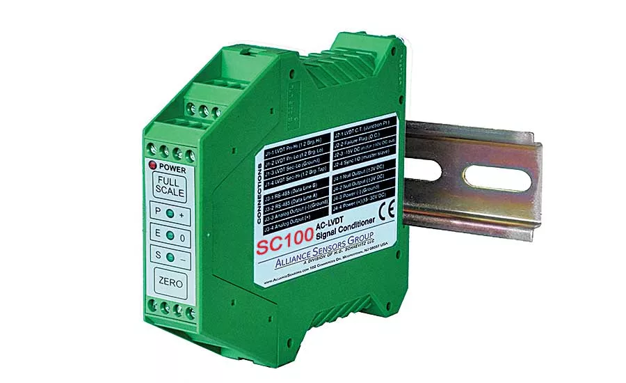

The SC-100 DIN-rail-mounted, smart LVDT signal conditioner simplifies the process of setting up and calibrating an LVDT by offering built-in null indicators and front-panel pushbuttons to set zero and full-scale output. Photo courtesy Alliance Sensors Group

An example of a repeatability test setup can be seen in figure 1, which shows a spring-loaded position sensor in a typical gauging stand being calibrated with a precision 0.5-inch gauge block. The sensor delivers an output of 0 to 10 VDC full-scale for 0 to 1 inch of probe movement. The tip of the sensor is moved inward to allow the gauge block to be inserted between the tip and a flat base, and then released to contact the block.
In five trials, system outputs are: 5.0012, 5.0016, 5.0013, 5.001 and 5.0015 VDC. The average value is slightly over 5.0013 volts, and the maximum variance is ±0.0003 volt, which is equal to ±30 ppm of FSO, or 0.003 percent of FSO.
