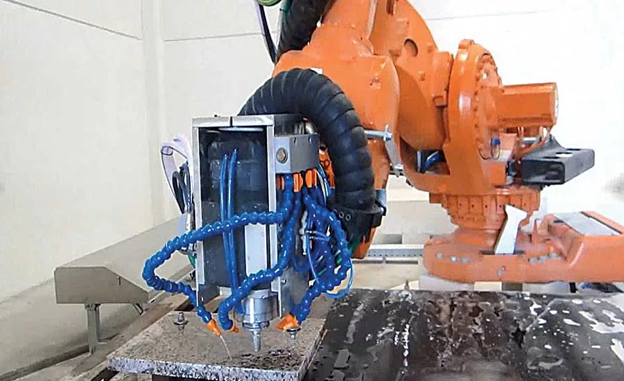

The six-axis robot in the LeanMachine system is equipped with special tooling to perform stone cutting. Photo courtesy ATI Industrial Automation

They established a project, called CORE, to develop a single system that can fully process stone products. In late 2014, they achieved this goal with the development of the LeanMachine system, which consists of a six-axis robot and an advanced HMI.
The robot is equipped with special tooling to perform stone cutting. The HMI uses algorithms developed from human intelligence to efficiently manage all processes and adjust production parameters according to the different characteristics of each stone product. These capabilities enable any stone factory to achieve greater throughput than from manual processes.
