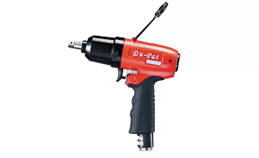

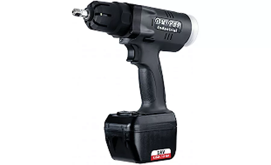

Discontinuous Drive Hydraulic Impulse Tools
Features…
Good weight to torque ratio
High rpm
Low vibration
Pneumatic or Cordless
Torque accuracy of +/- 10 to 15%
Torque Range of 5-450 NM
High precision components designed for longevity and durability in industrial environments
Well balanced for low operator fatigue
Ideal applications…Pulse tools are best suited for hard to medium joints.  Torque reaction is almost non-existent at torque specifications; thus no investment required for complicated reaction device.   It is considered a one-handed tool.  Based on the high rpm offering, this tool is ideal for demanding high production environments.  Pulse tools require simple fluid changes based the demands of the application.

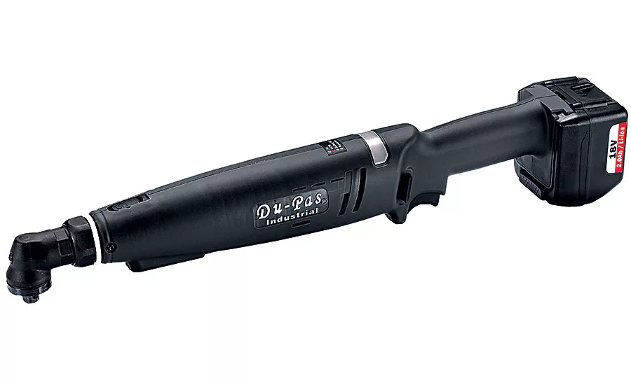

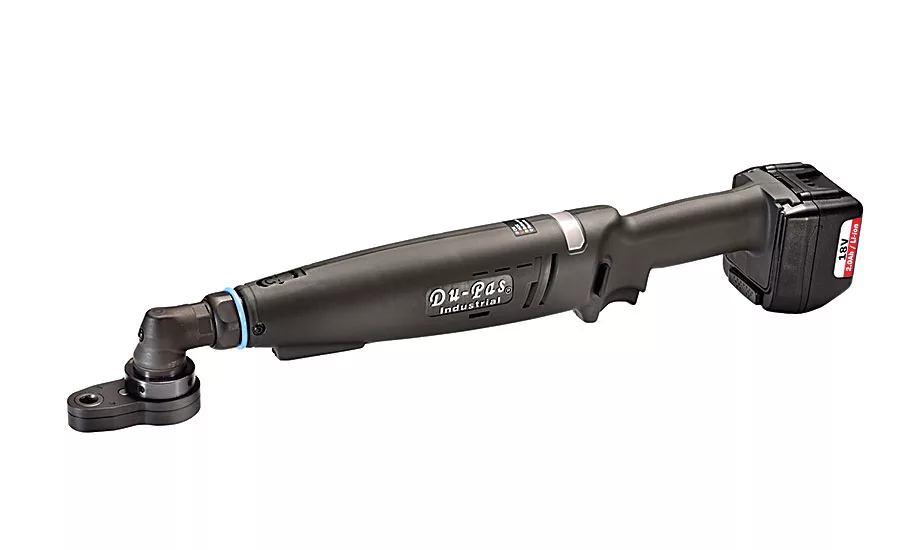

Continuous Drive Clutch Tools
Features…
Minimal reaction
Good power to weight ratio
Torque accuracy of +/- 10%
Torque Range of 0.3-70 NM
Ideal applications…Continuous Drive Clutch tools are best suited for softer joints with high prevailing torque.  Under load, the continuous drive clutch tool maintains constant speed.  It is considered a one-handed tool.  However, with the constant speed, the operator is exposed to the process for a longer period. On applications over 50 NM you must evaluate the reaction which the operator may experience.  Typically, the torque reaction is minimal.
