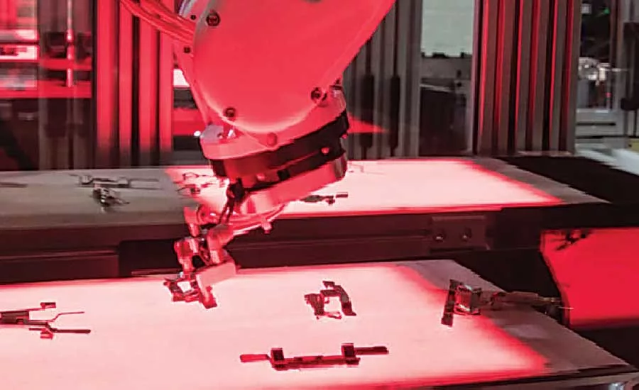

Metal busbars are moved from hoppers onto a cascading three-layer conveyor system. The middle conveyor has a backlit section to verify busbar orientation for accurate gripping by a six-axis robot. PHOTOS COURTESY QC CONVEYORS

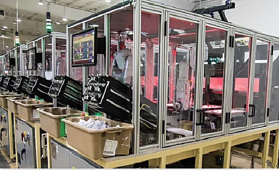

Early in 2018, BES management at the Rockford plant realized that it needed to increase throughput of outlets for modular office furniture. To meet this challenge, the company replaced its manual welding-and-inspection assembly process with three robotic workcells. Developed and installed by automation specialist Criterion Manufacturing Solutions, the cells feature a total of 28 AS40 conveyors made by QC Conveyors.
Product assembly begins with each cell operator setting the parameters for the current job on an HMI. These include the outlet color and size, as well as the number of outlets per case. The operator then manually loads outlet front shells and back plates into separate hoppers on one side of the cell, and metal busbars into three hoppers on the other side.
“Each outlet has five parts, including three busbars for line, neutral and ground,” explains Dan Wierenga, automation manager at Byrne. “And each hopper drops busbars onto a cascading three-layer conveyor system.”
The first conveyor moves slowly and transfers busbars to a faster middle conveyor that evenly spaces them on the belt. In the middle of this conveyor is a backlit section, which is made by Spectrum Illumination and monitored by a Datalogic vision system.
As each busbar travels over the backlit section, the vision system confirms if it is right-side up and clear of other parts. If yes, the conveyor stops and the vision system determines the X, Y and angle of the busbar so a Nachi six-axis robot can grip and reorient it, and place it in a holding area.
Any busbar that is bad, misoriented or clumped with another busbar is moved forward until it falls onto a third (fastest-moving) conveyor that returns the busbar, via an elevator, to the original hopper.
At this point, another robot places the outlet’s front plastic shell into a nest, picks up three busbars and inserts them into the shell. The robot then places the outlet’s back plastic shell on top of the front shell, presses them together and places the assembly on a takeaway conveyor with a dedicated lane for each assembly cell. This conveyor moves each outlet to the inspection station where it is lifted off the conveyor and visually inspected on both sides.
Next, the outlet passes an ink-jet printer that prints a symbol specific to the current order on the front of the outlet. The symbol consists of logos in three different colors depending on the outlet’s body color. After printing, the outlet gets a label on the back and packed into the proper case for shipping.
