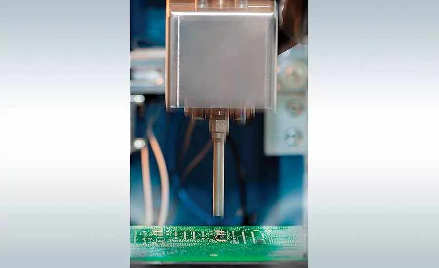

This photo shows a two-phase thermoforming machine staking a plastic part within a PCB. Photo courtesy Dukane

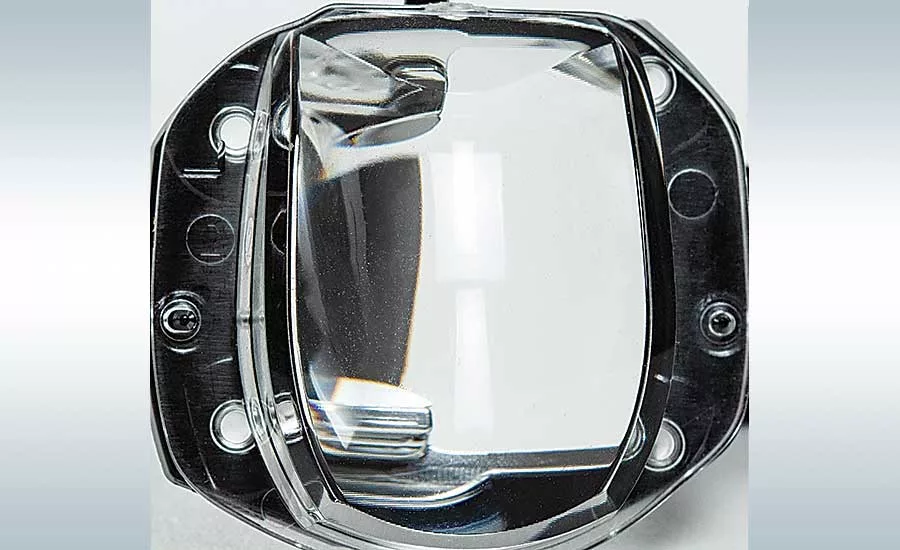

The SimpleStake impulse-power system is used to stake automotive parts, including the plastic housing for the S550 fog lamp on the Ford Mustang. Photo courtesy ToolTex Inc.

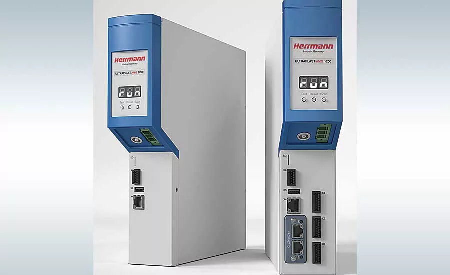

The 1,200-watt AMG generator, which produces the ultrasonic vibrations in the sonotrode, has integrated a distance measuring device that automatically ensures the proper amount of boss displacement in every staking application. Photo courtesy Herrmann Ultrasonics Inc.

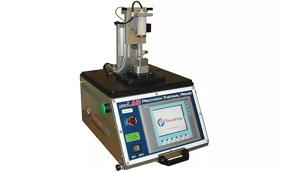

Since 2012, a medical device maker has used the MicroLAB thermal press to perform hot-tool staking on tiny implantable devices. Photo courtesy Thermal Press International Inc.

Medical device manufacturers regularly use staking to assemble small and large parts. In 2012, Thermal Press International Inc. developed the MicroLAB thermal press to help a medical device maker perform hot-tool staking on tiny implantable devices. Lance Crawford, vice president of sales at Thermal Press, says the customer currently uses several MicroLAB presses, which replaced more than 15 custom presses made by local shops.
The company likes the thermal presses’ low maintenance and high flexibility, as they can be used with various actuators and tooling sets. Another benefit is all the presses have common features, such as HMI controls. Crawford says this has enabled the manufacturer to lessen downtime by 20 percent, while streamlining training processes.

Crawford says that Thermal Press specifically developed its WorkStation press line for integrators and manufacturers that perform automated and high-volume thermal staking. The presses feature one to six actuators that are controlled by a single PCB. They also enable communication with other machines, real-time and extensive data acquisition, and remote control. Force-feedback control is optional and involves using applied-force data to accurately control the staking process.
“A well-known electronics contract manufacturer has been using about 200 of these presses at its plants in China since 2010,” notes Crawford. “They use them to stake various electronics parts. Other customers use them for staking parts in automobiles and white goods.”

About 8 years ago, ToolTex Inc. began developing SimpleStake, an impulse-power system to stake plastic parts. The company developed a proof of concept within one year, but kept refining it with new features to optimize efficiency, notes Alex Spurgeon, operations manager at ToolTex. In 2015, the system was introduced.
According to Spurgeon, it works by sending a low-voltage current across a specially designed and patent-pending tip to heat it on demand. The tip is cool at the beginning, but within 2 seconds is heated to a temperature up to 400 F. It stays this hot only as long as the tip touches the boss, and is cool to the touch at the end of the cycle.
“The heated tip makes contact with the boss, stakes to a final depth, and is then cooled with compressed air,” explains Spurgeon. “Fully cooling the button before retracting the tip eliminates elastic recovery of the plastic and the risk of a loose mating between the two parts.”
Spurgeon says the system requires little maintenance and is used to stake parts designed and made by Honda Acura, Toyota Lexus, Nissan and Ford. It can stake bosses as close as 1 millimeter from a wall, and has traditionally been used for small- to medium-sized bosses. In addition, the company is developing tips to stake 6-millimeter hollow bosses commonly found on door panels. Spurgeon says the system is also able to stake through metalized surfaces, which allows lighting manufacturers to not have to mask the bosses prior to vapor deposition.
Over in Europe, KVT developed the two-phase thermoforming staking method at the start of this century. Dukane purchased the company a year ago, and now offers its Dukane-KVT benchtop press, with rotary indexer, for staking any two parts, so long as one is thermoplastic.
A heating element within the press heats nitrogen gas, which is then blown through several 2-millimeter-wide tubes and onto the boss for 3 or 4 seconds. A cold tool deforms the boss for 1 or 2 seconds and stakes the parts together. When the indexer is rotated, another part stack gets placed under the tubes and the operator removes the joined part.
Barton says the press can simultaneously stake multiple parts that are only 2 millimeters apart. Customers also like that the two-phase thermoforming process leaves no particulates on the joint or heating element, and easily stakes low-viscosity materials.

Herrmann has also developed the AMG generator, which produces the ultrasonic vibrations in the sonotrode. The 1,200-watt generator has integrated a distance measuring device that automatically ensures the proper amount of boss displacement in every staking application. If displacement is too much or too little, the unit stops and the operator is notified why.
