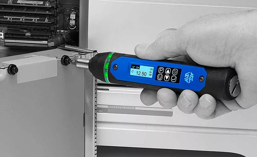

In 2019, Sturtevant Richmont introduced the Exacta 1350-TD Torque Driver series of digital torque and angle screwdrivers. For error-proof screwdriving, these hand-operated tools must be used with the company’s Global 400 and Global 400mp process monitors. The tools wirelessly connect to either monitor, which then disables the tool keypad to prevent inadvertent operator changes to torque parameters.
Tool operation is simple. The assembler simply applies the tool (having a 1/4 inch male square or female hex drive) to the screw head and follows step-by-step assembly directions shown on the monitor display. There are no buttons to push on the tool.
When the fastener approaches minimum torque, the light band on the monitor turns yellow. A green light and a short beep indicate an error-proof installation. Exceeding maximum torque causes the light to turn red and the audible beep to change to one long tone.
Detailed torque results for each fastening cycle can be immediately called up on the monitor display. These are torque to angle, torque with angle monitoring, peak torque and residual torque. An AA battery powers the tool keypad display, light band and radio for data reception.

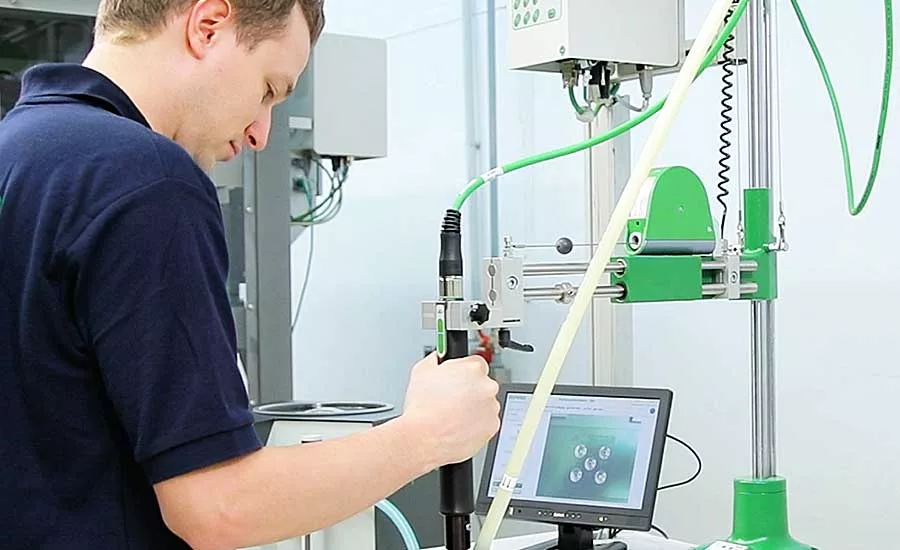

The Minimat-EC-Servo screwdriver and AST40 screwdriving sequence controller from DEPRAG provide torque precision with less than 1 percent standard deviation, which is maintained over millions of cycles. It has a torque range of 0.01 to 500 newton-meters and features a brushless motor that ensures maintenance-free operation, and integrated torque and angle measurement sensors. Drivers can be used as a hand-guided or stationary unit.

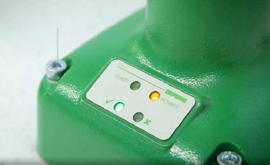

The DEPRAG Plus (DP) screwdriver and controller can be operated as a separate unit, or integrated with either the company’s PKS stand or Tool Box. The stand consistently monitors the screwdriver’s X-Y position in relation to the part during use. It has a built-in controller and an external LED panel on its footplate that indicates operating status.
Handheld and spindle screwdrivers can be used with the DP system. It comes with numerous function apps, and allows for a wireless connection between the tools and a PC or PLC via the Cockpit Basic software interface.
Recently, a manufacturer of EV battery controllers implemented a DEPRAG manual workstation to simplify controller assembly. The prior approach required multiple part stacks and the installation of screws, bolts and nuts from various sides at different torque levels.
“The workstation includes a flexible fixture that holds the part in multiple orientations and provides continuous part presence verification,” notes Baeumler. “A Minimat-EC is also included, along with a tool box that holds various bits and sockets, a PKS stand and Cockpit software to collect all torque data.”
After an operator loads the part in the fixture, a part sensor sends a signal to the PKS, which then asks the operator to scan the part’s bar code. A picture of the controller is displayed with a blue circle that indicates where the operator is to drive a screw and which bit to use for the task.
When the operator does this correctly, the screwdriver is activated and ready to drive the screw. After the fastener is properly driven, the circle on the display turns green.
The operator repeats the process, including rotating the part to access all screwdriving locations as needed, until all fasteners are driven, and the PKS recognizes the part to be completely and properly assembled.

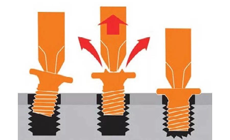

Manufacturers often assume that any fastening-process error is related to the tool. But, sometimes, the error is more related to the fastener or the material. For example, wood joints rarely require error-proofing, says Cash, because the assemblers tend to use pneumatic tools with a quick shutoff once the joint is secure. The exception would be high-end wood furniture.
A common fastener-related error during assembly is cam out, which is when the driver bit is forced back out of the screw recess under torsional load. Most of the time, this event reduces the amount of torque used to tighten a screw.
Using too many and too many types of screws is also problematic. Minimizing both amounts is always best, even though, sometimes, more or larger screws must be used to obtain the required clamping force. Assemblers also need to make sure that the tool reaches torque in a time frame proportional to fastener length.
Another way manufacturers can prevent fastener-installation errors is to only purchase fasteners that fully conform to all design specifications. Companies need to tell their tool suppliers whenever there is a change in fastener vendor, or part material or tolerance. Cash advises manufacturers to ask their tool supplier to perform a torque study of the revised joint to prevent errors during fastening.
Overtightening and undertightening the screw are two such errors, and both can lead to problems during and after installation. Unneeded or excessive lubricant, such as a bit of oil from the assembler’s hands, can cause overtightening and lead to broken fasteners and thread stripping.
Undertightening results from embedment relaxation, which happens when a screw embeds in a soft material and can’t completely compress the joint. The result, unfortunately, is the fastener undergoes more external loading than normal.
Galling occurs when pressure and friction cause the contact surfaces on the fastener and assembled components to seize, preventing proper tightening of the fastener. Reynertson says this problem tends to happen in lightweight joint materials, but can be offset with the proper use of a washer.
Cross-threading is a common error that happens when screw threads do not properly align with those in the threaded hole of the mating material. Sometimes the problem is remedied by re-engaging the parts at a different angle. But, if left unfixed, the fastener may not properly seat and its threads will be unable to sustain the clamp load.

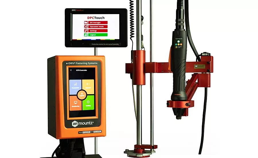

Pistol-grip, right-angle and inline EC and ECT-Series smart screwdrivers from Mountz feature a built-in sensor that continually measures torque in real-time and provides data feedback. Both series are corded tools, but the latter are also transducerized. They work with ECD and ECD-T controllers, respectively, which expedite all aspects of the automation process, and can be used with up to 15 fastening profile presets.
Cash says manufacturers increasingly use these screwdrivers with the company’s DPC-Touch Posi-Control system, consisting of a touch-control device and a position-control torque arm. Built-in encoders in the arm send positioning data to the device, where it is saved along with the time it took to complete the screw rundown. During subsequent fastening operations, the device only clears a sequence when it has been completed within the preset parameters.
“With these smart screwdrivers and controllers, an operator can quickly determine if a cross-threading or stripped-thread problem has occurred during fastening,” concludes Cash. “Reaching the proper preset torque value requires a screw to rotate a specific number of degrees, say 4,000 [i.e., 360 degrees by 11 rotations]. A too-low number usually indicates cross-threading, whereas a too-high-number indicates stripped hole threads that prevent interlocking with fastener threads.”
