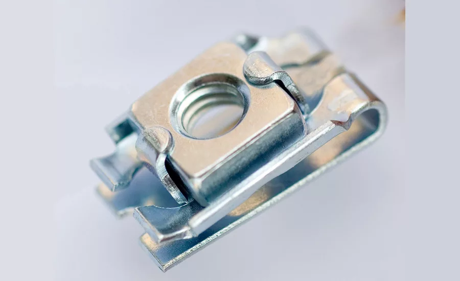

Nuts and bolt aren't the only types of fasteners used in product assembly. Retaining rings, Speed Nuts and a variety of other specialized metal and plastic fasteners have been developed. These specialty fasteners can often save time in the assembly process, eliminate the need for additional fastening components, lower manufacturing costs and maximize holding power.
Speed Nuts
A Speed Nut is a reusable, one-piece, self-locking fastener made of thin, heat-treated spring steel. Two prongs arch upward from the screw hole, and the fastener base is usually bowed. When the screw is tightened, the arch in the base diminishes, forcing the prongs inward and upward at the root of the threads. The prongs provide an inward thread lock and an arched spring lock that are energized as the screw tightens. The combined forces of this double-locking action resist loosening caused by vibration.
Speed Nuts can be used instead of threaded nuts, lock washers or spanner washers, and they do not require special tools to install. Unlike ordinary threaded nuts, Speed Nuts do not have to be tightened with a great amount of torque. In fact, any torque applied beyond the recommended installation torque could cause a loss of spring tension resiliency.
Speed Nuts are available in many shapes, finishes and variations. For example, greater strength can be achieved by increasing the material thickness of the nut and using A- or B-type sheet metal screws. However, because A- or B-type screws taper at the end, longer screws must be used. Sheet metal screws must protrude two to three threads beyond the prongs to ensure adequate grip on the full root diameter of the screw. (Machine screws should protrude 1.5 threads beyond the Speed Nut, the same as with any nut.)
The thread of the Speed Nut can also vary. For example, making the prongs longer and more resilient enables the assembler to "zip" the fastener down over the screw threads. Only one or two turns are then necessary to tighten the screw. This type of nut is good for rapid assembly, but not for heavy loads. The prongs can also be made to provide a restraining torque at any location on the screw threads. This fit is recommended when the fastener is used as an adjustment nut.
The profile of Speed Nuts can be altered for special applications. For example, J- and U-type Speed Nuts are used for blind assembly or hard-to-reach locations. They are pressed into position over panel edges or in center-panel locations. This gives the assembler the ability to float alignment, speeding production and decreasing rejects.
Expansion-type nuts are another Speed Nut variation for blind or center-panel locations. These fasteners snap into square or round holes and are self-retained by spring legs. Special locking tabs can be provided when permanent fastener retention is desired. As the screw is driven, it expands the spring legs, locking them over the panel thickness and at the same time providing a double-locking action on the screw.
