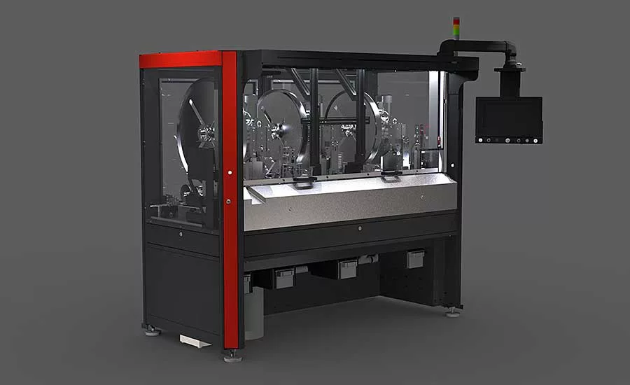

The Lambda 416 automatically strips and terminates shielded, twisted pair cables in a 12-step process. Photo courtesy Komax

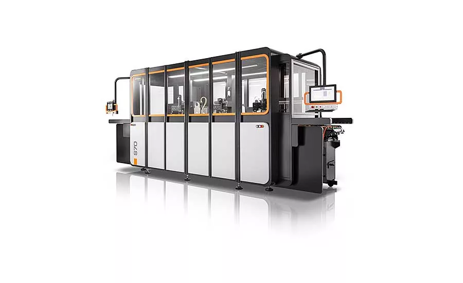

At the Productronica trade fair in Munich in November 2021, Schleuniger’s new S70 automated processing line for Ethernet cables received an Innovation Award in the Cables, Coils, and Hybrids Group. Photo courtesy Schleuniger Inc.

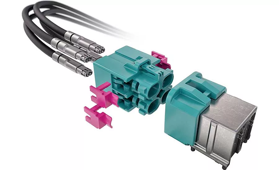

The H-MTD, H-MTD+ and H-MTDe differential connectors for Automotive Ethernet cables can accommodate frequencies as high as 20 gigahertz and data transmission rates as high as gigabits per second. Photo courtesy Rosenberg

For example, the modular Lambda 416 from Komax automatically strips and terminates shielded, twisted pair cables in a 12-step process. In the first step, a wire is manually inserted into a fixture, and the machine pre-qualifies the end of the wire with a “zero cut” process. This process is particularly useful when processing shielded cables or twisted conductors. It ensures that the insertion position in the crimp is correct even if the insulation is pulled forward.
At the next two stations, the cable is oriented, and the outer jacket is cut and partially removed. At station 4, the jacket is pulled off, and a support sleeve is crimped to the cable. At station 5, the braided shield is peeled back and folded against the outer jacket. At stations 6 and 7, the foil is perforated and removed from the twisted pair.
At station 8, the pair is untwisted and spread apart, creating a Y-shape at the end of the cable. At station 9, each end of the pair is stripped. And at station 10, ferrules are crimped onto each end.
At station 11, the braid is brushed and inspected. At the last station, a terminal body is crimped over the pair of wires, enabling the cable to plugged into a connector.
The machine provides comprehensive quality control with crimp force monitoring, as well as tactile and optical measurement.
“Shielded and unshielded twisted pair cables…are tricky to process. The connectors consist of several elements that have to be positioned and aligned with each other with pinpoint accuracy,” says Thomas Haslinger, vice president of sales, service and marketing at Komax. “As a result, these cables are almost impossible to process by hand. Automation is a must.”
Another automated option is the new S70 transfer line from Schleuniger. The flexible, modular machine automatically processes two- and four-conductor cables, single wires and coaxial cables, including Ethernet, high-speed data cables, two-way UTP and STP cables, standard and high-speed FAKRA cables, air bag squib cable assemblies, safety switch harnesses, and cables for antilock brakes, exhaust management systems, temperature sensors and applications.
The tool carrier can be indexed laterally, vertically and axially. Part feeding, assembly stations, coiling systems and test stations can be integrated according to individual requirements. The system can also be extended with peripheral devices.
At the Productronica trade fair in Munich in November 2021, the machine received an Innovation Award in the Cables, Coils, and Hybrids Group.
