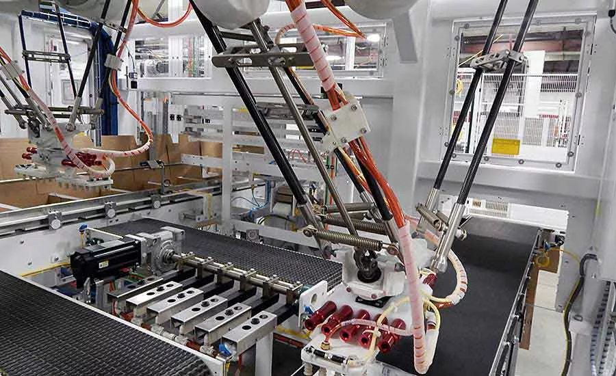

High-speed delta robots are particularly well-suited for picking products and placing them into secondary packaging quickly but gently. Photo courtesy Brenton Engineering Inc.

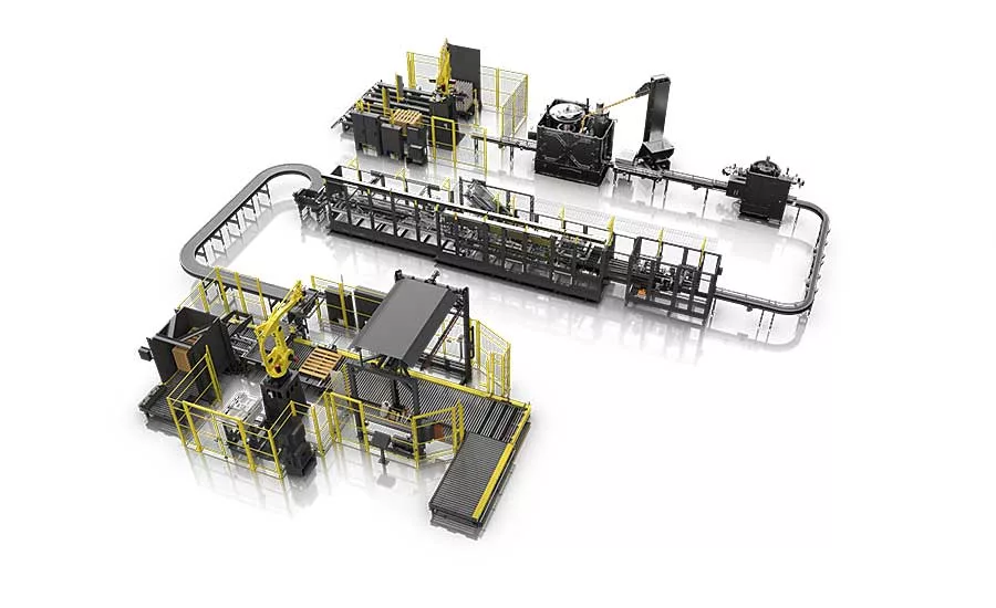

Maximizing the capabilities of packaging equipment depends upon how well it is integrated into the assembly line. Photo courtesy Brenton Engineering Inc.

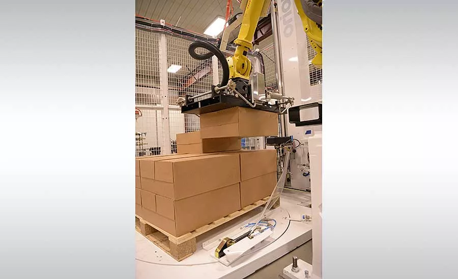

Robotic palletizers can build higher, more dense and more stable pallets than conventional systems. Photo courtesy Brenton Engineering Inc.

Integration of Packaging Systems
 Maximizing the capabilities of packaging equipment depends upon how well it is integrated into the assembly line. The task is not as straightforward as merely acquiring the machinery and programming the robots. Rather, that’s just the beginning. Programming is the easy part. Making the ancillary systems work together, and presenting the products to the individual machines and robots so they are not doing more work than is necessary requires considerable expertise.
Working with experienced packaging equipment suppliers can be invaluable. They understand the upstream and downstream inputs and outputs of the machines. They can provide the latest in servo-driven motion control technology for fast and reliable changeovers, as well as superior diagnostics and technical support.
Integrating a packaging system into an assembly line involves examining each station on the line. What is its mean time between failures and how does that affect the production rate? These risk assessments may lead the packaging equipment supplier to install vision systems at key points on the line or create accumulation lanes to ensure that the line keeps moving during short periods of downtime.
The packaging equipment supplier will also evaluate the entire line for safe operation. Simply attaching conveyors between machines and writing control code to ensure proper handshakes between PLCs is not enough. Additional guarding, emergency shut offs, hold-in-place actuators and other safety systems may be necessary.
A good packaging equipment supplier can reduce the time required for validation by creating and populating the bulk of the installation qualification and operation qualification (IQ/OQ) documentation prior to factory acceptance test (FAT). A packaging equipment supplier might need just four weeks to prepare IQ/OQ—half the time a medical device manufacturer might invest to do the same work. The equipment supplier knows the system’s software. Having most or all of the documentation completed by the end of the FAT saves time, and will free up the medical device manufacturer to focus on a faster, more trouble-free startup.

Robots for Pick-and-Place
Medical device makers have a wealth of robot options for picking and placing assemblies and packages: six-axis robots, delta robots and SCARA robots. High-speed delta robots are particularly well-suited for picking products and placing them into secondary packaging quickly but gently.
Regardless of the type of robot used, the key to success lies in the end of arm tooling (EOAT) used to pick up the items. Well-designed tooling will ensure high pick rates without damaging the product. For example, with flow-wrapped products, too much vacuum on the EOAT will pull air through the plastic or cause the plastic to get puckered or deformed. At the same time, the vacuum must be strong enough to grip and move the product successfully. Similarly, gripper fingers must be robust enough to survive a crash, but not so heavy that they require a large, expensive robot to handle their higher weight and inertia.
Engineers should also consider how the products are metered and presented to the robot for pick-up. Sensors and a PLC can be used to tell the robot that an assembly is ready for pick-up or if a product has been missed and left behind. Alternatively, a vision system can enable the robot to pick products arranged randomly on a conveyor.
Palletizing Systems
Once products have been boxed, the boxes must be placed onto a pallet for shipping. Here, medical device makers have two options: conventional automated in-feed palletizers and robotic palletizers. In-feed palletizers are ideal for packaging operations ranging from 30 to 100 cases per minute, and they can serve single or multiple packaging lines.
Robotic palletizers, however, provide significant advantages. Equipped with four-, five- or six-axis articulated robots with versatile grippers, robotic palletizers can build higher, more dense and more stable pallets than conventional systems. System software automatically measures the case and packaging contact surfaces and determines the best layering pattern for individual packages. Stacking criteria can be modified by factors such as the size and shape of the case or package, crushability, stability, volume of cases per layer, number of layers, and the layer patterns.
For example, the Brenton RP1000 robotic palletizer can handle speeds of 20 cycles per minute, while handling cases, bundles, bags or large objects with complex pack patterns. The entire cycle from in-routing of cases into the palletizing station, case identification and labeling, palletizing, stretch wrapping and pallet license plating is accomplished within the palletizing station.
In this system, the case conveyor feeds a single case to a pick station with a built-in scale. There, a robot equipped with a vacuum gripper picks the case from the scale and presents it to a label applicator. Once the labeler signals that its cycle is completed, the robot lifts the case to an inspection station, where a vision system inspects the label. The robot then rotates the case for an additional label application and again the label is inspected.
Completed cases are metered into a second pick station. A robot picks a group of cases and passes them in front of bar code scanner. Case data is captured and tracked to the pallet being palletized. The robot continues to cycle until the pallet is complete. Completed pallets are then indexed out of the cell. Completed pallet loads are indexed onto a stretch wrapper. The system prints and applies a license plate number label and shipping label to all four sides on the exterior of the wrapped pallet. Case identification data for cases on the pallet are associated with the pallet.
